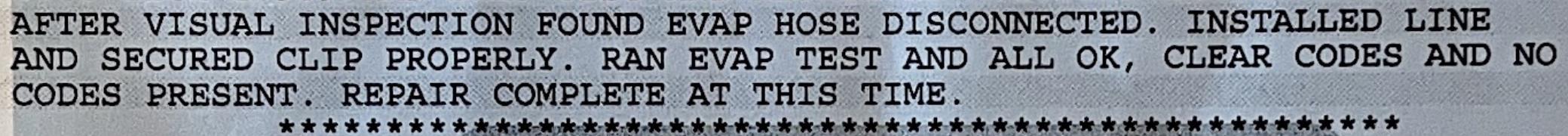

Just an update on this. Turns out the woosh noise was not normal. An exhaust hose had disconnected and that was the sound I was hearing. After it was repaired, the noise completely stopped. So, if you are hearing something similar, bring the rig in to a dealer! FYI - the check engine light will not always illuminate with this issue.

I didn’t see the hose itself when they serviced it. But, here is the explanation on the work they did, if it helps. After they reconnected the hose, the car is pretty silent upon turbo engagement.
Mine was quiet when I first picked it up as well. But it got louder after 300 miles or so.
Ford Bronco Woosh or air noise when accelerating? 8ECF9DA8-598D-49A2-9013-088ECDB4F9A4
