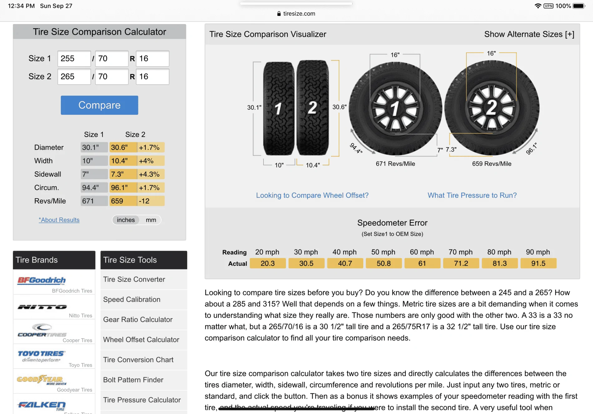

Here is a comparison between the base bronco stock tire size vs. 265/70/16. As you can see, the sidewall increase is only 4.3%. I think you will be perfectly fine. I have Duratracs on my Jeep (they are great, and is a great snow tire as well, but there is a good amount of road noise) but I think they do not fit your ”use case” as well as the Continentals.

Here is a comparisOn..
Wow! That's a cool tool. I'm going to have to use that thank you.
