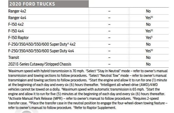

I had a great quesiton come up today that is worthy of a thread...
Can you pull the Bronco with all 4 wheels flat on the ground...i.i behind a motor home...
There is no official word that I could find but the Truck section carries the Ranger and it has similar drive train sans the 2.7 V6..
I will update this thread on post 1 as information comes available..

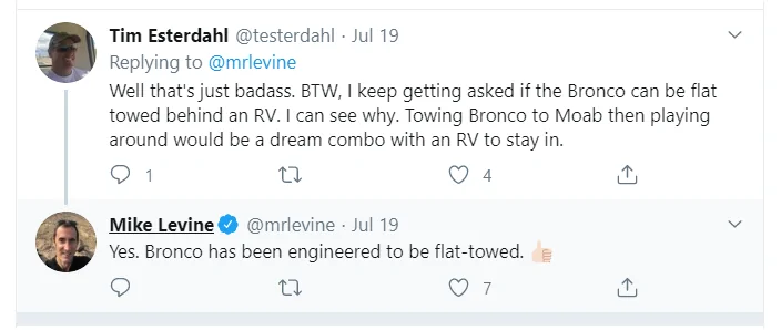

update
@Squatch thank you for the information
Here is what I was led to and by a very reliable Ford insider * Mike Levine *
Ford Bronco Yes, 4 down or flat towing the Bronco is possible 1595650674574
