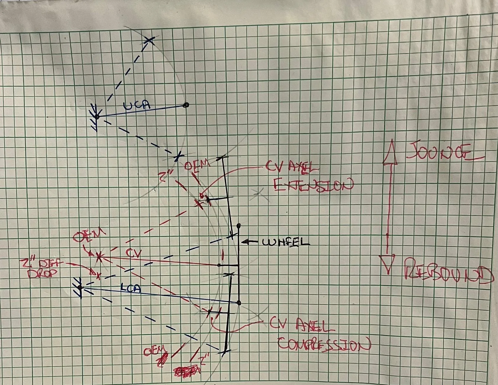

agreed. Some additional thoughts.
the front suspension has a kinematic response similar to a 4 bar mechanical linkage; ie, frame, LCA, wheel knuckle, and UCA. For the OEM double wishbone configuration, both the UCA and LCA have complete freedom of rotation at the frame pivot joints. This is not the case at the knuckle joints. It is possible that the knuckle joint locations bind under severe wheel articulation. However I don’t think this occurs under oem configuration.
The wheel motion or articulation is controlled by the LCA angular rotation which is completely defined by the shock travel. As long as no joint binding occurs. The UCA controls the orientation of the wheel knuckle during shock travel (LCA rotation). The attached figure shows the kinematic motion of this 4 bar linkage in the camber plane only. hence the UCA tries to maintain the design wheel alignment during shock travel (both camber and caster).
The quest for improved ground clearance usually includes lifting suspension with increased tire diameter. For oem LCA, suspension lift necessarily results in an increased downward rotation of the LCA (increased angle wrt horizontal plane). This also increases positive camber. The oem LCA can be moved outwards to readjust camber. Likewise front and back LCA pivots can be adjusted to dial in caster. At some level of lift, the ride height camber/caster can not be adjusted by LCA alone. Hence UCA knuckle joint needs to be moved inward to allow for oem designed wheel alignment. I think the oem LCA/UCA combination allow for up to a 2” lift above SAS and still maintain alignment.

@87-Z28 way better explained than I could have said. I was just going to write the need for UCA’s is for alignment purposes above 2”ish of lift. I did not buy the ICA’s even tho the gentleman was asking 1/2 price for them. I did buy the Eibach coilovers from him for a pretty decent deal brand new in the box.
