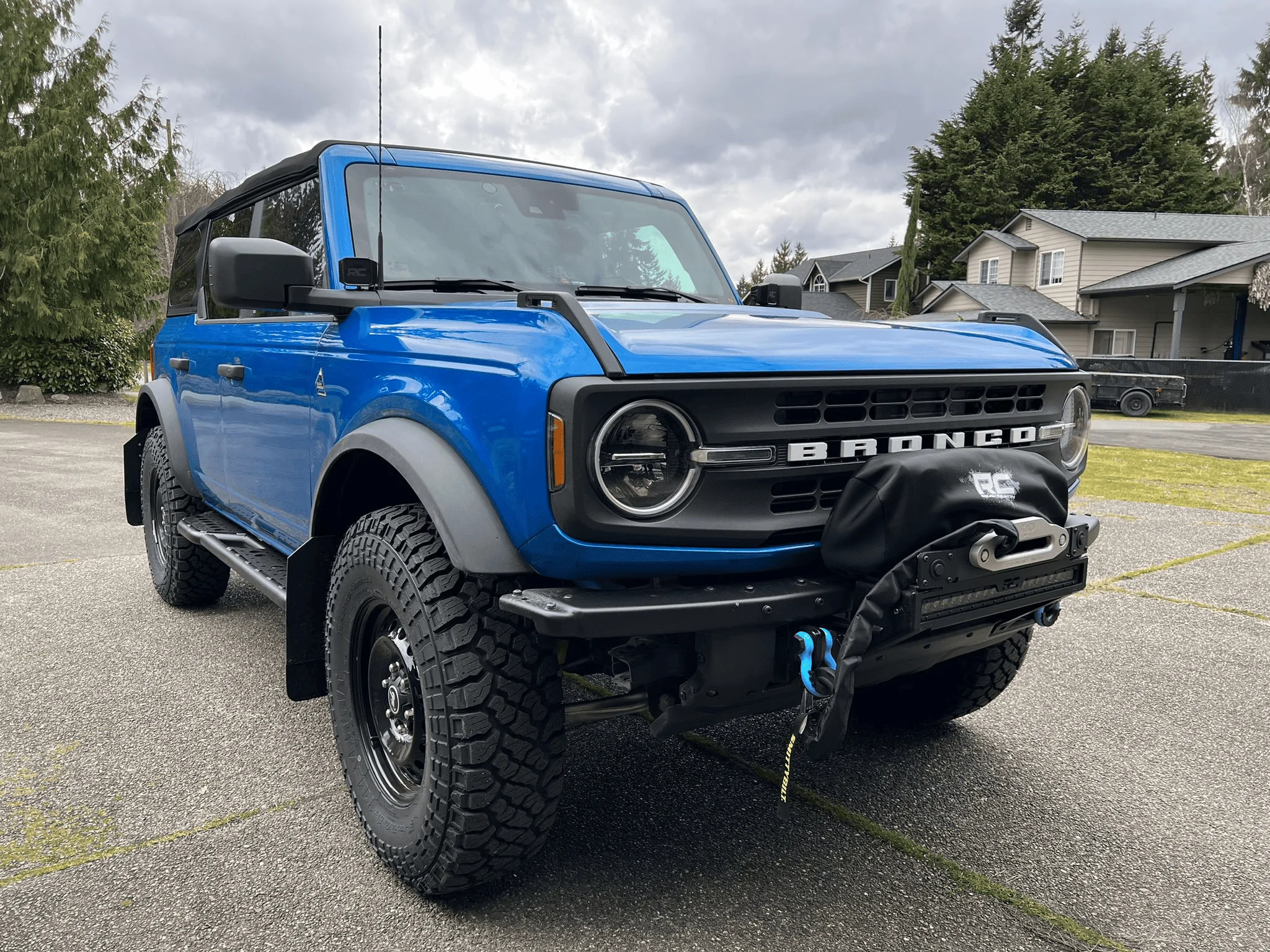

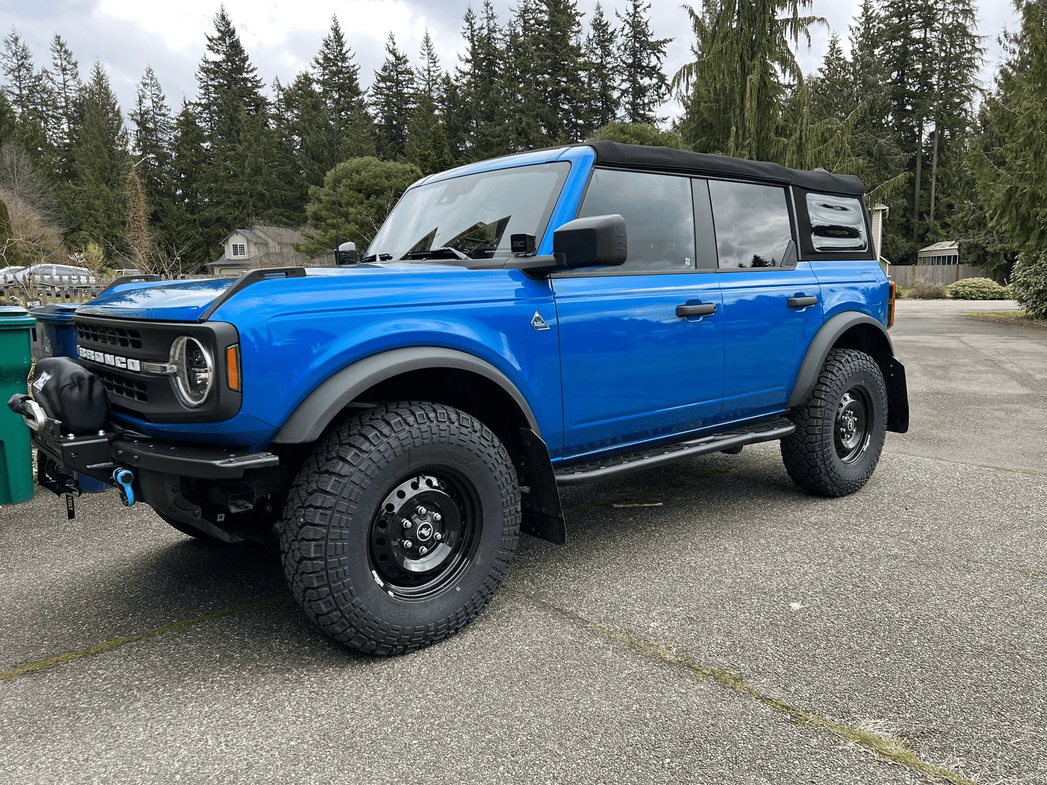

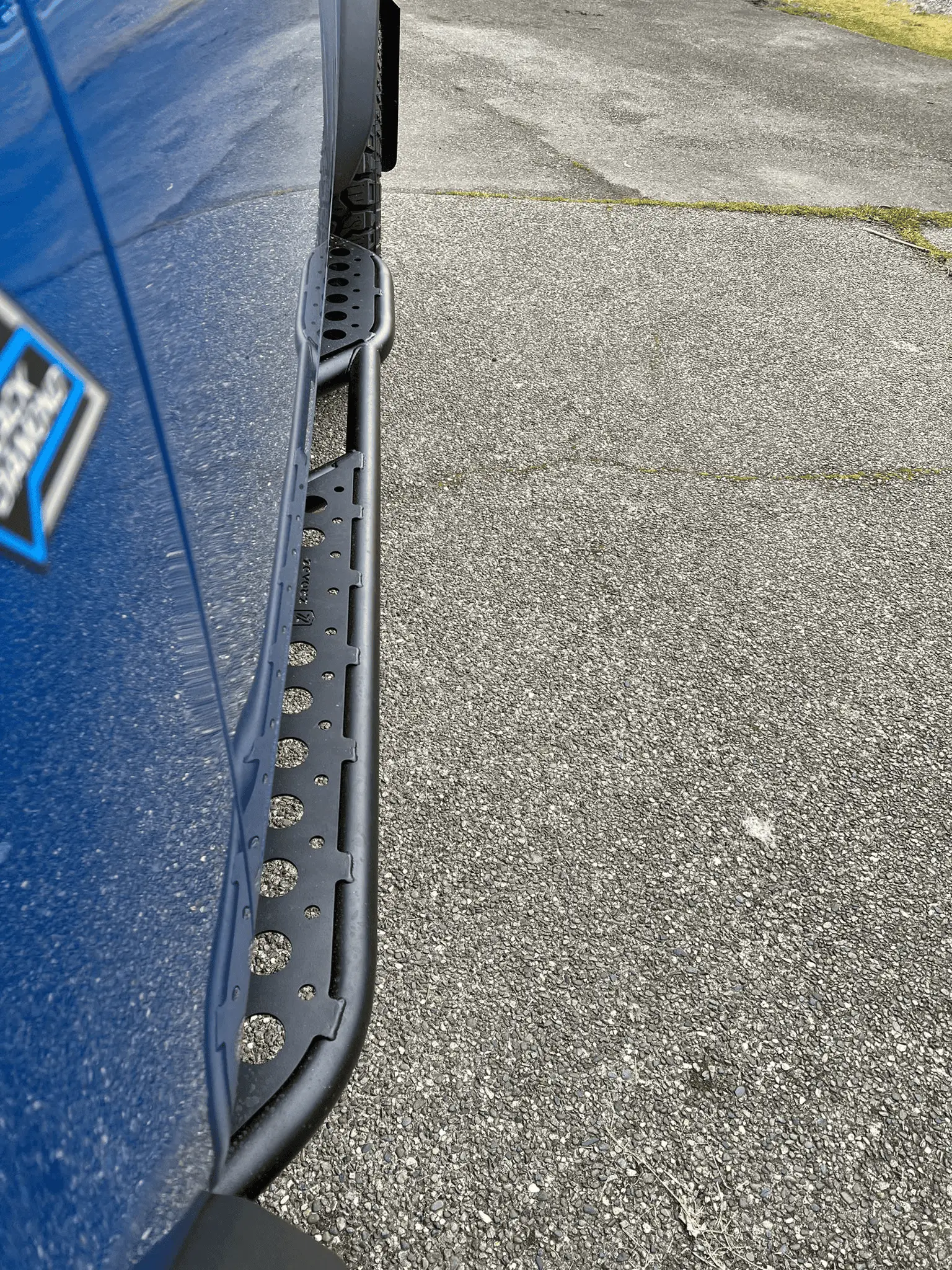

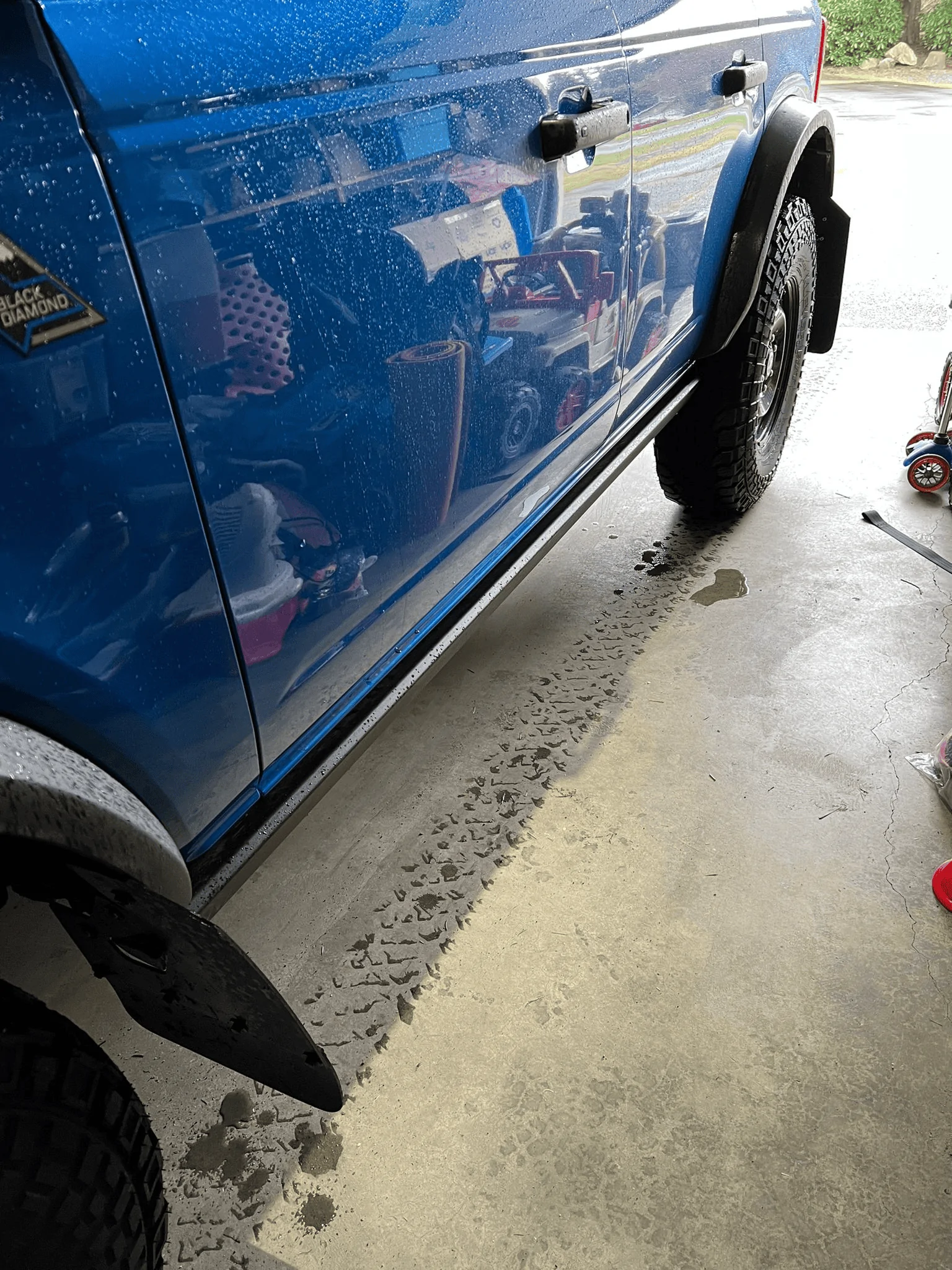

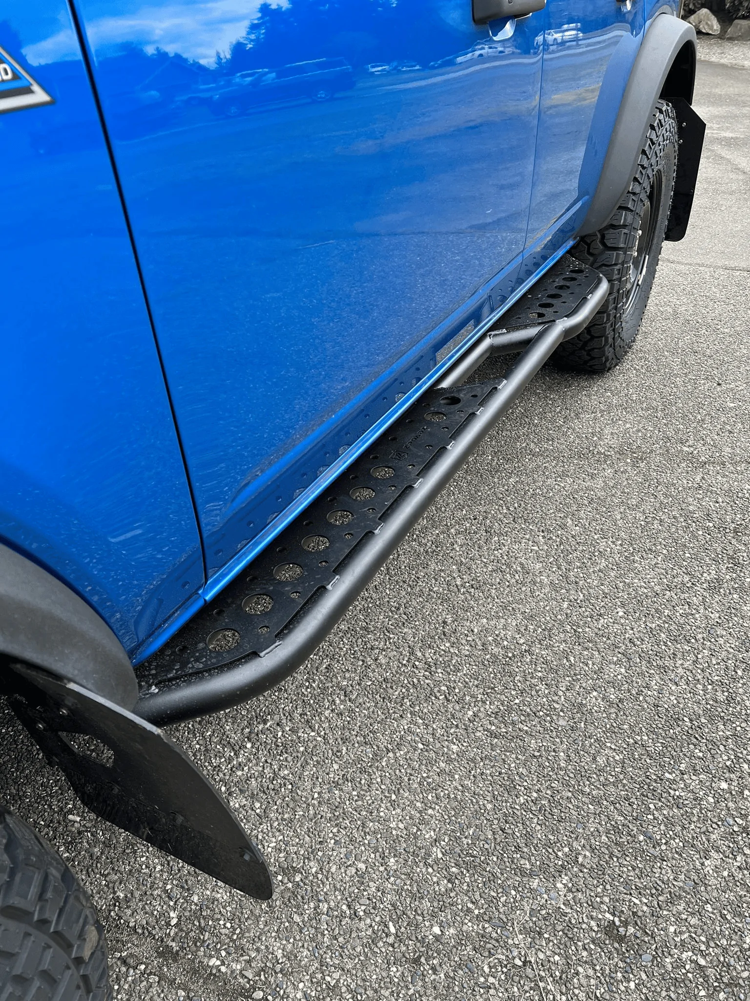

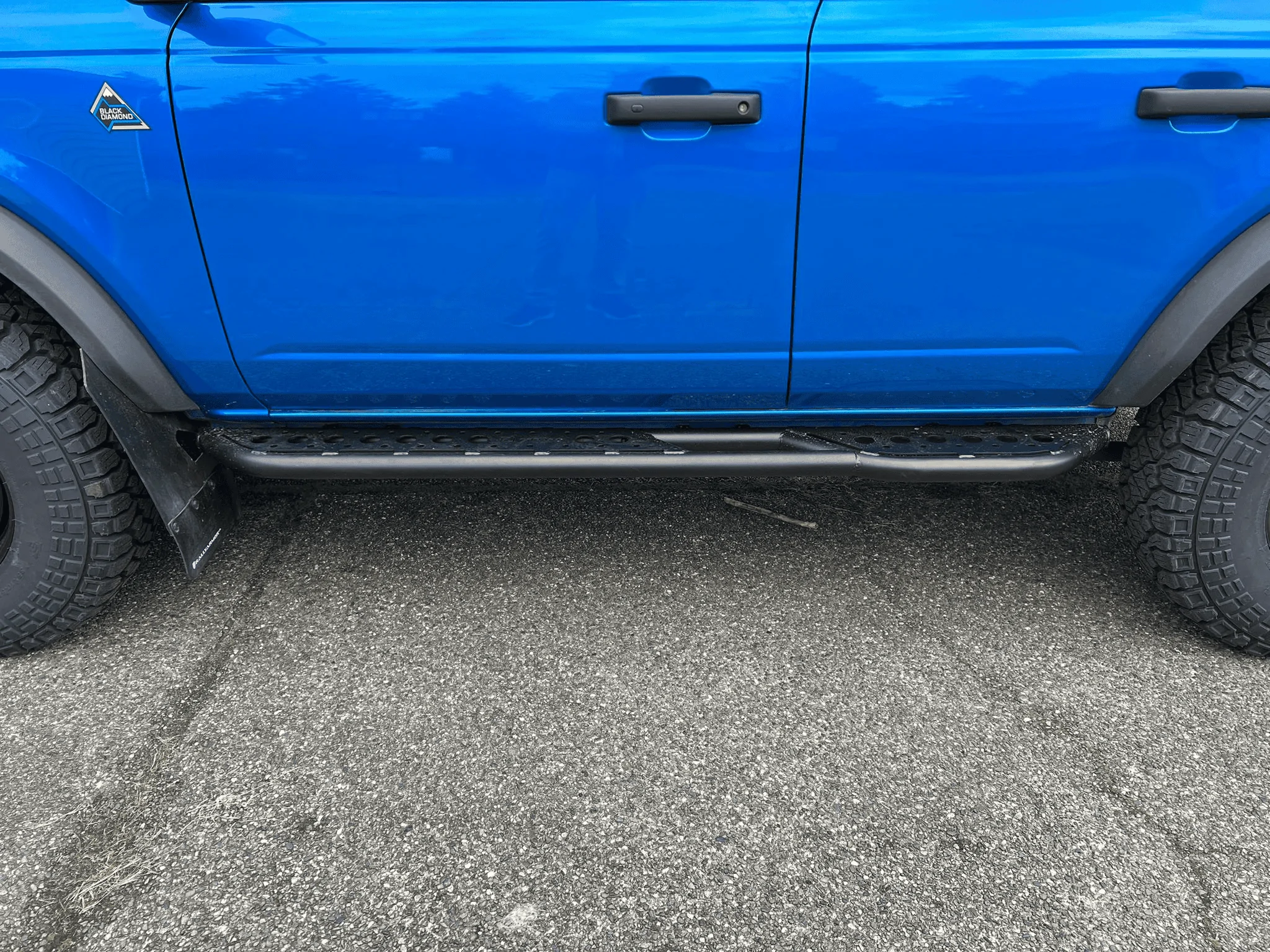

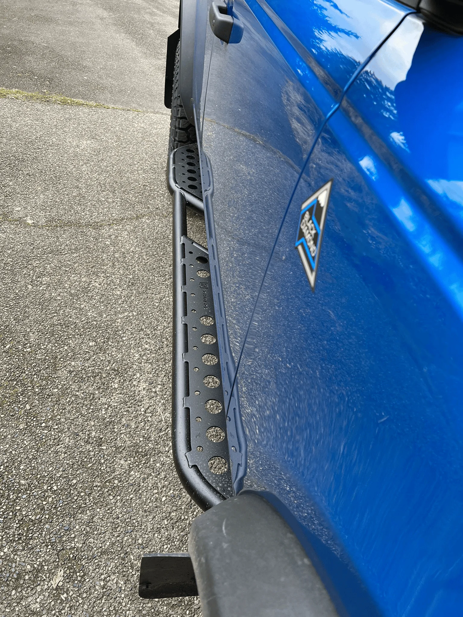

Swapped out the OEM Rock Rails that came on my Black Diamond for some ZROADZ Rock Slider Side Steps.
Packaging was great, they arrived in excellent shape in a sturdy box, wrapped and also foamed for protection, A+ package job!
The installation was very straightforward.
Was able to do it solo taking my time.
Taking off the OEM rails was an easy 9 bolt affair.
Installing the first slider was smooth as soft butter.
Installing the second one was a bit more challenging...unfortunately my second slider was slightly off at the pinch weld studs and the front bracket was off at the main hole too. I opted to proceed with install vs waiting for a replacement and reached out to ZROADZ which took care of me. I drilled my pinch welds to enlarge them a bit (3-5mm), then filed away the front bracket to also enlarge it (~4mm). Painted the affected areas and then bolted it up finally.
Love the looks and functionality, my kiddos can use them as steps. They will prevent door dings and protect on off-road excursions.

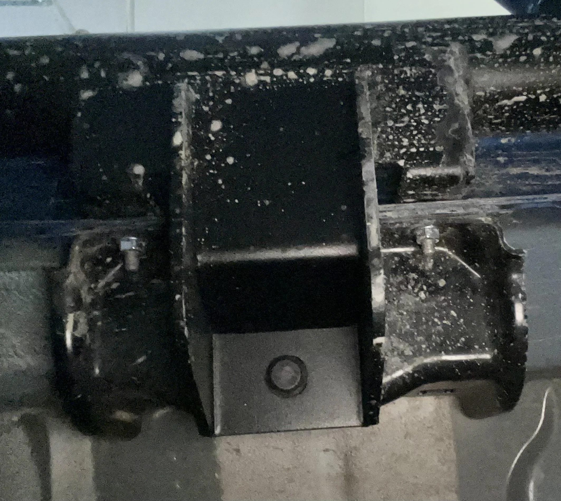

Do they attach at all to the frame or only body/pinch welds?

They attach to existing brackets which are not attached to the frame.

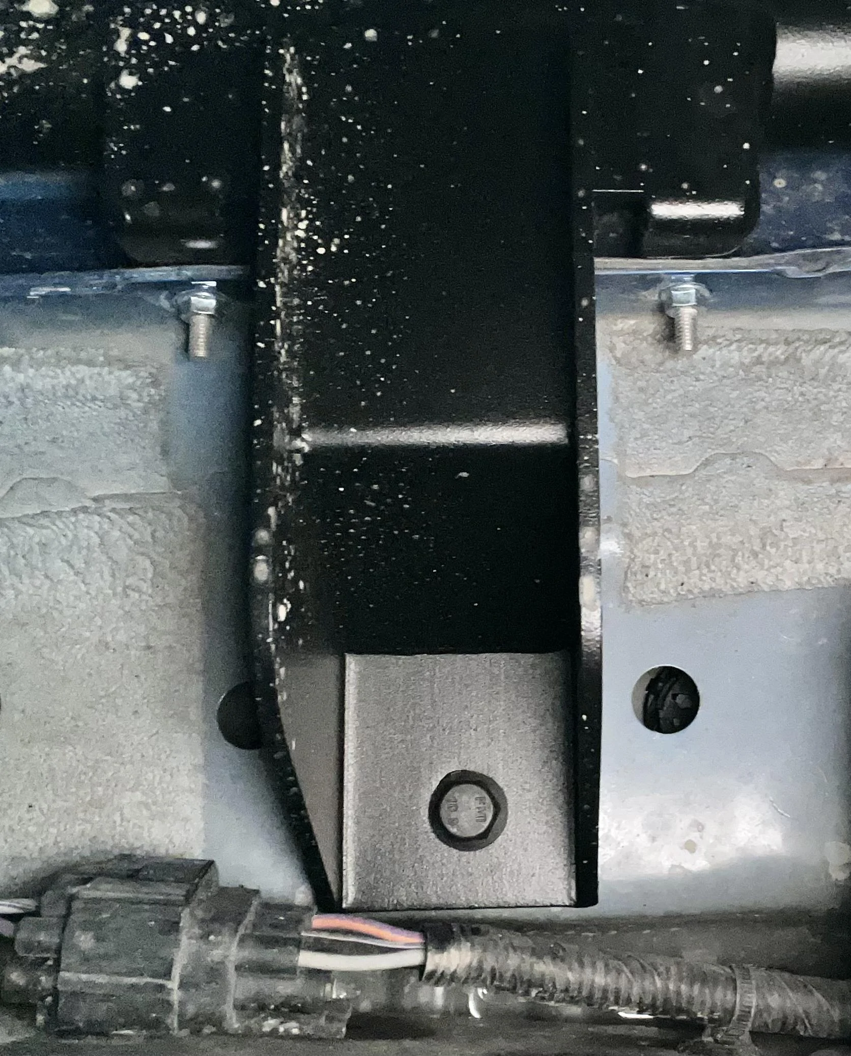

Body/pinch welds.
Seems really beefy.
I don’t do any extreme rock crawling so for the occasional outing these are perfect!
Front bracket:

Mid/Rear bracket:

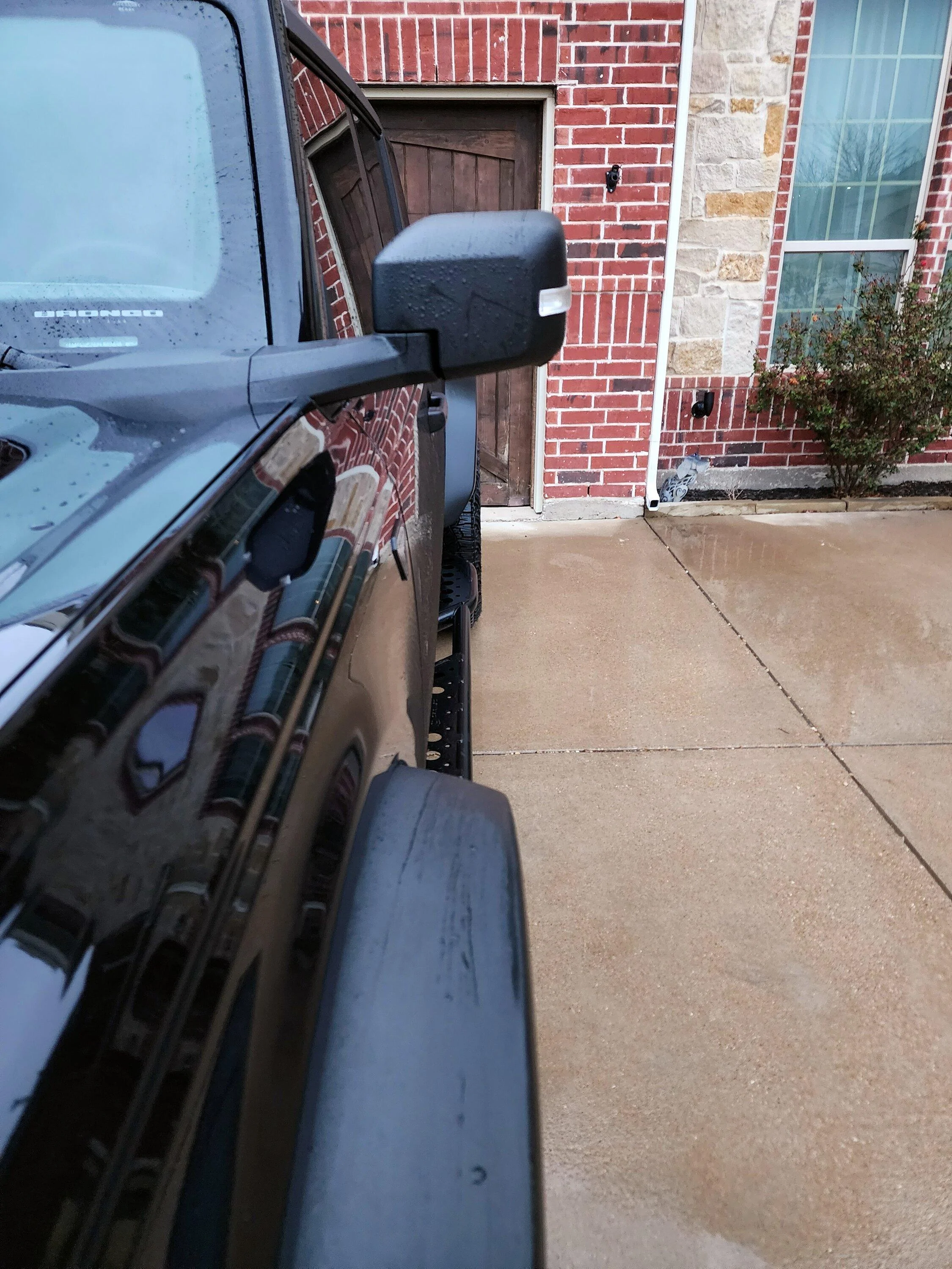

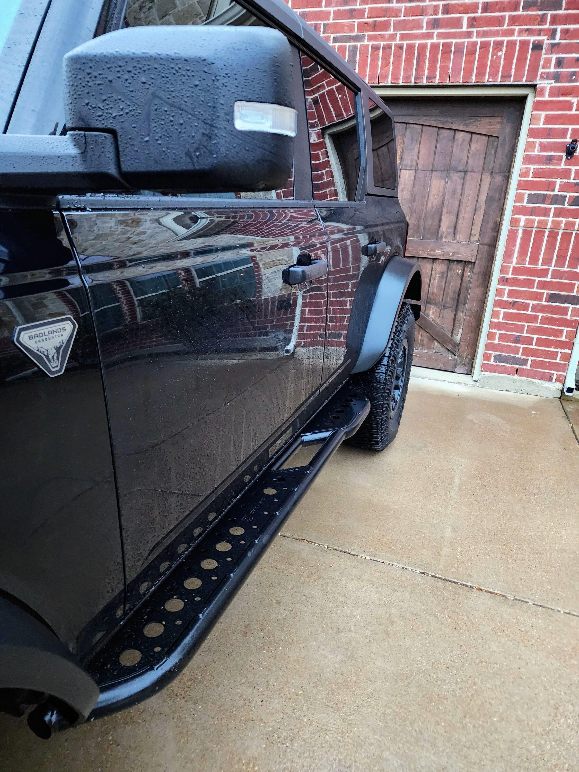

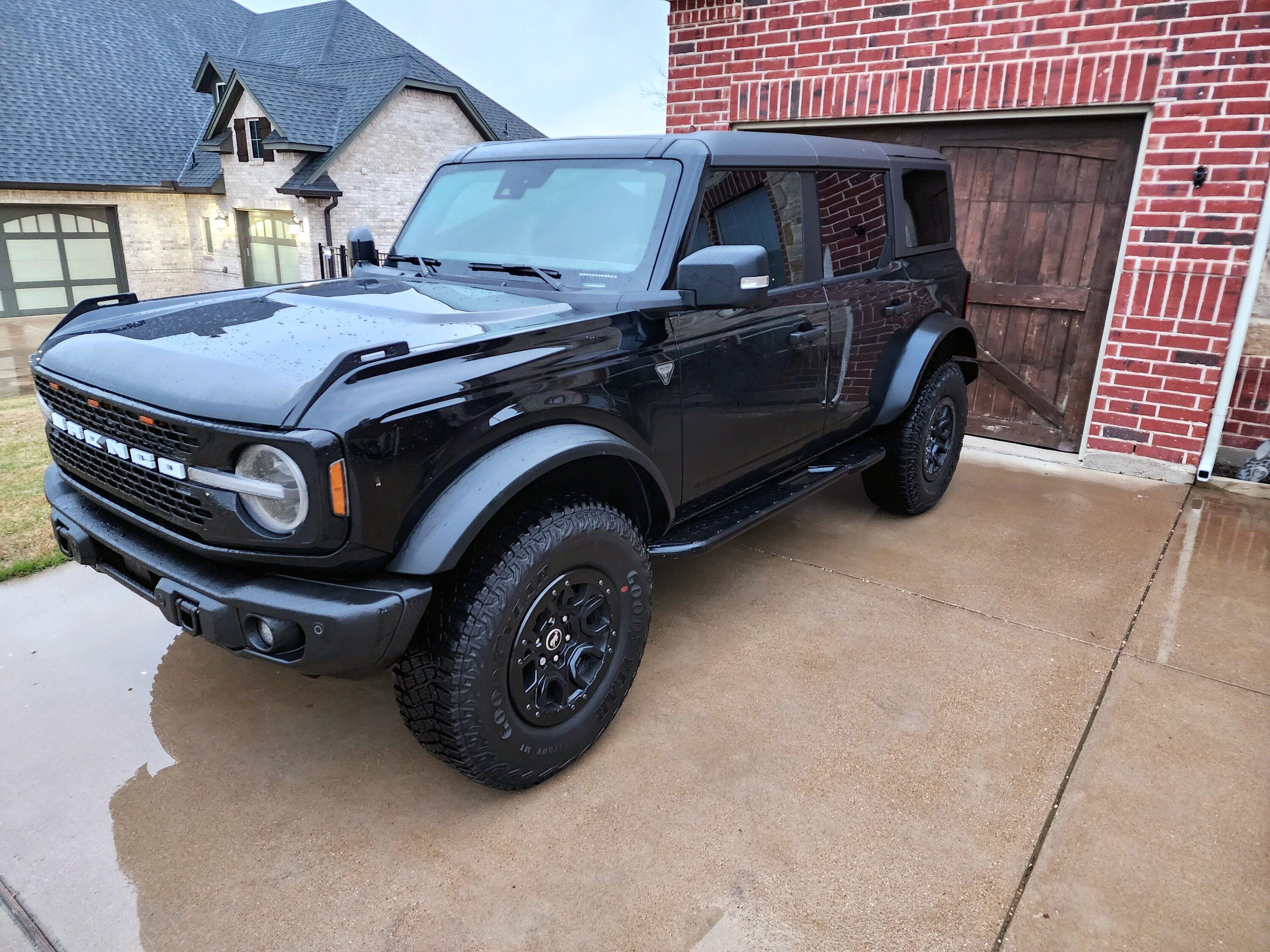

I was looking at these and also the DV8 sliders when mine comes as they look pretty identical. What made you go with the ones you bought? Look good!! Thanks for posting.
