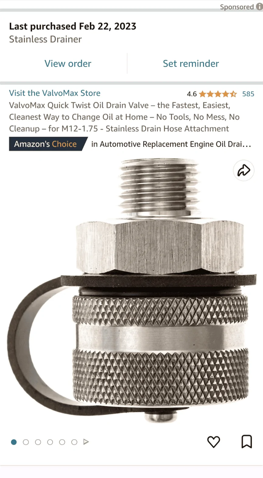

Hi there, looking for confirmation that the correct thread size for the plug is M12x1.75. I typically put ValvoMax plugs in to make life easier and their site is saying the thread is M14x1.5....

Fumoto is saying it is the M12 - 1.75 . Summit Racing, Advance, and Autozone have replacement plugs that also state the same size.
If you look in the ValvoMax reviews, someone says that they have the wrong size listed for their application so it is possible they are wrong in this case too. Have not changed my oil yet so can't confirm.

I have a 2022MY with the 2.3 and this is what I fitted to mine a few months ago.
Ford Bronco 2.3 drain plug size? Screenshot_20230613-220341
Much appreciated! I ended up buying both sizes and will return the M14 after I change the oil in a few weeks.
