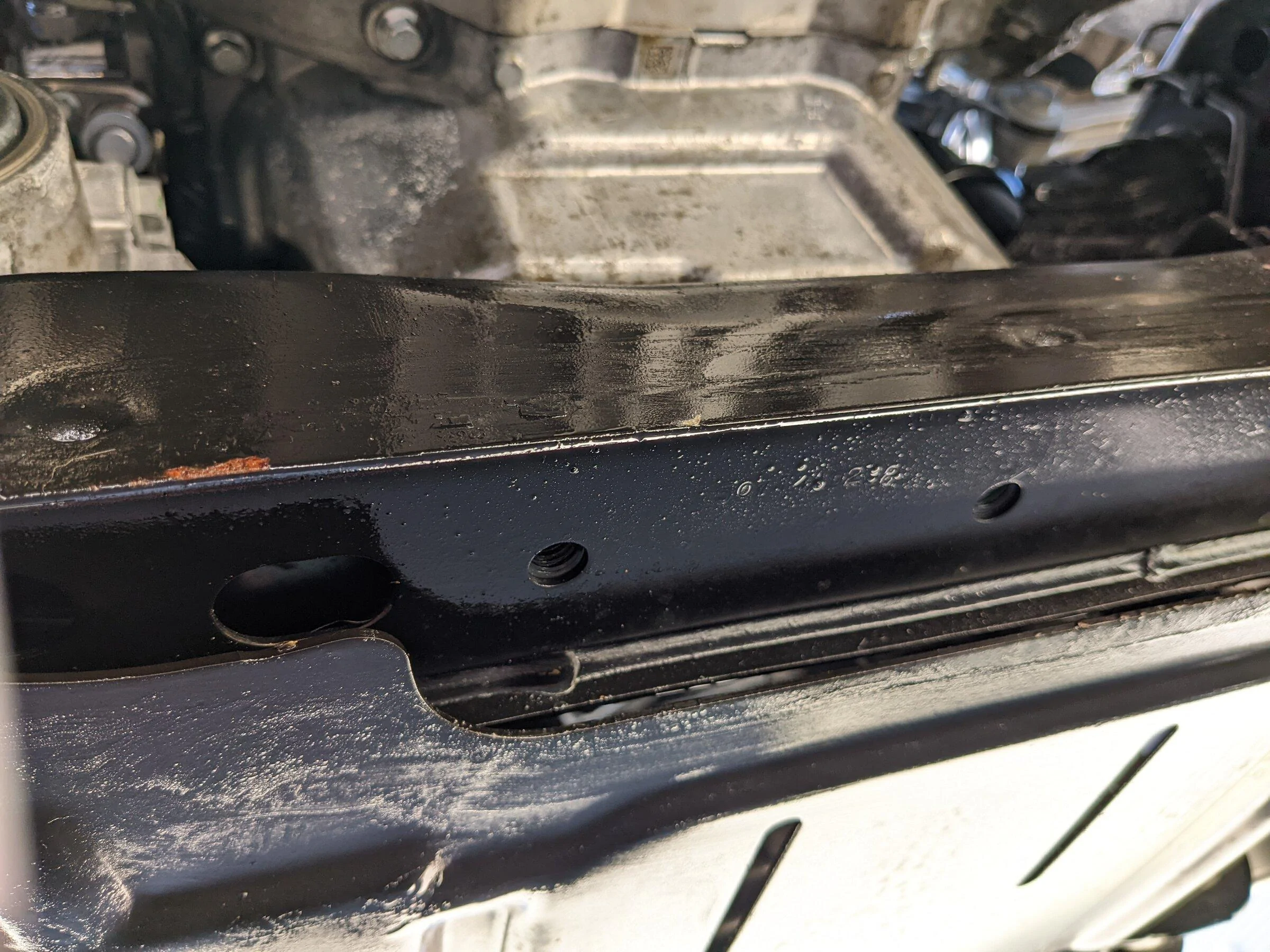

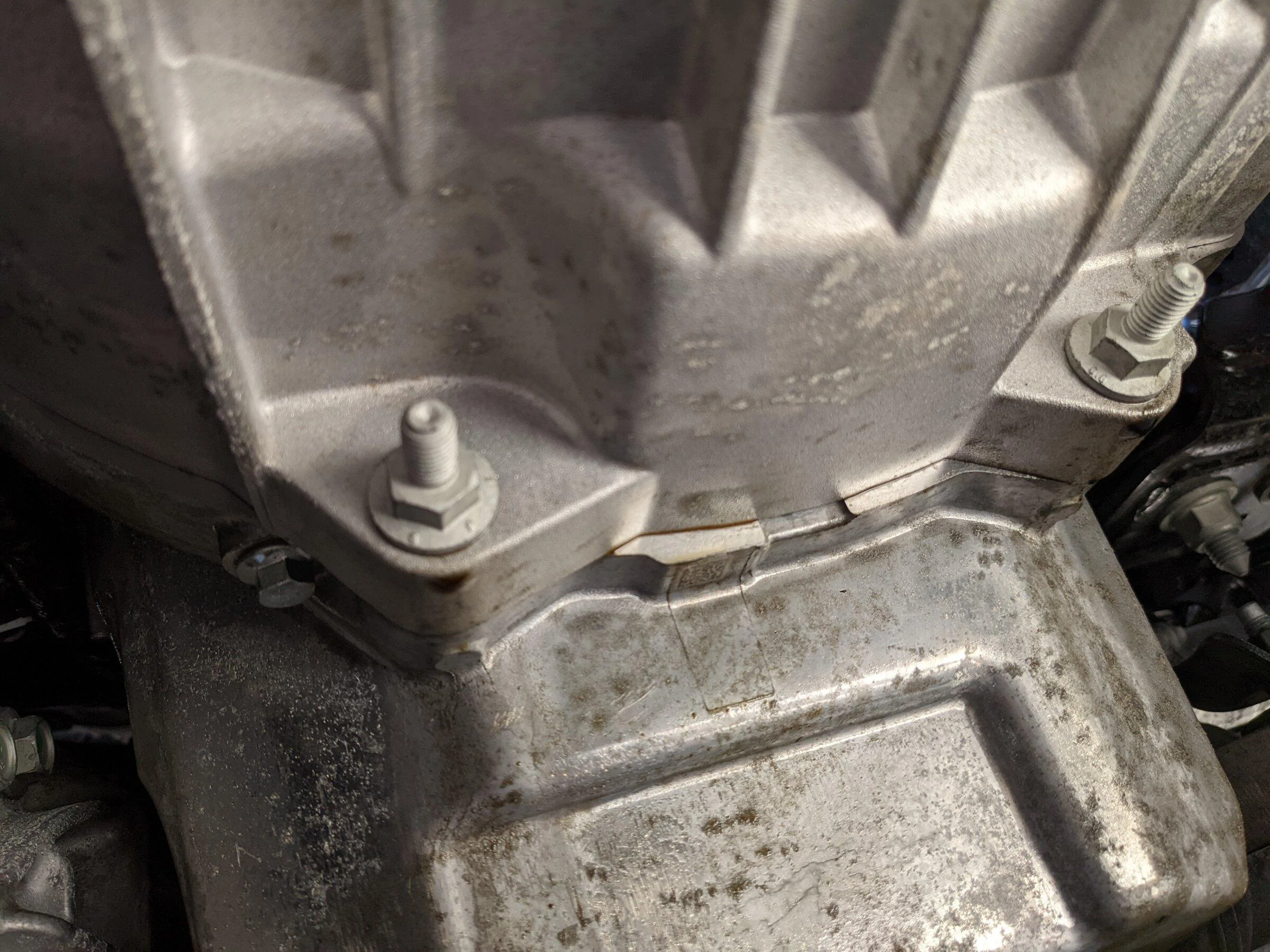

I went out this morning and came back to the house to find a significant oil puddle on the ground where my Bronco had been parked the night before. I got underneath and there's oil everywhere, except for oil filter which is dry (was hoping it was loose, but alas). Opened the hood, found spots of oil in multiple places. Checked oil level and it is right at bare minimum level. After a couple frustrating phone calls with Ford, getting it towed to the dealership here in the next 15 mins. I'll keep you updated with what I find out.

Might be the rear main seal if it's all coming from that mating joint between the motor and trans, unless you can trace it up higher on the block.

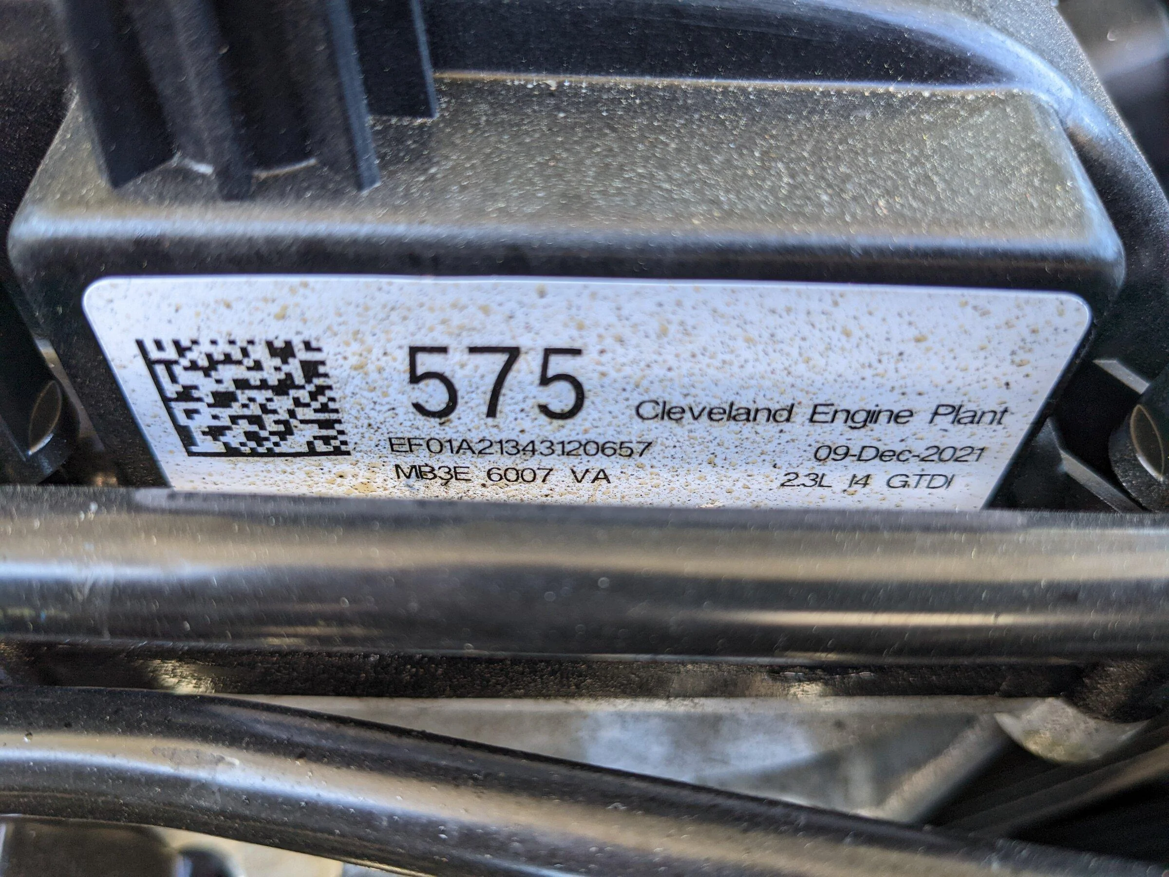

There does seem to be oil coming from there for sure. Oddly though, it's like oil has sprayed out from somewhere too. Here's a pic I took from under the hood of the engine info sticker and you can see some of the spray on the sticker itself.
