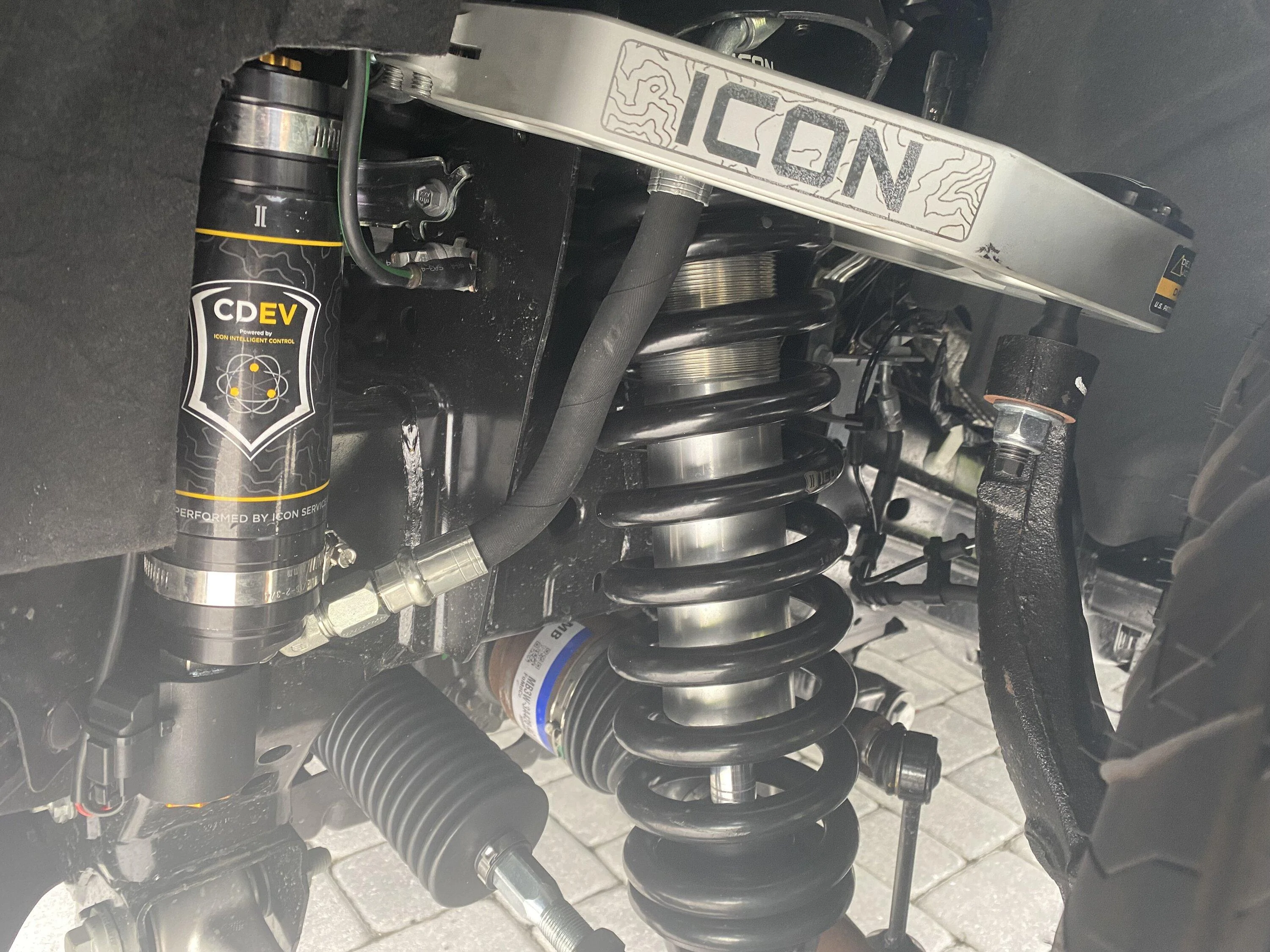

Suspension:
Icon Stage 8 Suspension System
Icon CDEV (Electronic Valve) 2.5" Coil-Overs
Icon IIC Computer - Controls Shock Dampening Settings via Icon APP on IPhone
- Adjustable Settings for Normal Driving Mode, Off Road and Towing.
Icon Billet Upper Control Arms With Delta Joint
Icon Billet Rear Upper and Lower Links

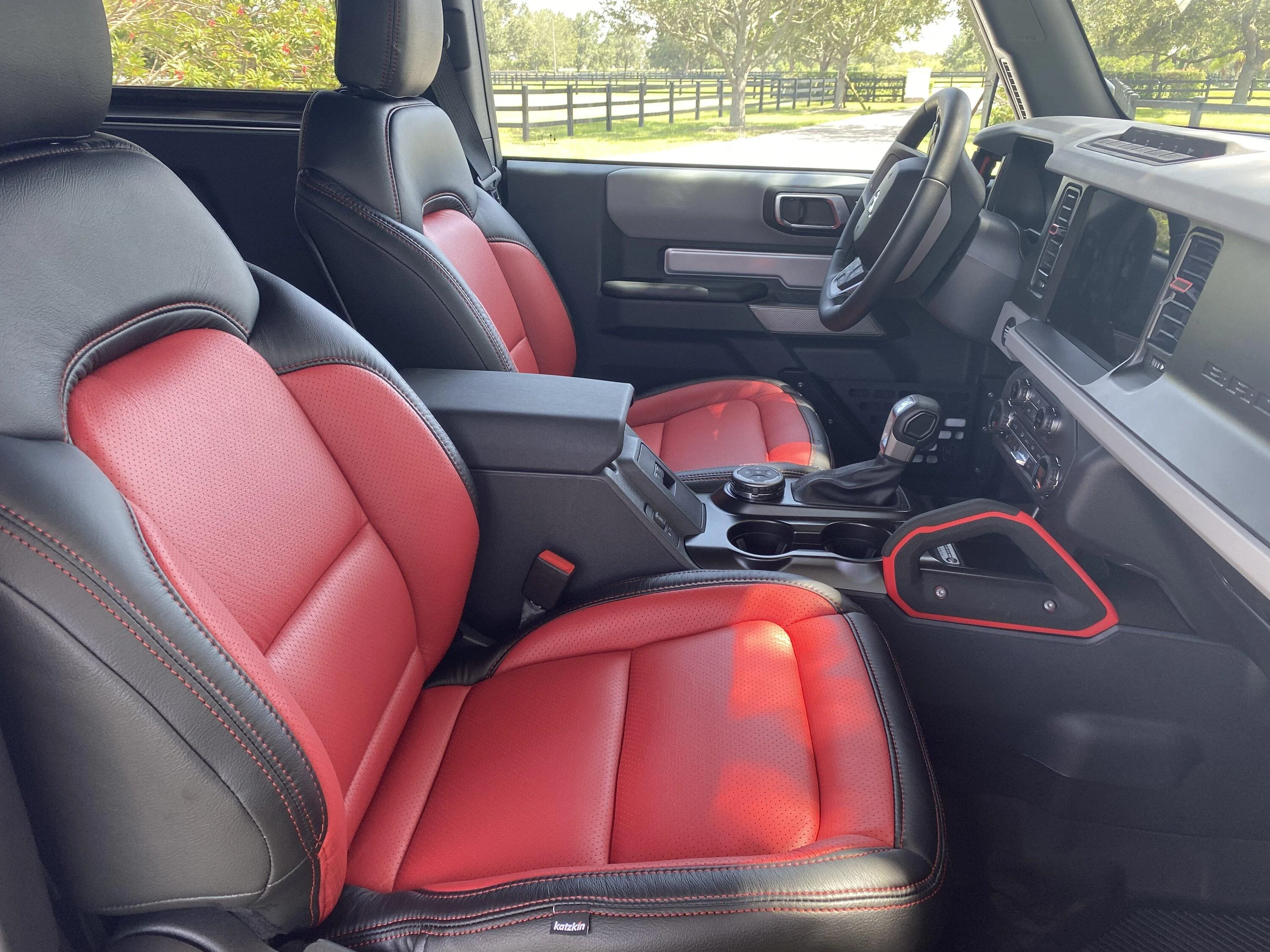

Katzkin Leather Seat Covers - Black with Red Perforated Inserts
- Matching Black Leather on Door Panels

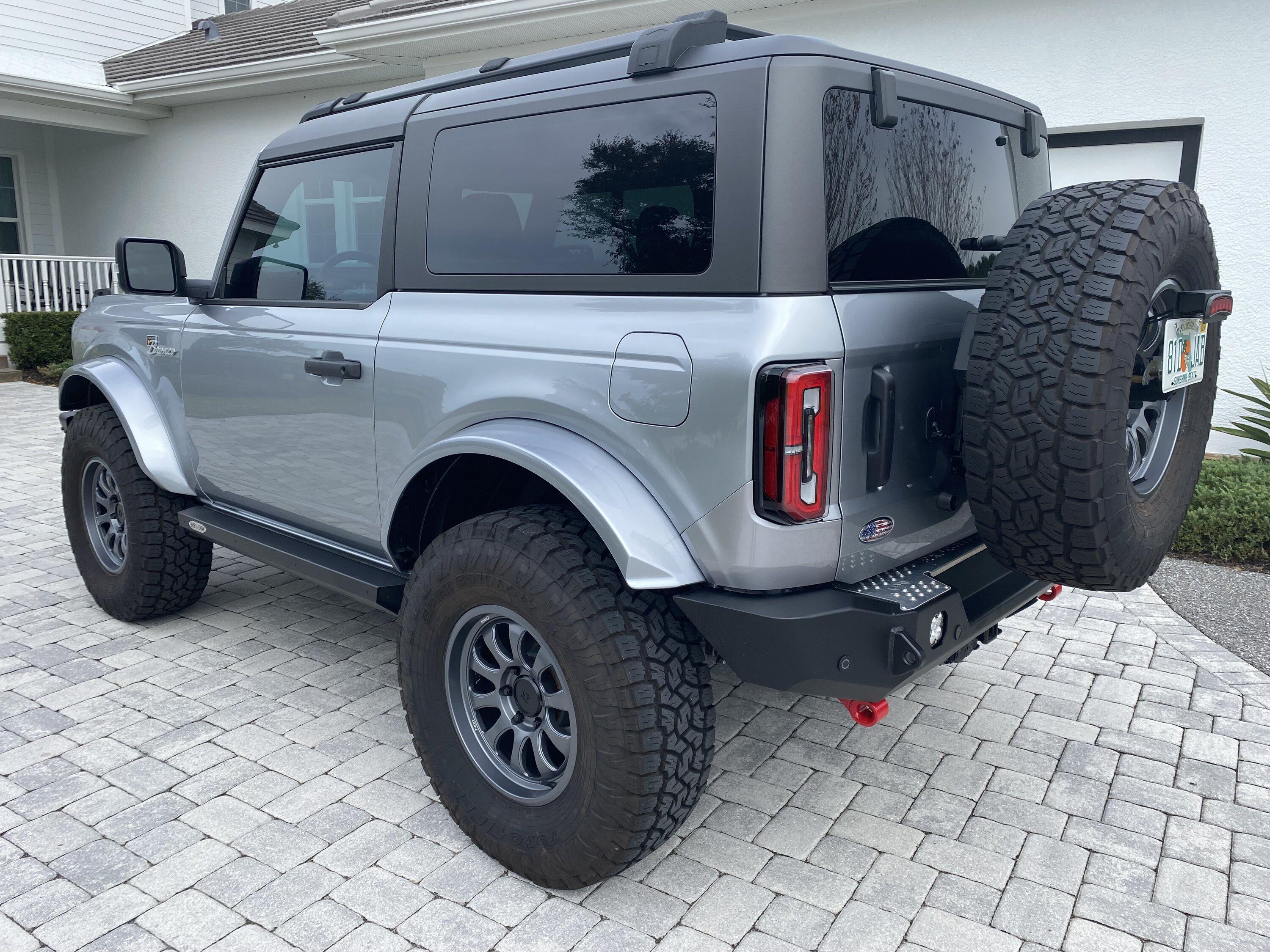

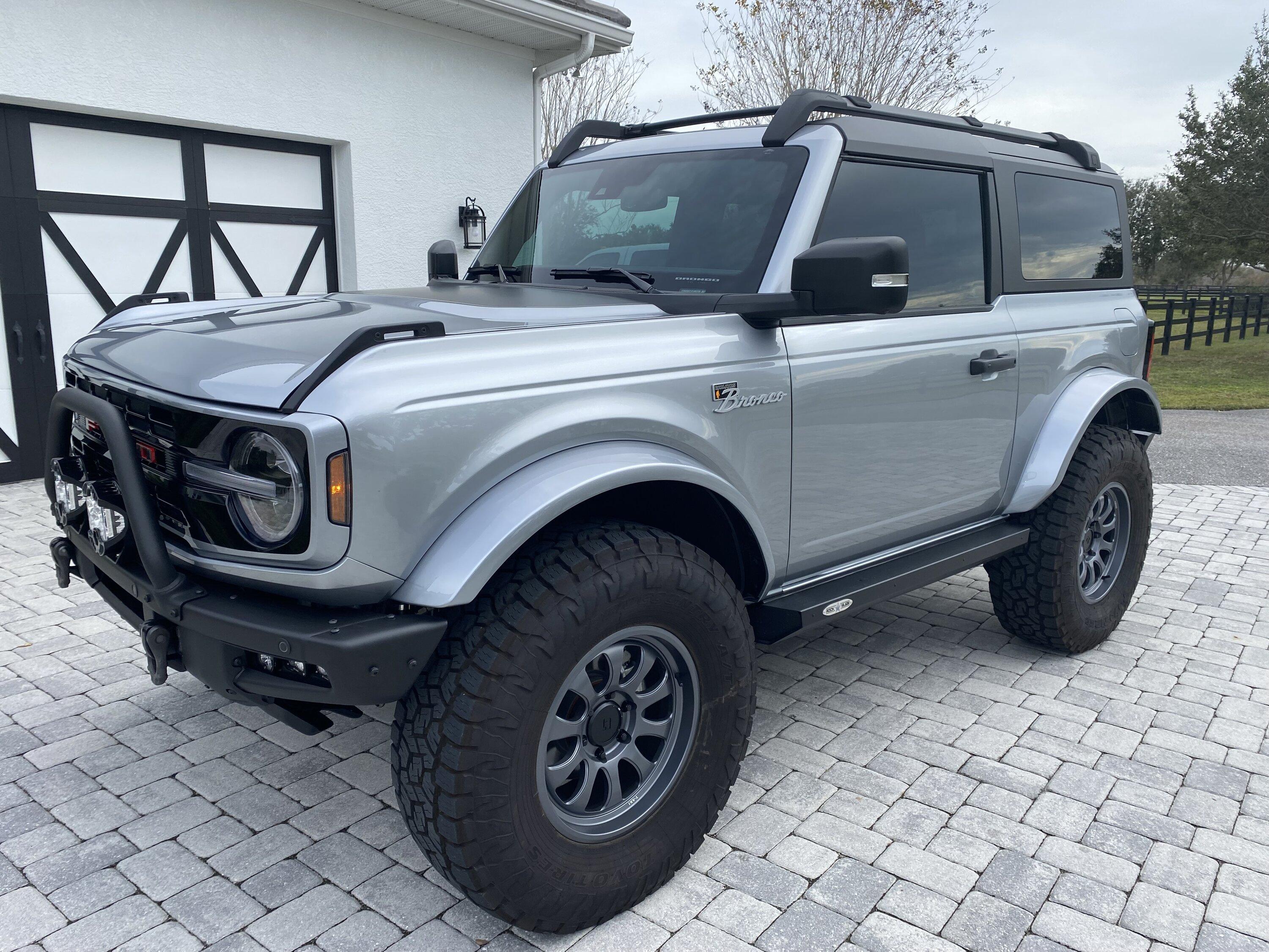

Here is what it looks like Finished. This build is complete.
Ford Bronco 2023 2-Door Iconic Silver Badlands Build IMG_1005
Ford Heritage Grill Painted Black with Iconic Silver Surround, Painted Sasquatch Flares, Baja Designs LP6s and Pro Fog lights
Ford Bronco 2023 2-Door Iconic Silver Badlands Build IMG_1004
Rockslide Engineering Sliders with Integrated Steps. Factory Roof Rack with Extra Cross Rail.
Ford Bronco 2023 2-Door Iconic Silver Badlands Build IMG_1006

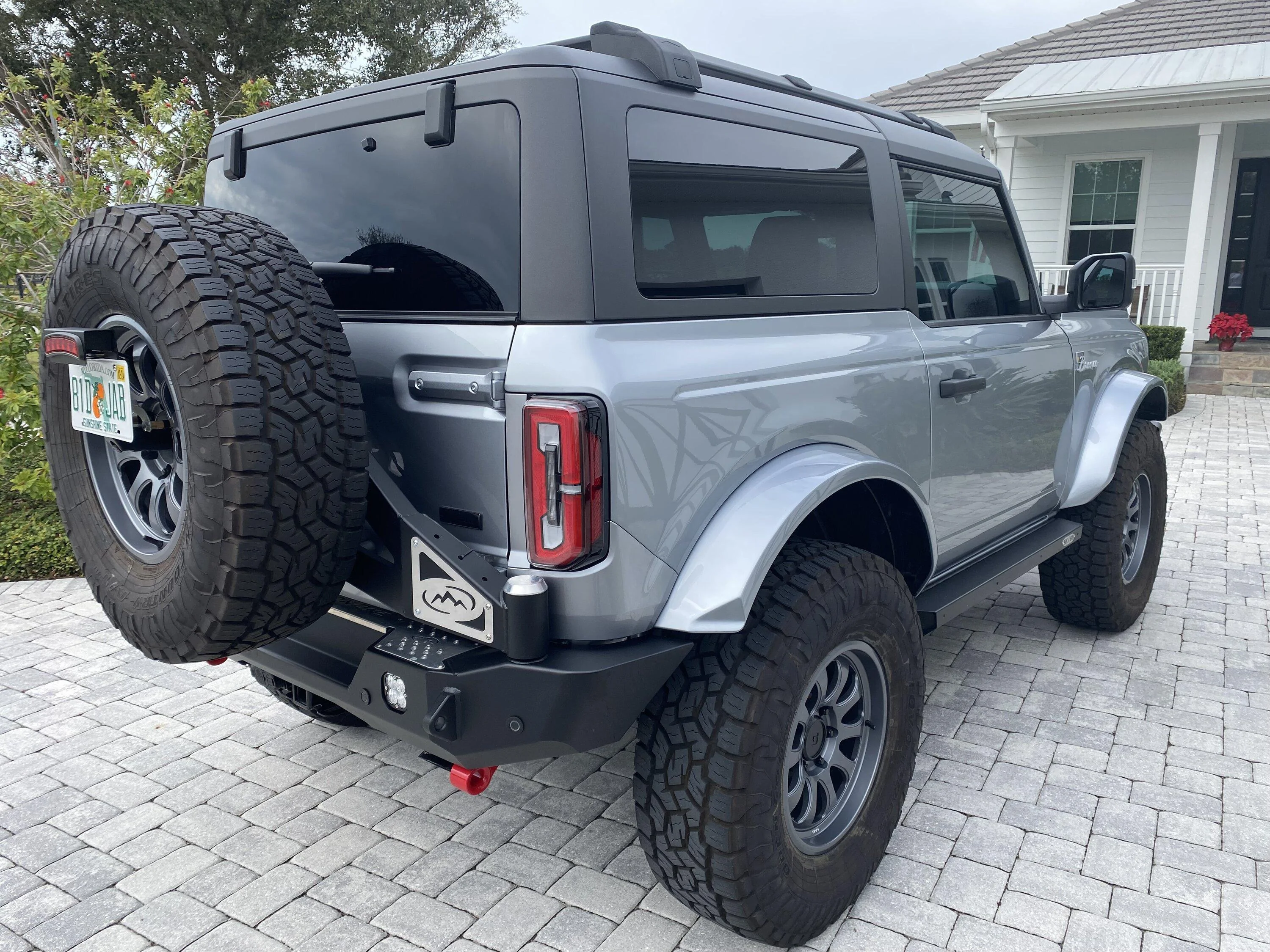

Expedition One Steel Rear Bumper with Tire Carrier. No Tire/Wheel Weight On Tailgate.
Ford Bronco 2023 2-Door Iconic Silver Badlands Build IMG_1007

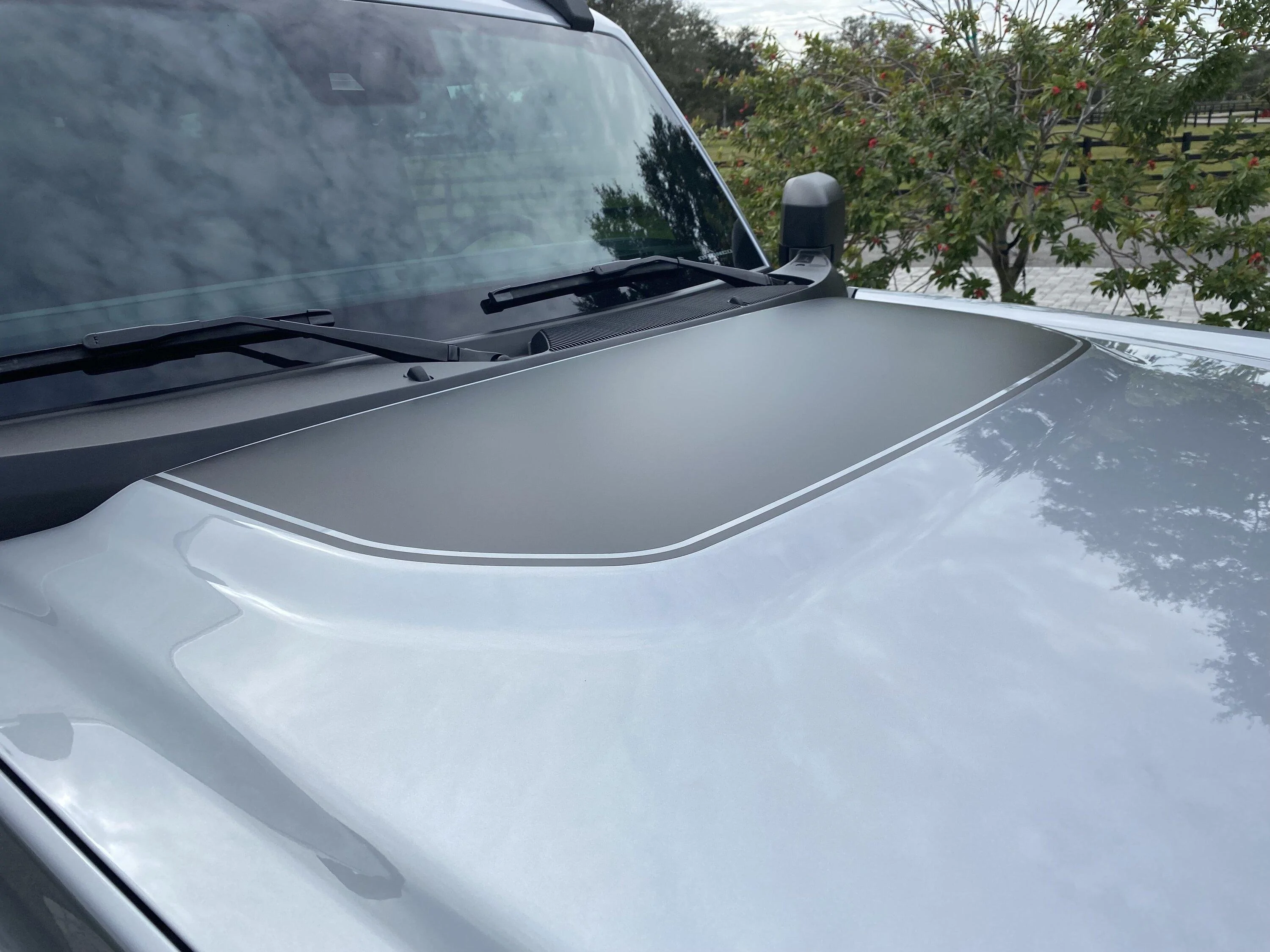

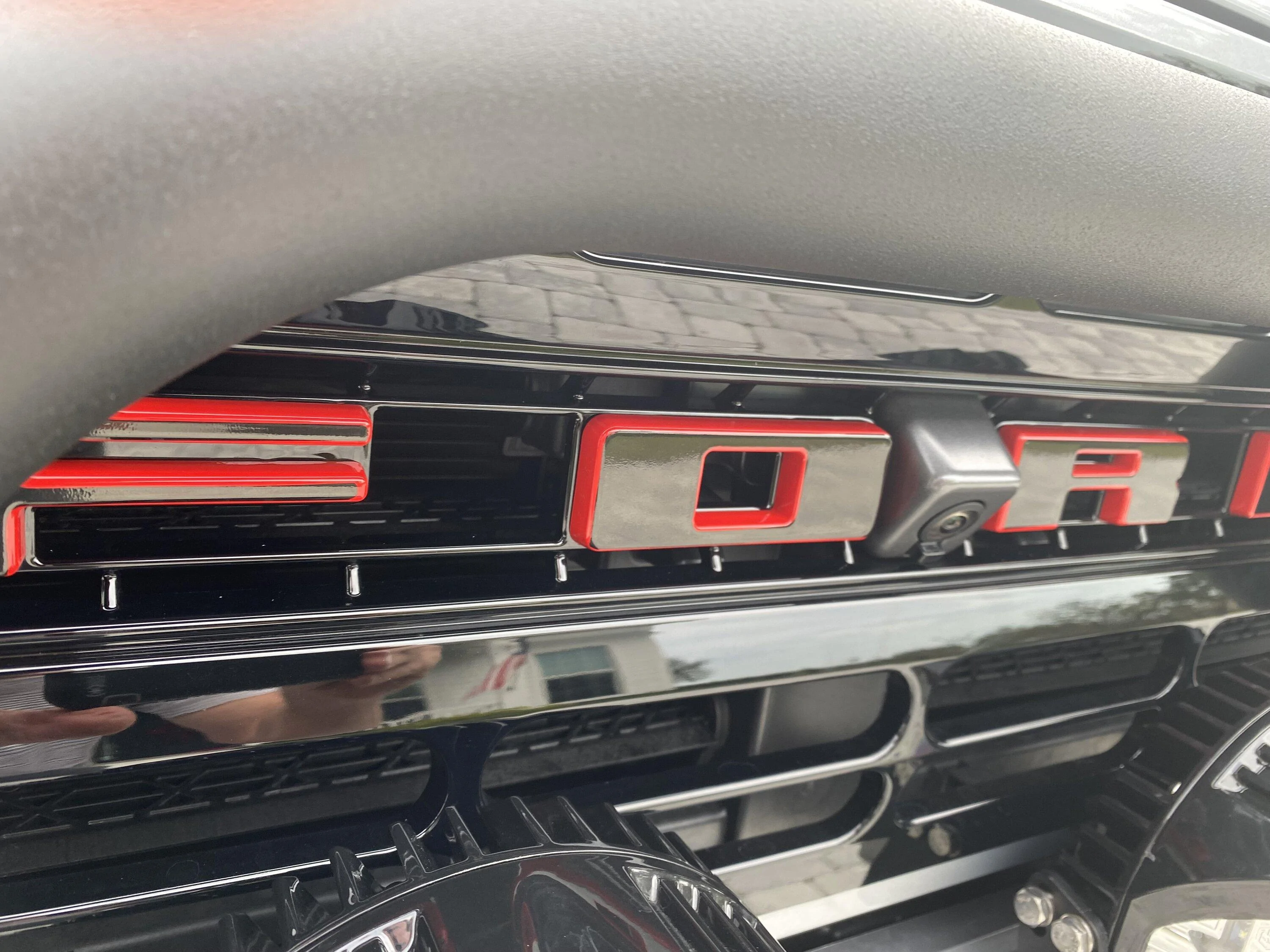

Hood Decal and Heritage Grill Letters - Black on Red Letters
Ford Bronco 2023 2-Door Iconic Silver Badlands Build IMG_1010

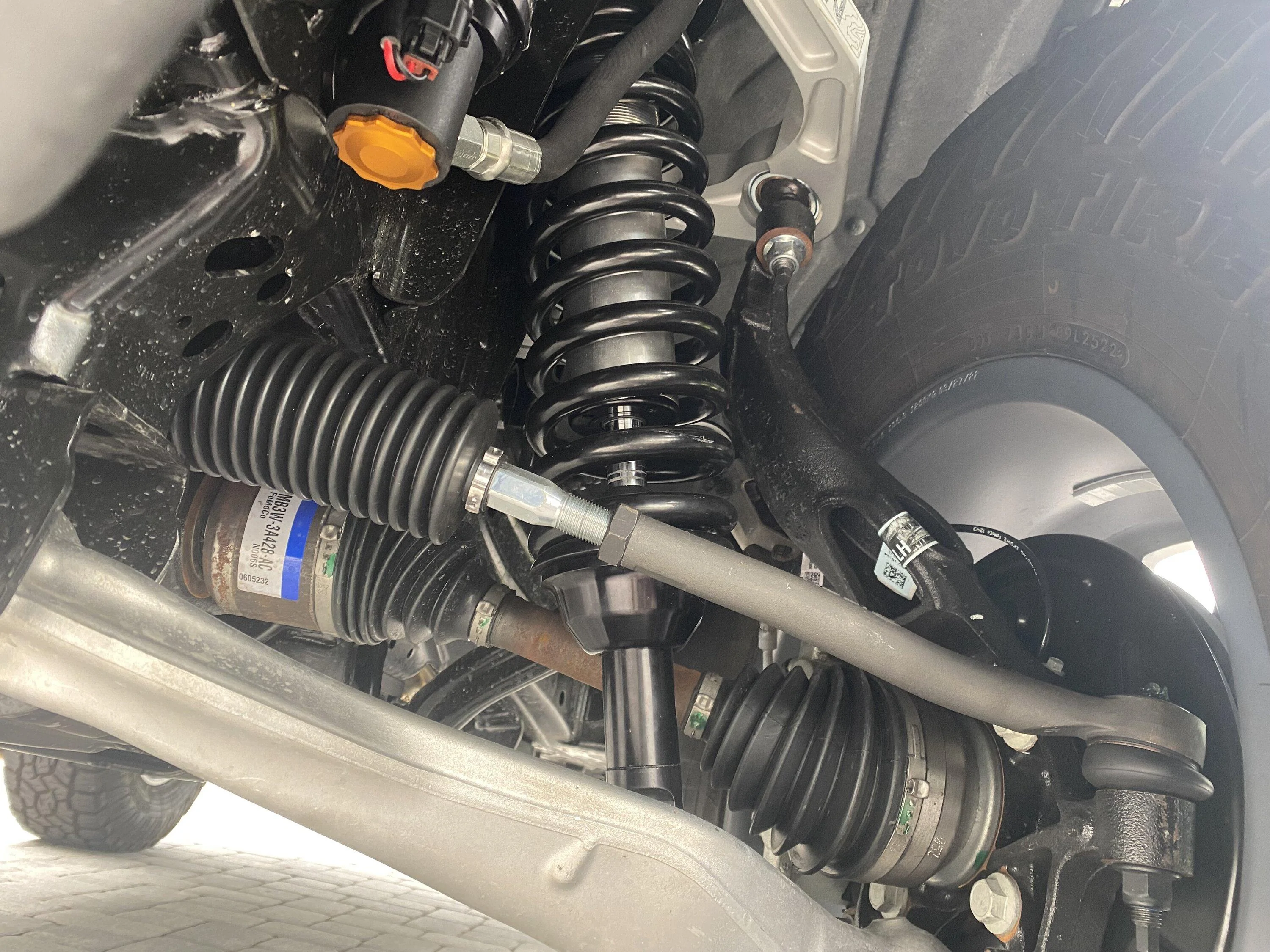

Icon Stage 8 Suspension With HD Forged Tie Rods. Plenty of Room Between Tire and Upper Control Arm.

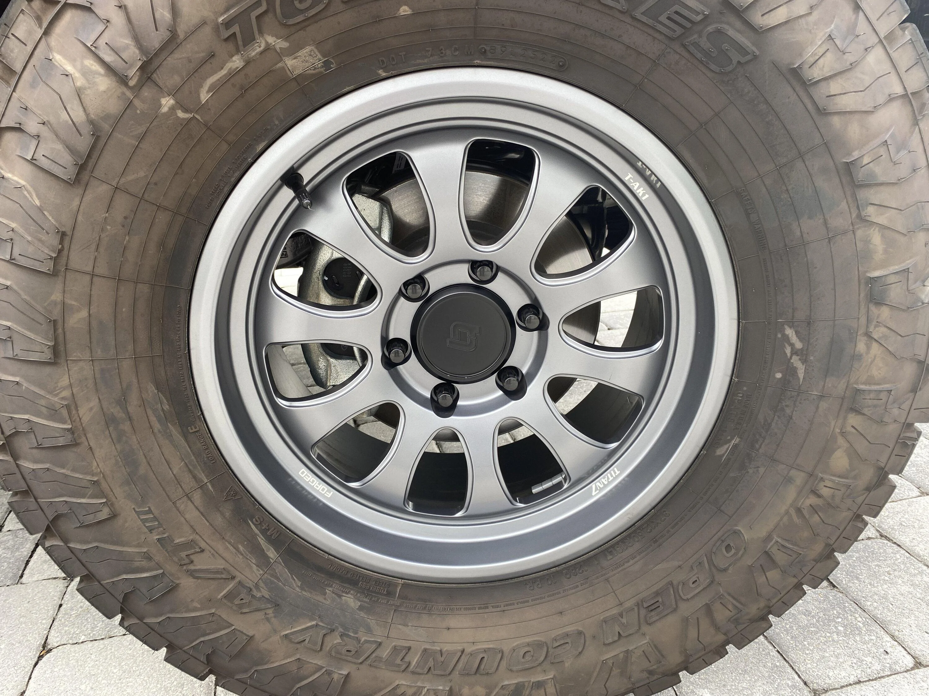

Titan7 Forged Wheels. Toyo 37/12.50/18 ATIIIs.

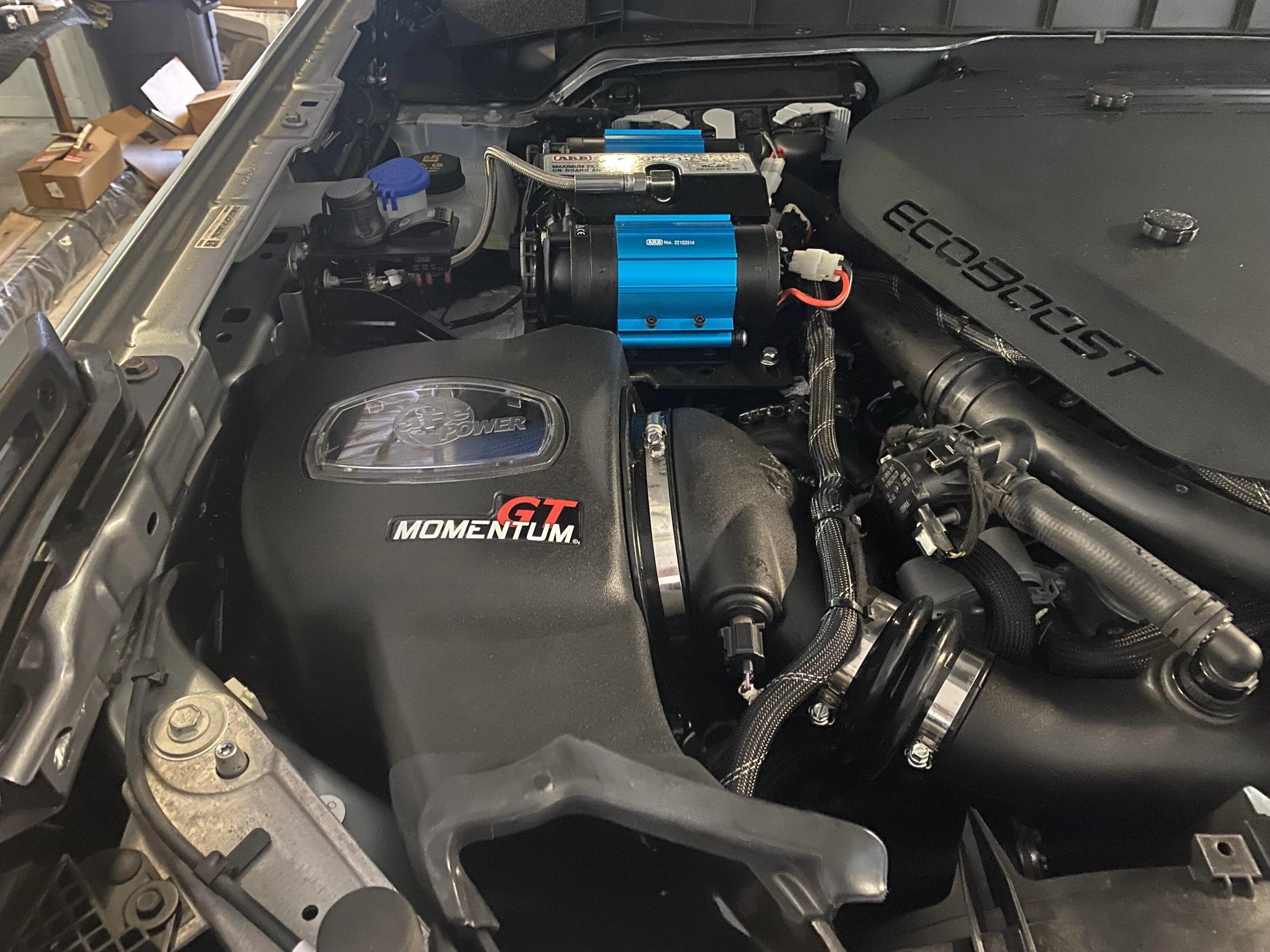

ARB Twin Air Compressor with Engine Compartment Switch and Wire Harness. AFE Cold Air Intake.

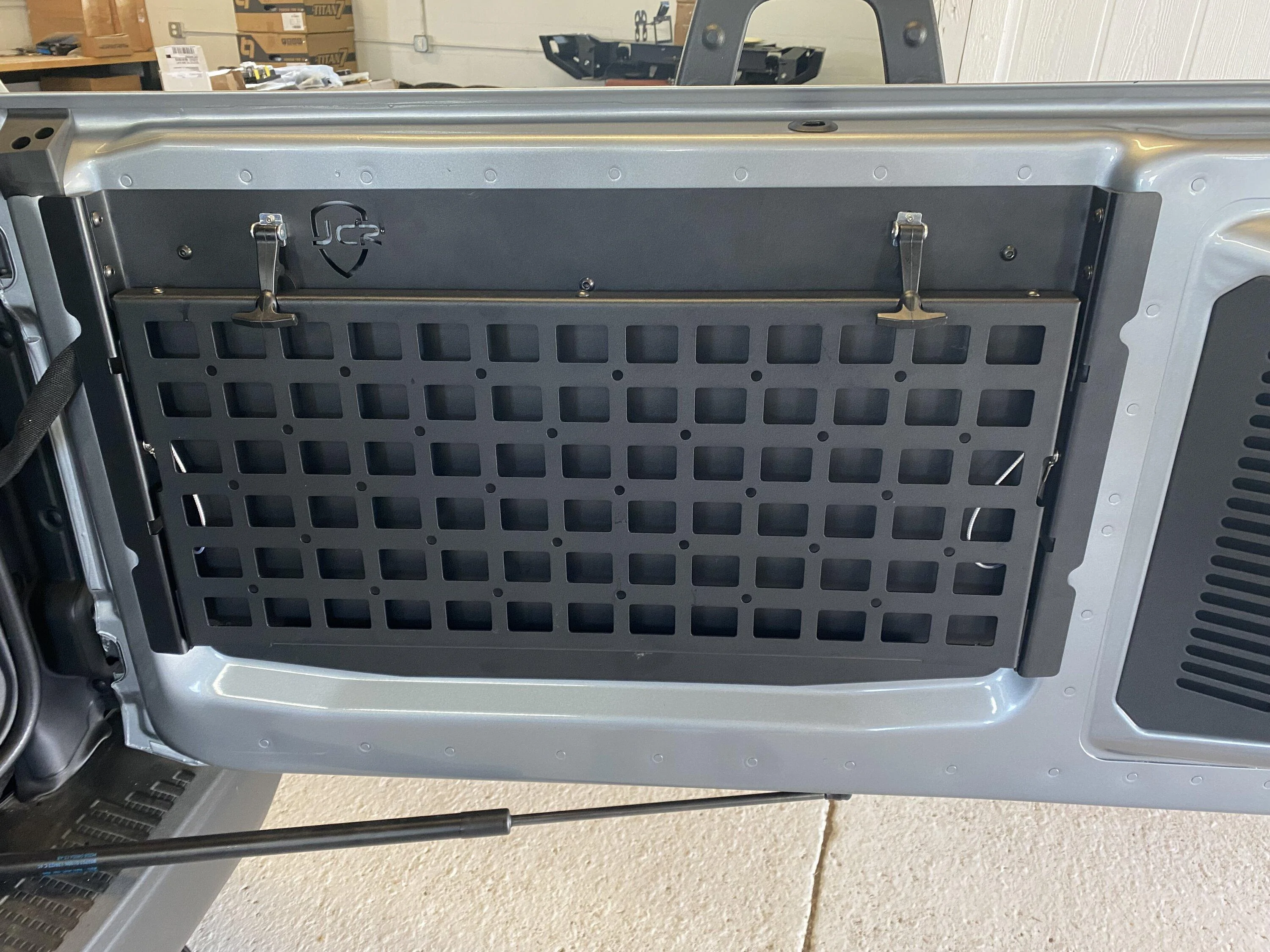

JCR Tailgate Table. No drilling required.

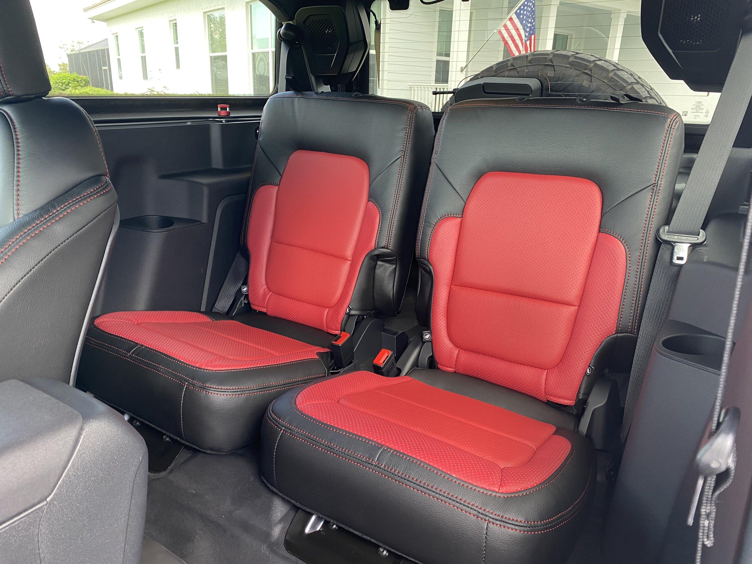

Katzkin Leather Seats - Black Seats With Red Perforated Inserts and Wings With Red Stitching
Ford Bronco 2023 2-Door Iconic Silver Badlands Build IMG_0870
Rear Seats with Head Rests Folded Back.
Ford Bronco 2023 2-Door Iconic Silver Badlands Build IMG_0902

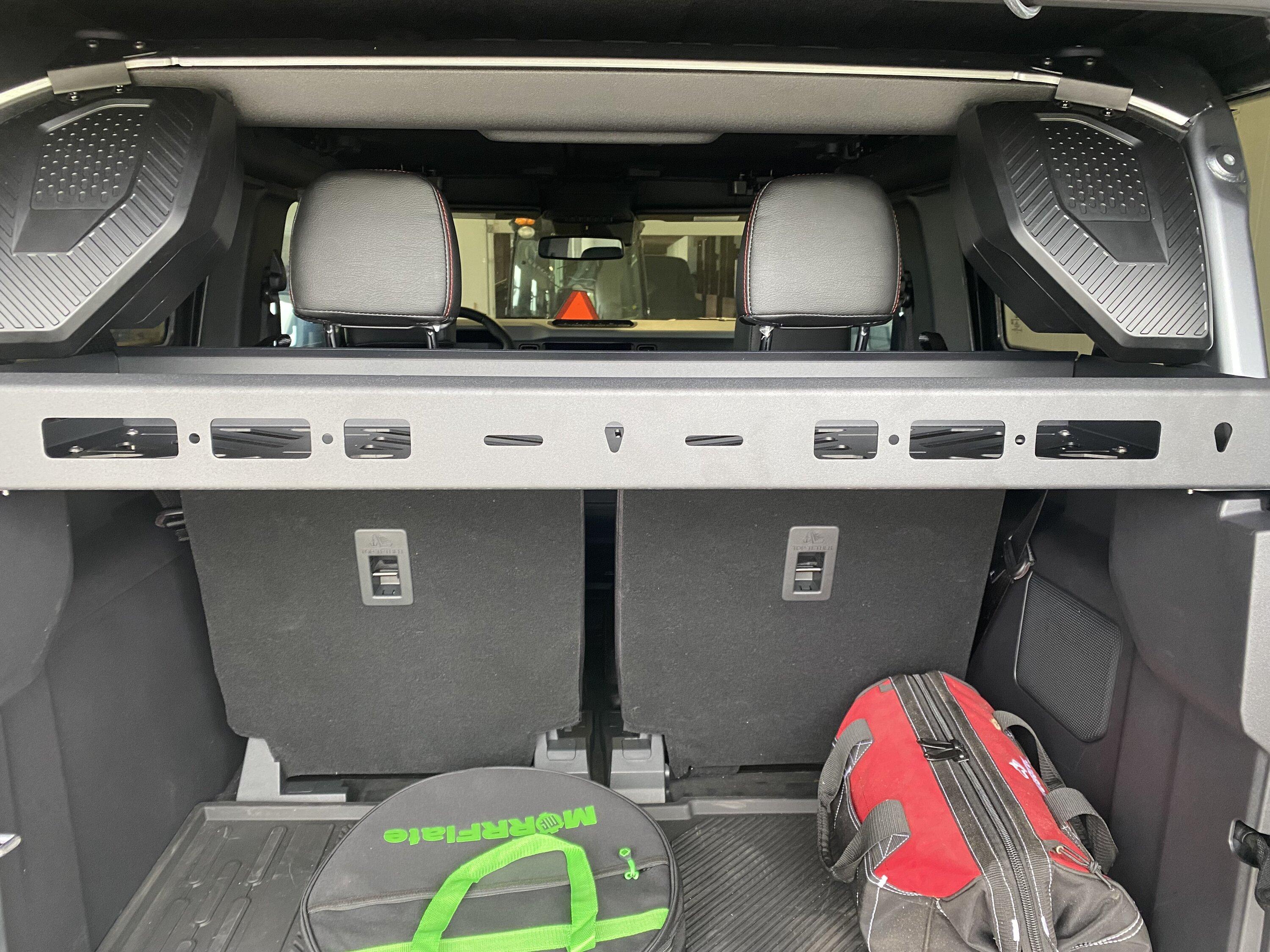

JCR Rear Basket. Very sturdy Shelf that almost doubles storage in the back.

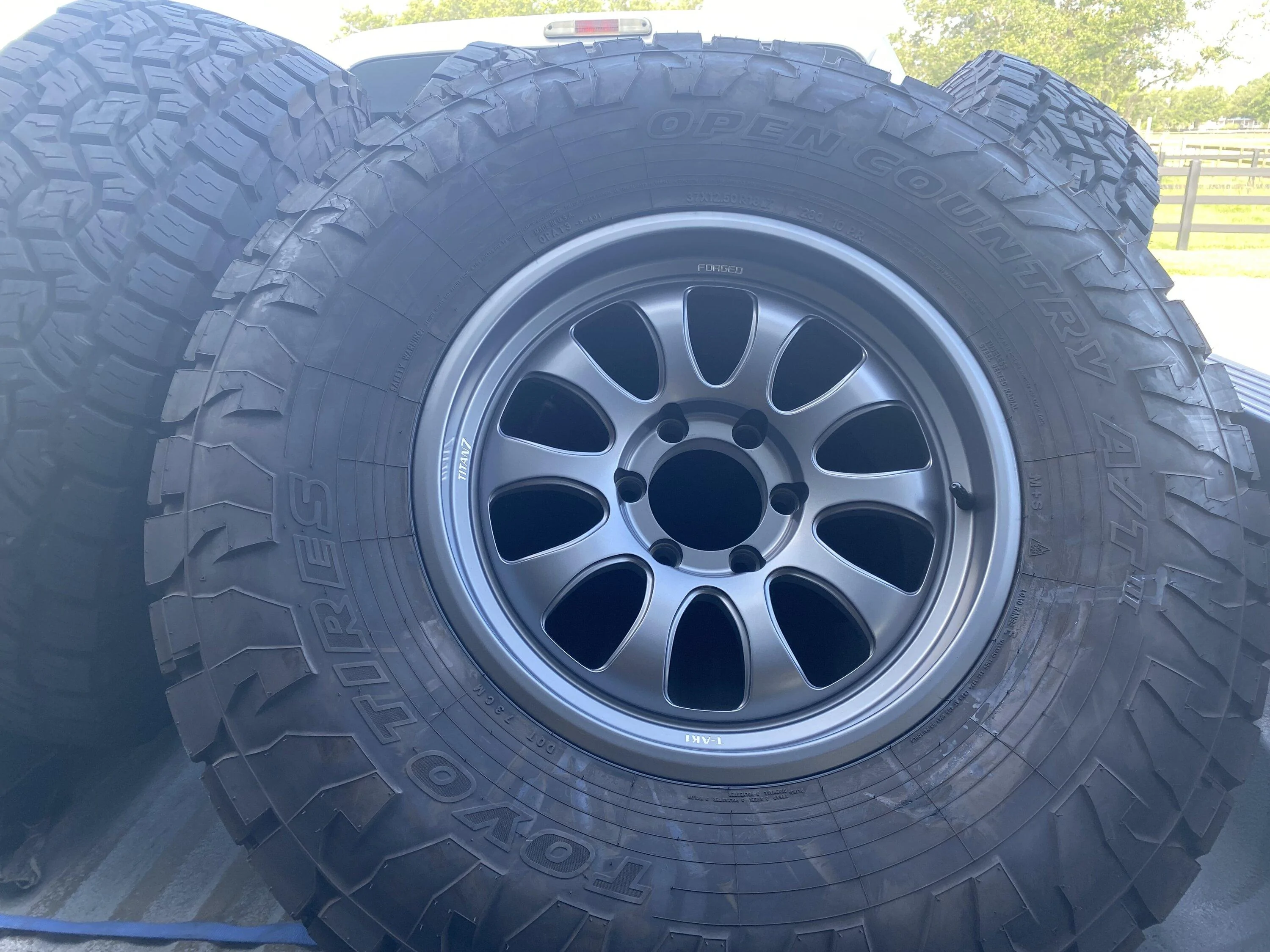

The Tires and Wheels were mounted and balanced yesterday. The installer was very impressed with how light these wheels are at 20 pounds. They balanced well with very little additional weight.
Total weight of this set up is 91 pounds and is within 4 pounds of the Factory Sasquatch tires and wheels.
Not a great picture, but the Titan7 Satin Titanium is a little darker than the Titanium Method or Icon wheels.
37/12.50/18 Toyo ATIIIs and 18x8.5" Titan7 AK-1 with an Offset of +20. I did not want the Bronco listed AK-1s on their website at 17x8.5" with an Offset of -8. These would stick out past the fenders more than I like. I will install these with 93-106 Hub Centrics.

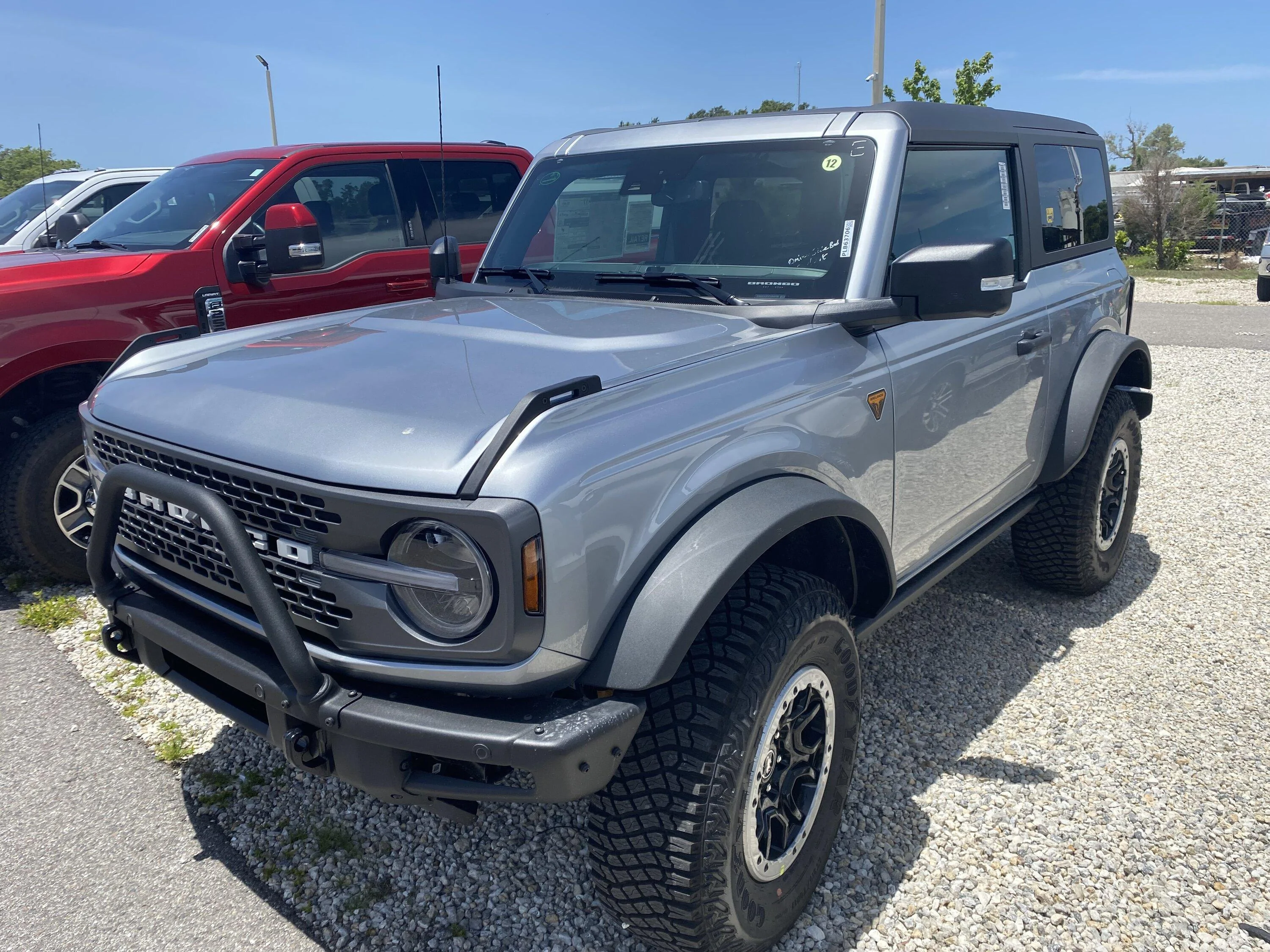

Here she is!
Arrived yesterday at Dealership.
Ford Bronco 2023 2-Door Iconic Silver Badlands Build IMG_0808

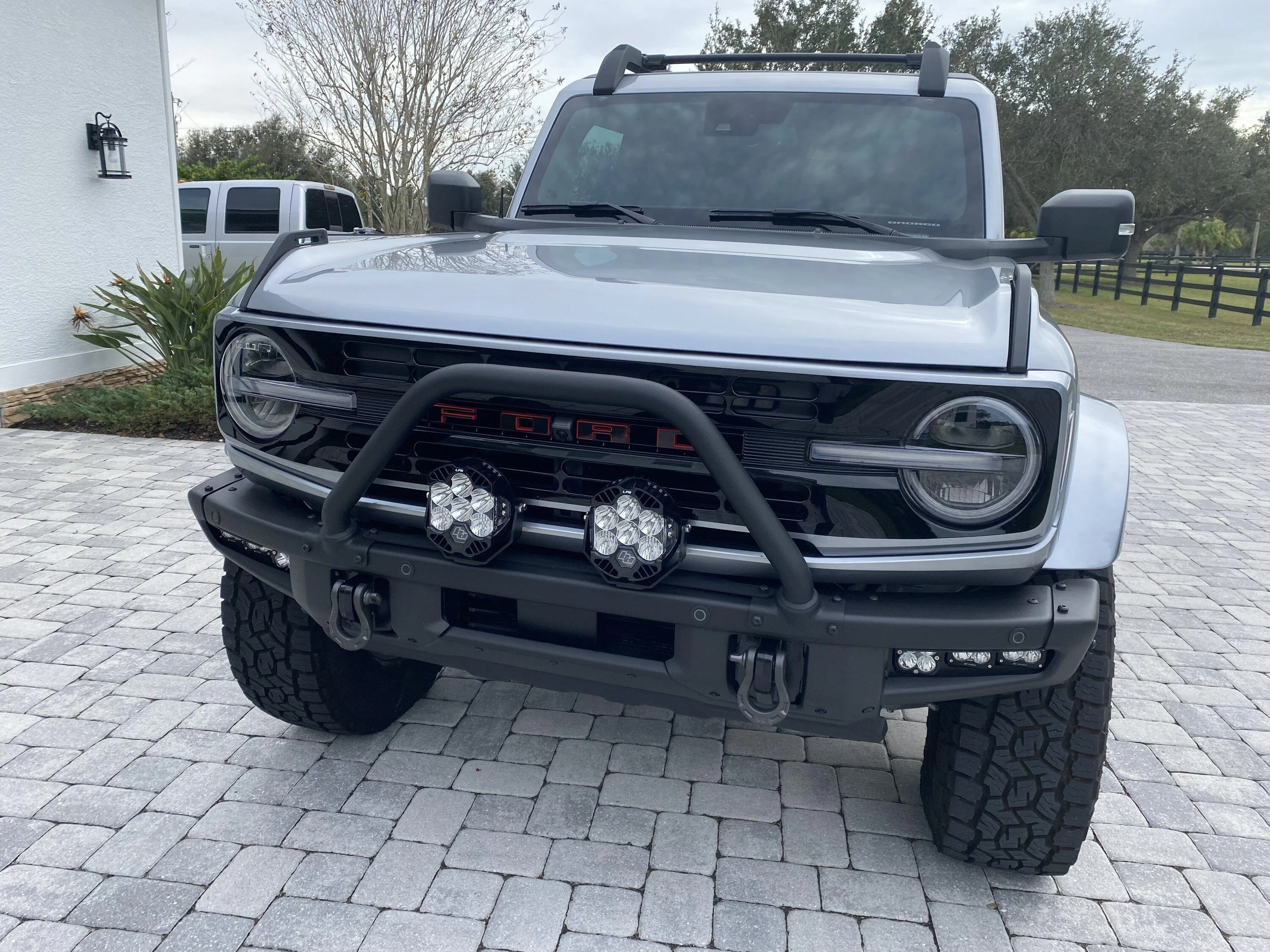

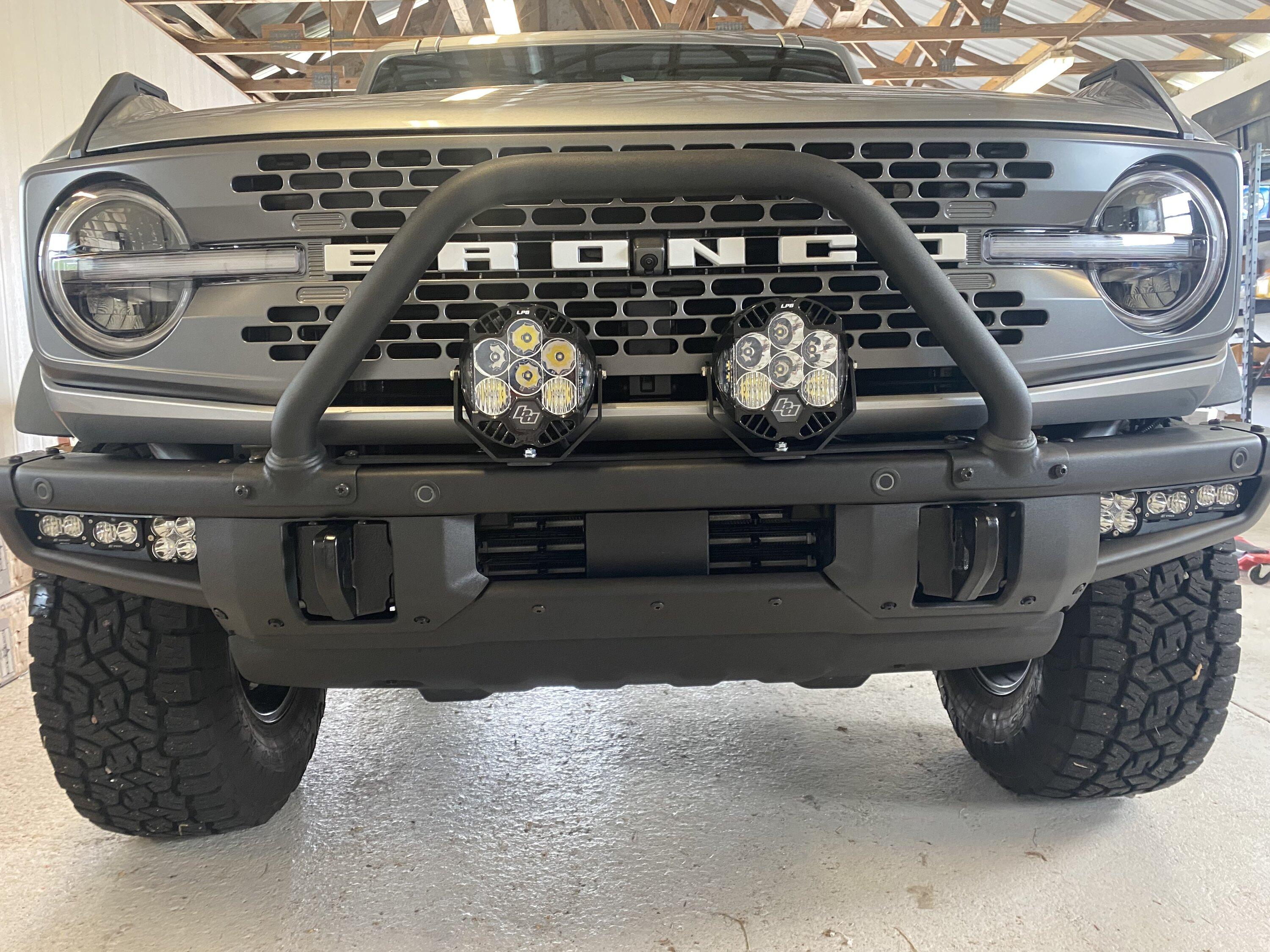

Baja Designs Lights were installed yesterday.
The Modular Bumper Pros are down low for Fog Lights and LP6s are up higher for driving lights.
I used AUX switches #5 and #6 for the Fog lights and Aux #1 for the LP6s.
Ford Bronco 2023 2-Door Iconic Silver Badlands Build IMG_0817

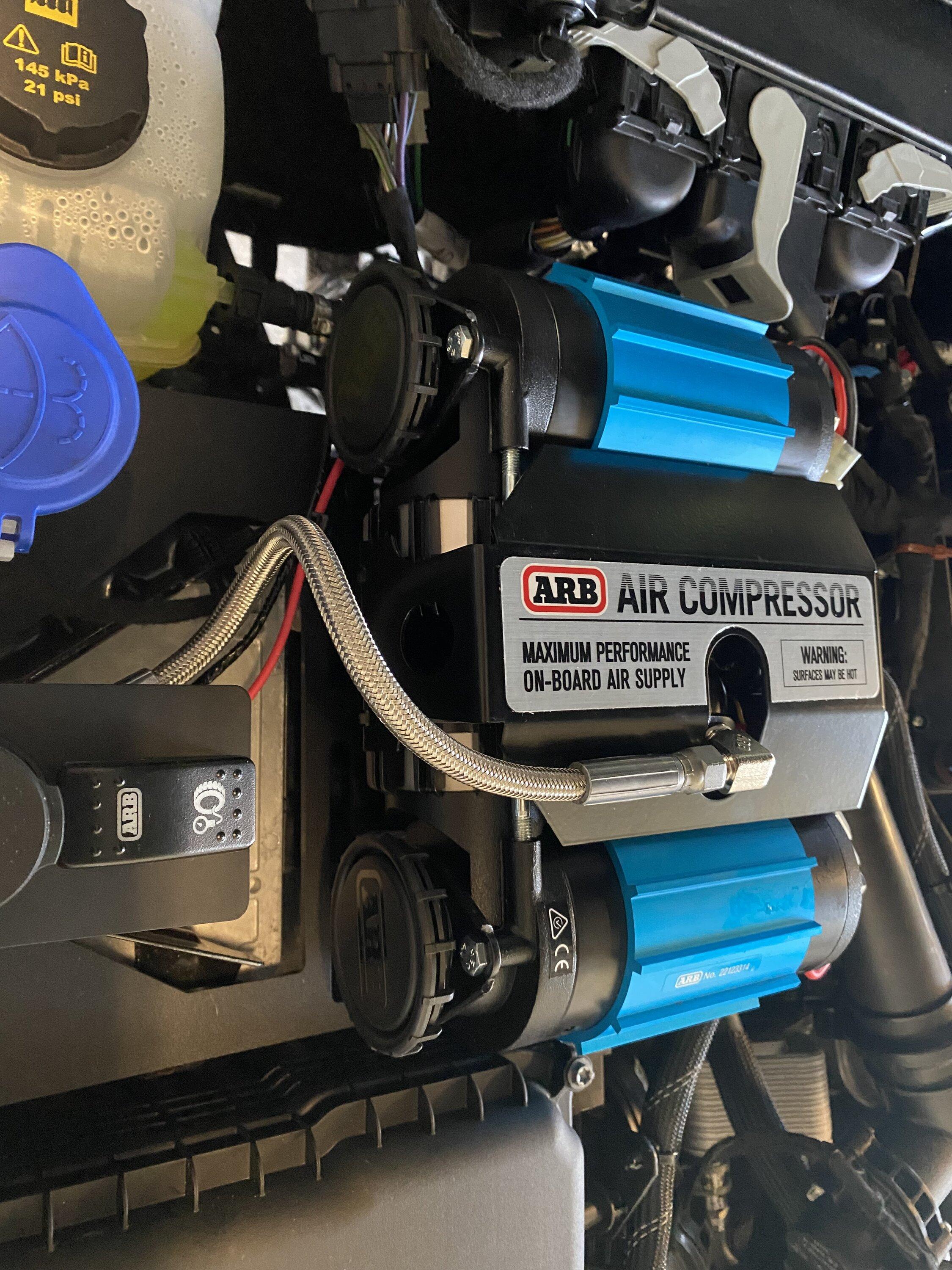

What underhood mounting kit is that for the ARB twin?
rguest3
rguest3
Raymond
Jul 29, 2020
981
1,326
Florida and Virginia
F-350, F-450, 23 Bronco, 24 Raptor, (2) 77 Broncos

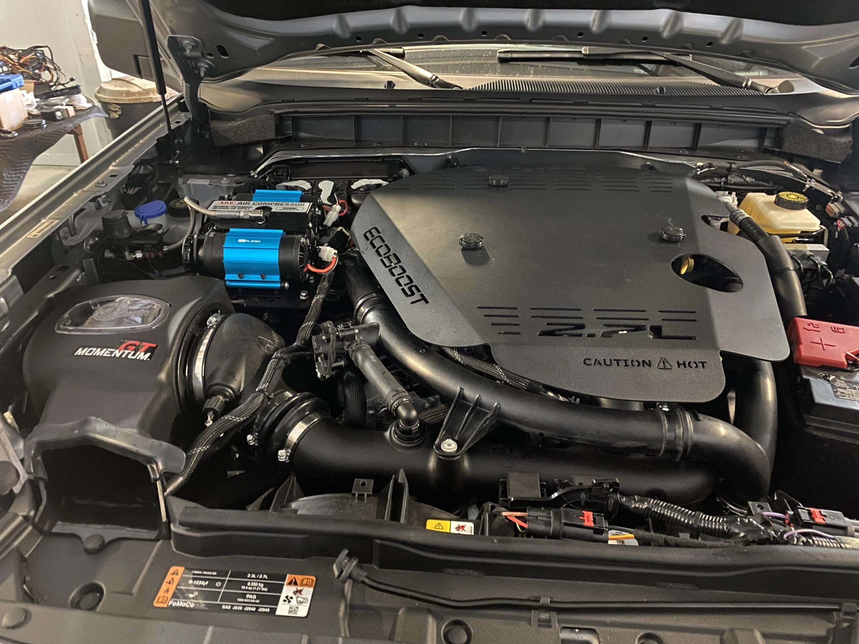

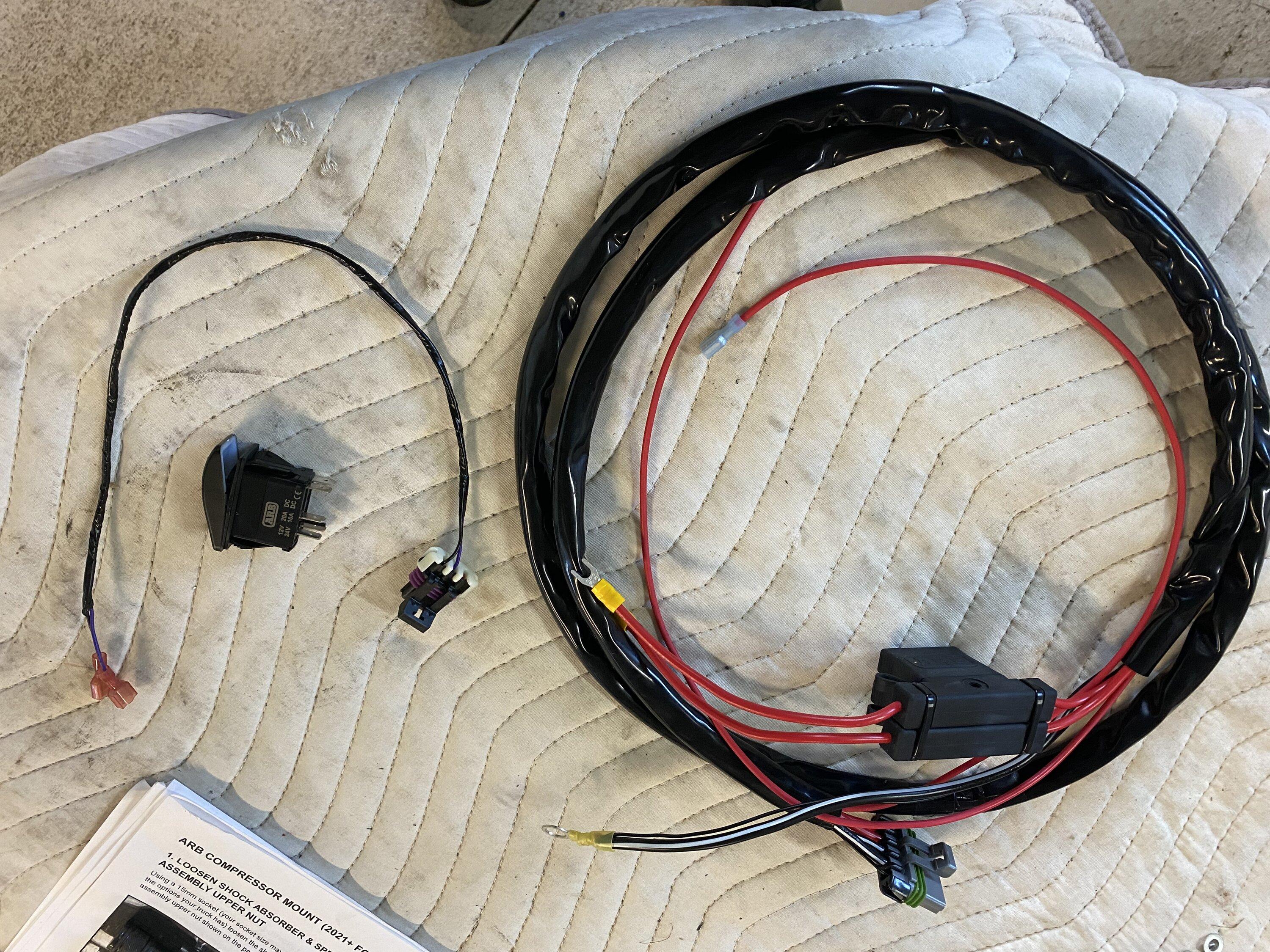

4x4 Truck LEDs compressor mount and switch/hose connect mount. Very clean and easy install.
Parts included for install.
ARB Twin Compressor - CKMTA12
Compressor Mount - 4X4 Truck LEDs
Switch and Coupler Mount - 4X4 Truck LEDs
Remote Line Coupler - ARB 740111
90' Fitting at Compressor - ARB 740110
90' Fitting at Coupler - ARB740104
Pressure Line - ARB .30 Meter, 740201
Switch Wire Harness
Ford Bronco 2023 2-Door Iconic Silver Badlands Build IMG_0824
I also used the existing smaller plug with the Purple and Black wires from the Compressor to the Switch. I added another wire from the switch to the Fuse Box with a Fuse Tap. (This wire is hidden in the Compressor main power harness)
Along with the list of parts above, this is the only wiring required for the install. Pretty simple and very clean. (Purple, Black and Red wires pictured go to the switch)
Edit: I now have a 4x4 Truck LEDs Wire Harness with all three wires together and no additional wire to fuse tap at Fuse Box.
Ford Bronco 2023 2-Door Iconic Silver Badlands Build IMG_0823

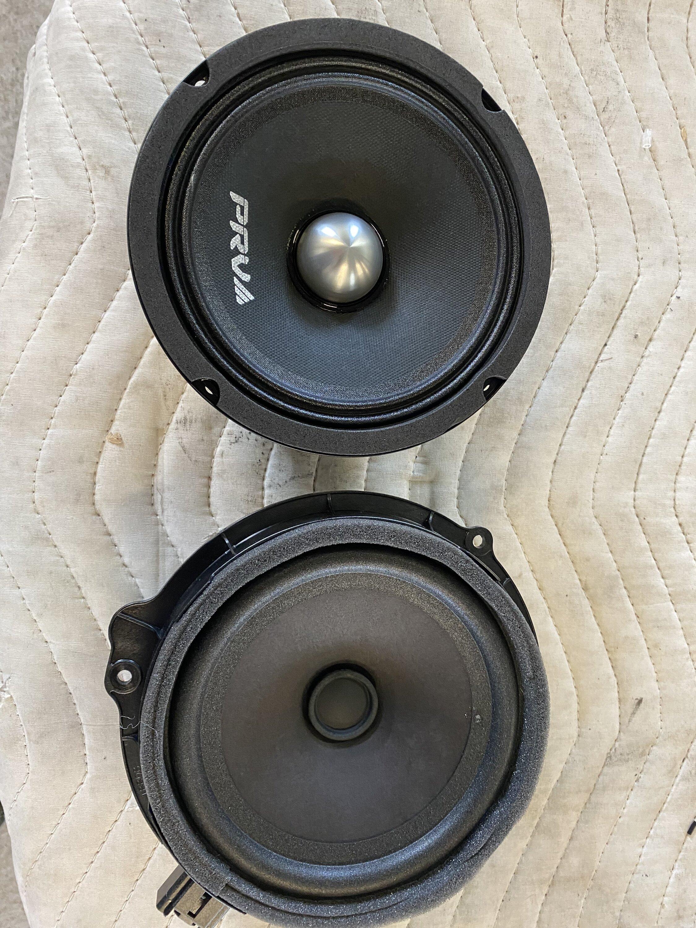

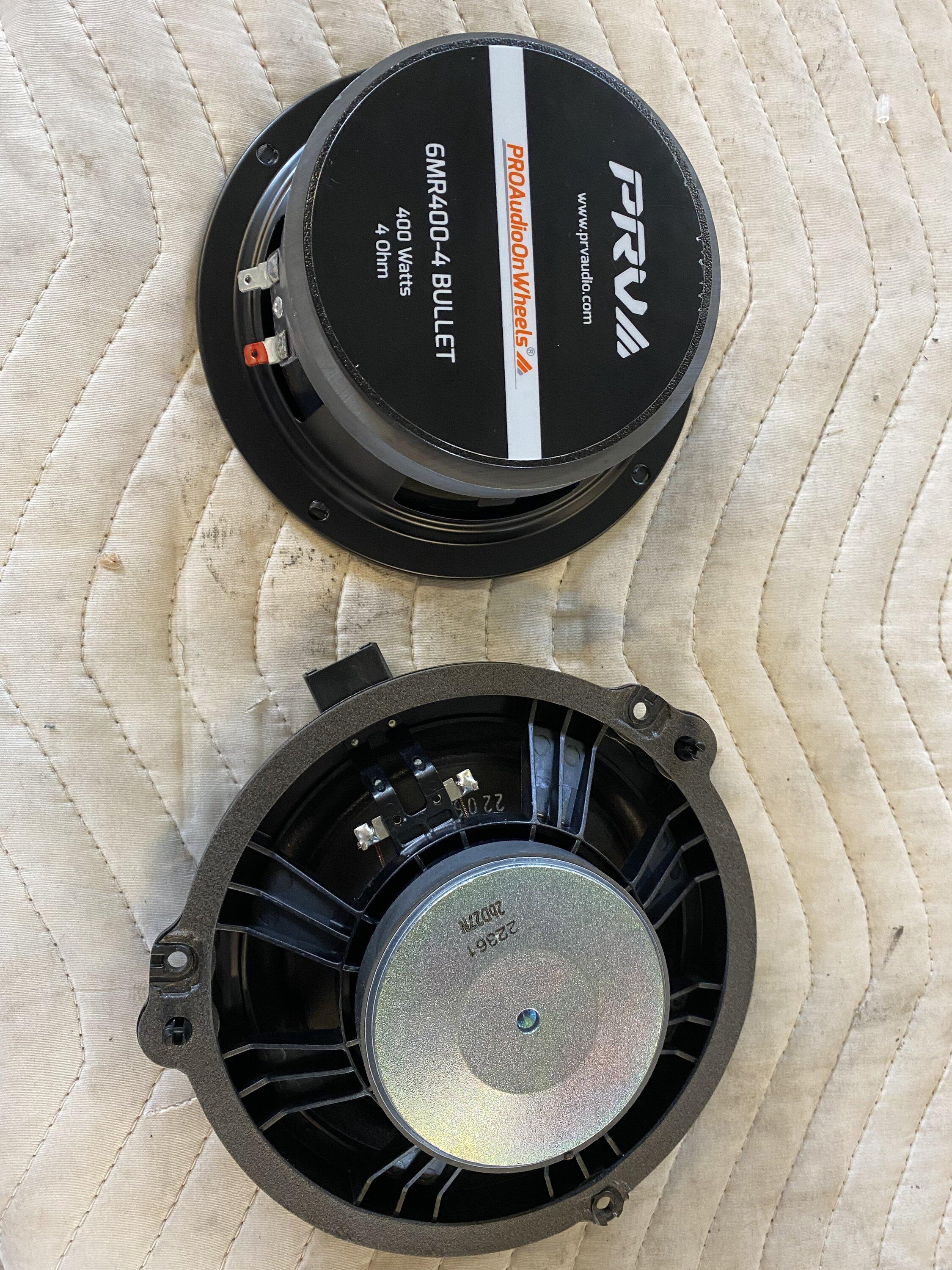

I finished up installing the Upgraded Stereo Speakers.
The biggest improvement over the Stock B&O speakers was the Mabett Rear Pods with the PRV 6MR400-4s installed with added sound deadening in the back of the Box and Poly Fill. This is a very efficient speaker with a broad range for a Mid Range and sounds great with the Kicker Subwoofer as well! I had to adjust the balance to the front to even out the sound. The 3 Front Dash speakers were already installed and the combo paired up very nicely.
Edit: I have installed the Kicker 6 3/4" in the Kick Panels. Again, great increase in sound quality with additional Bass response.
I have Not added Amps or a new DSP. I don't feel that I need to in my case. These speakers sound great as is, but would more than handle just about any Amp set-up if I chose to add later.
Here are pictures of the Factory B&O Kick panel speaker vs the PRV 6MR400-4 I installed.

There is A LOT more sound coming from the rear pods now with the 6.5" speakers. The PRV speakers I chose are considered a Mid Range speaker (like original) they are very efficient, much better sounding with a broad range. Updating the rear pods had the greatest improvement overall.
The Rear Pods are very easy to change out in a 2-door. With a 4-Door Hard Top the top Bolts on the Pod Brackets are more difficult to get to due to being very close to the top. Much easier with a Soft Top.
Here is a difference in size between the 4" and the 6 3/4" Kickers I installed.
