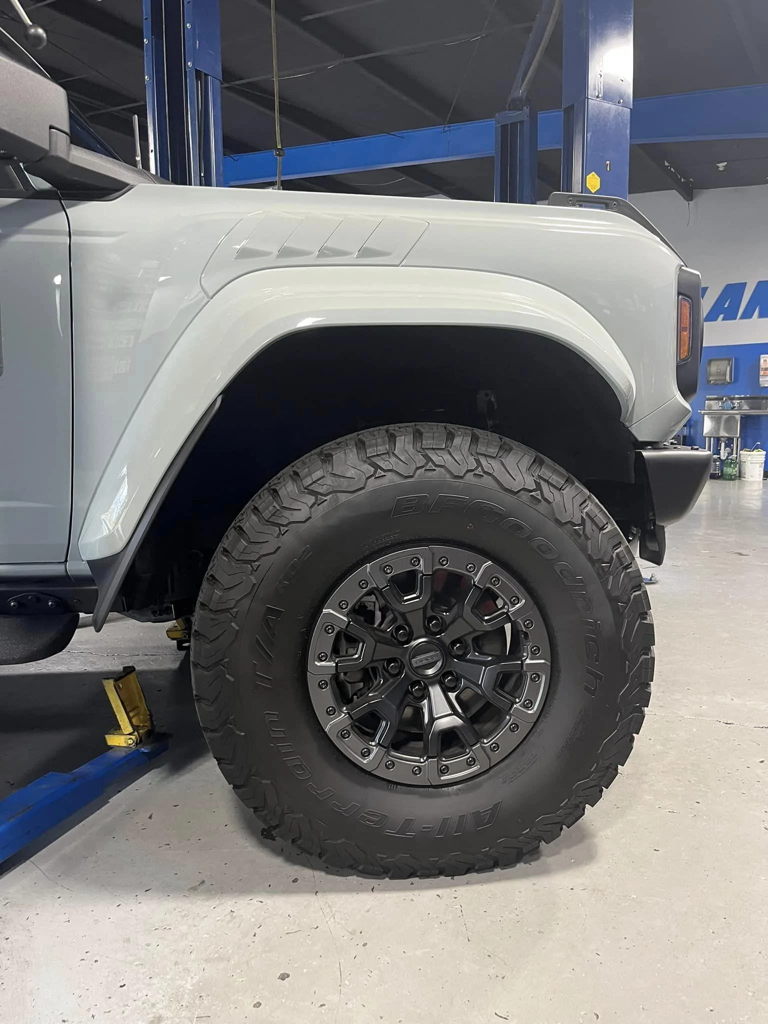

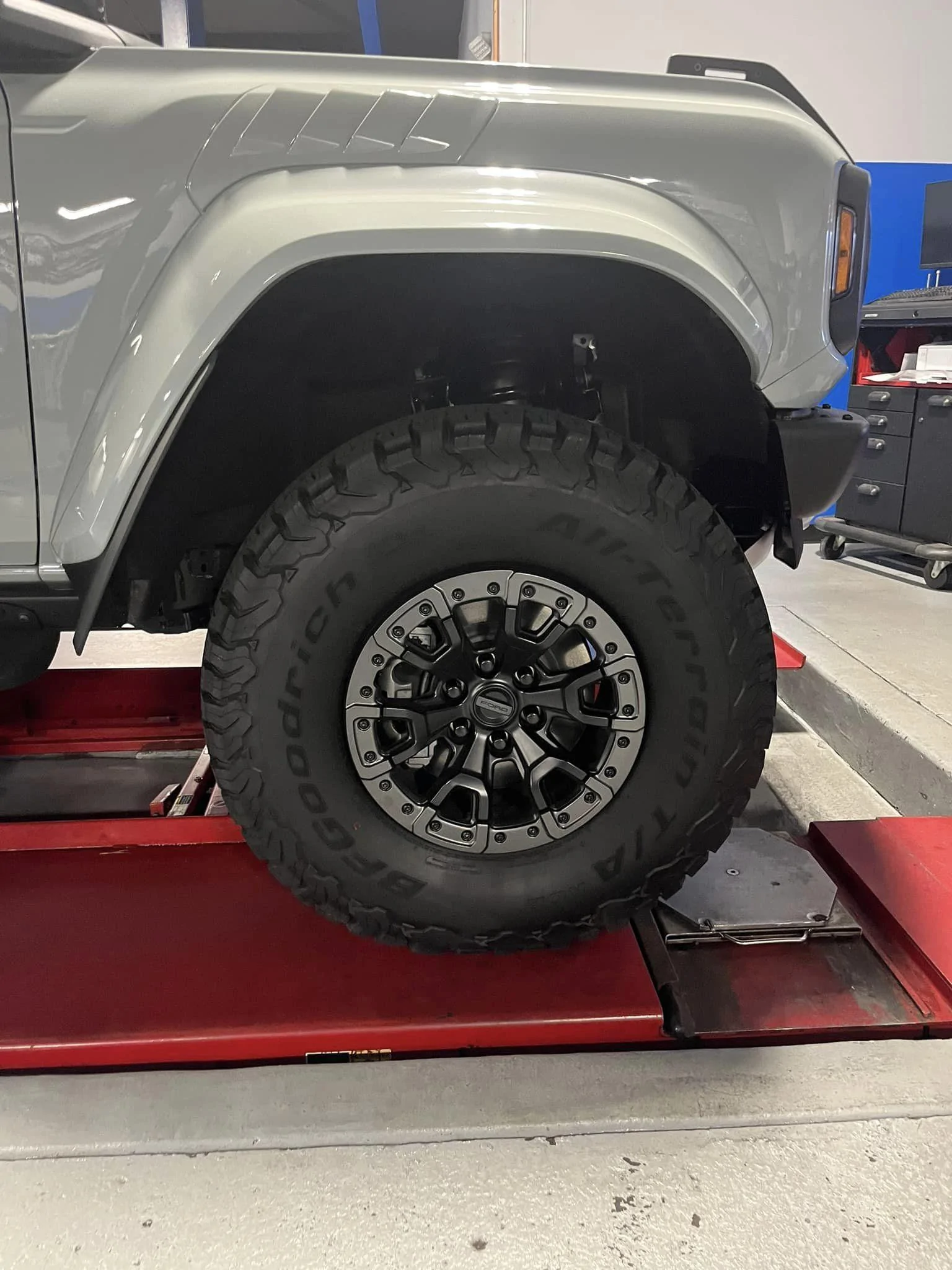

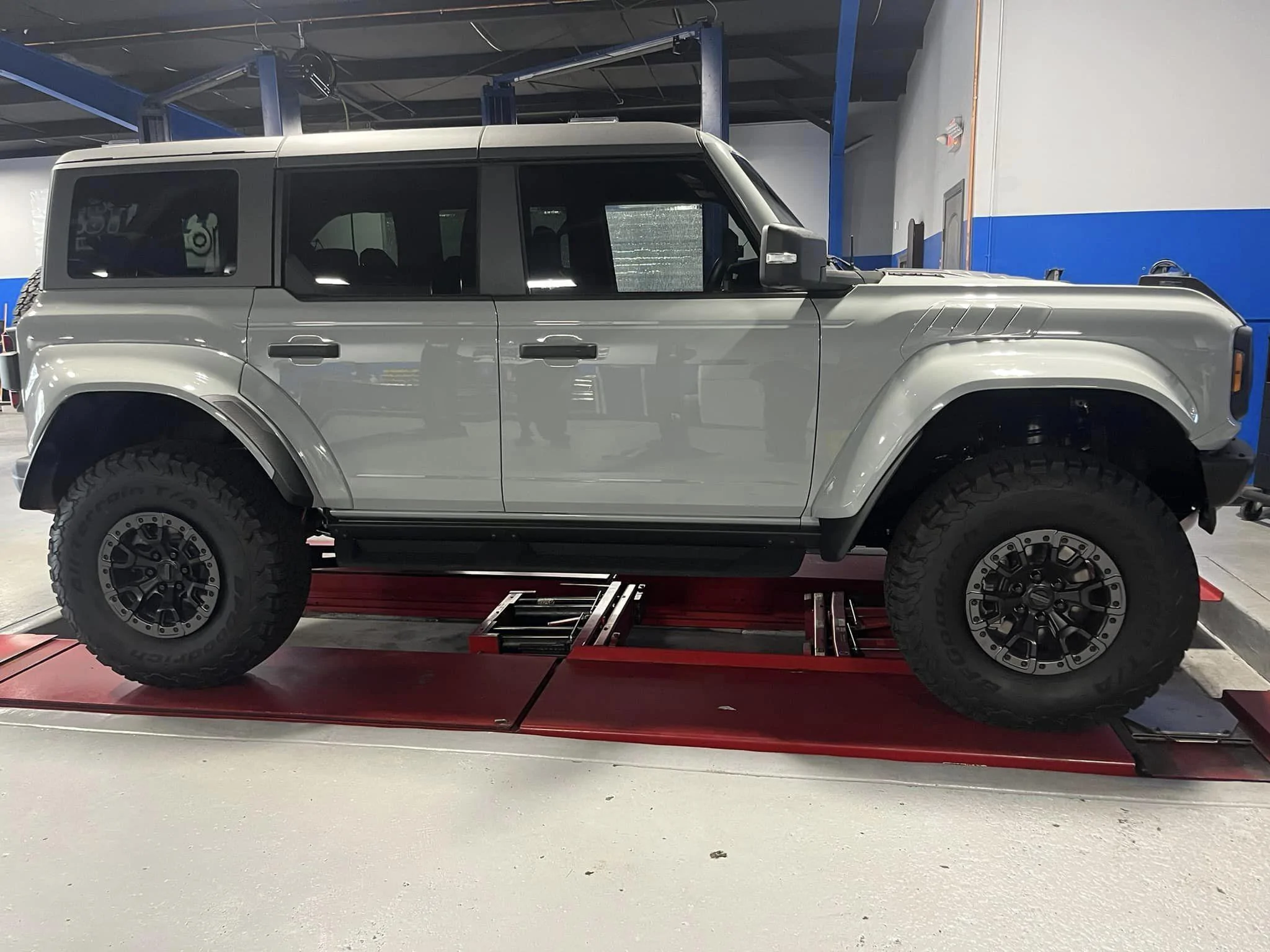

Found pics of your Raptor leveling kit installed on a customer Bronco Raptor. Looks great leveled!

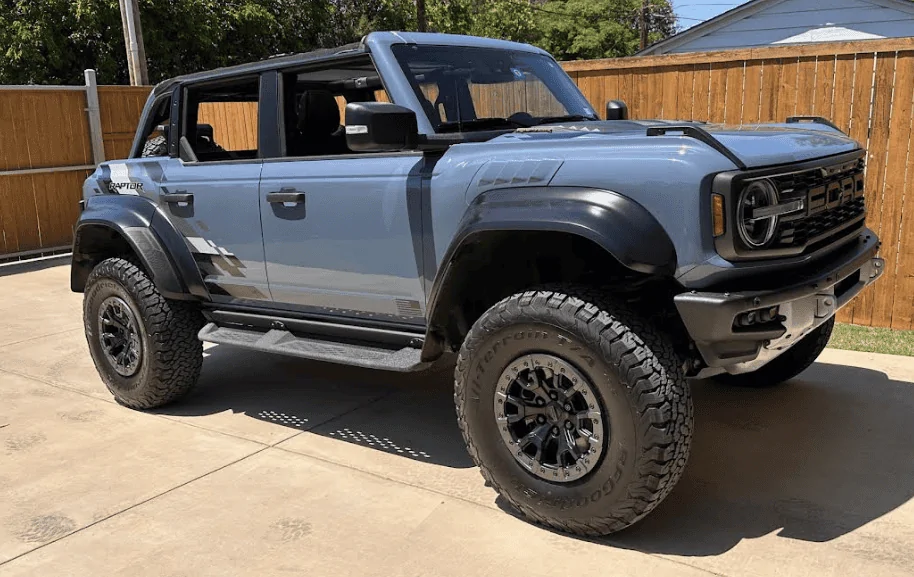

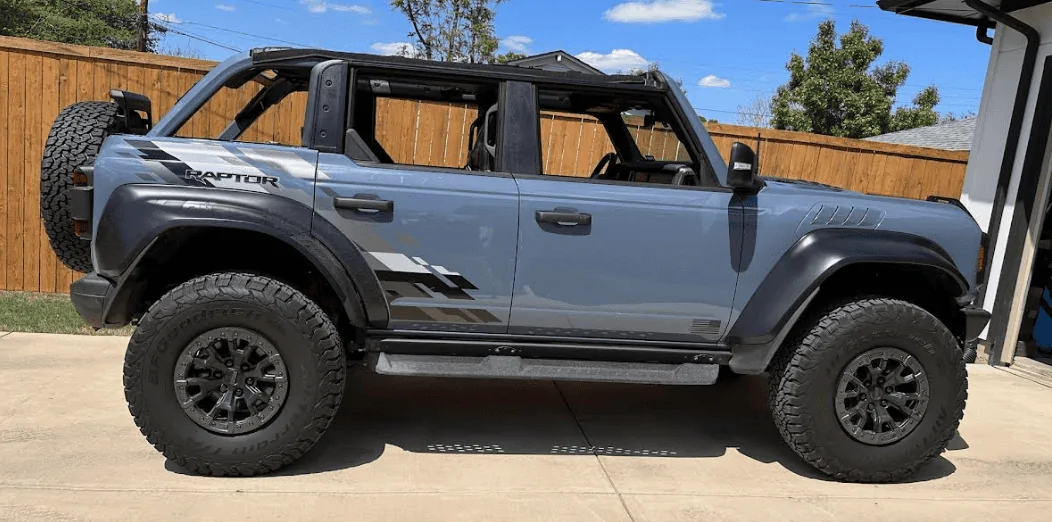

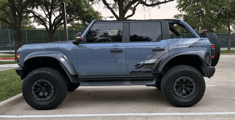

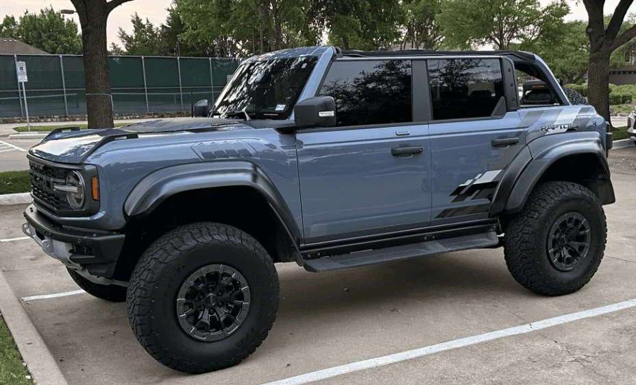

I just had the Foutz Front Leveling Kit installed on my Braptor today (1“ Collars) and like it. @GregFoutz is it your experience that the shocks/springs need to settle after installation? Right now the fronts ground->fender is ~ 0.5” taller than the rear giving a slight squat. TBH I prefer this over the factory rake but hoping they settle back to level. Maybe just some aggressive driving over rough terrain, if not hard braking will help getting everything to settle.
Before:
Ford Bronco Bronco Raptor front Leveling Kits by Foutz Motorsport 1682994925949
After:
Ford Bronco Bronco Raptor front Leveling Kits by Foutz Motorsport 1682994949862
The angles of the pictures make it appear more of a squat than it is. I measured ~2deg front-to-back slope.

Was hoping the vehicles and spacers together were precise enough to get true level. @DallasCajun , I would not expect any settling in - that generally indicates overstressed springs. Did you find any settling? If not, any input @GregFoutz ?

No we didnt see any settling in really in our testing. do you have more stuff in the rear that would add weight back there? Did you drive it enough for the live valve shock to release after install? should only have to drive it around the block for that to release.

No the only settling is if the live valve shock isnt releasing yet after installing and getting them fully extended. but no the springs with that short of a collar on them dont normally have a settling issue.

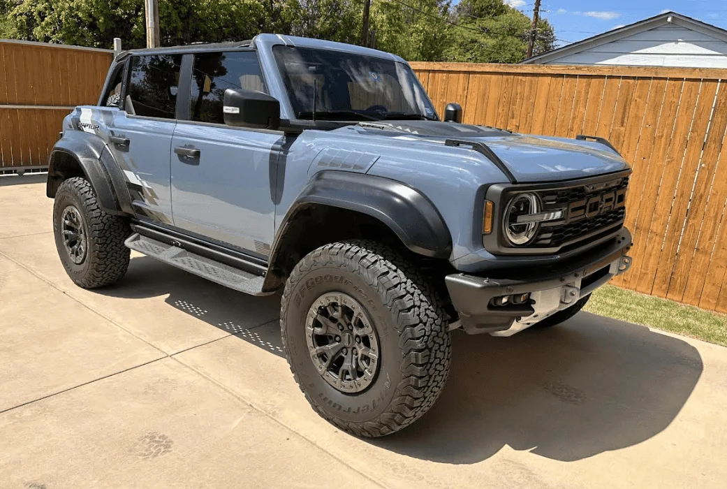

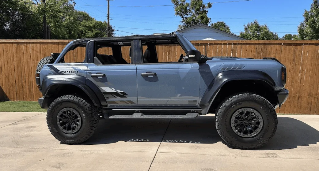

Thanks for the response, I actually forgot to update this thread as I was tracking it more on another forum. As it turns out the collars that were ordered by my local shop were 1.5" and not 1.0" that I didn't catch when quoted so it did create a bit of a squat. I ended up having them order 1.0" collars and installed on the rear so now it's actually level given how soft the rear springs are.
In the end it's measuring about 1.5" lifted in front and 0.75" in the rear with the slightest rake (< 0.25").
