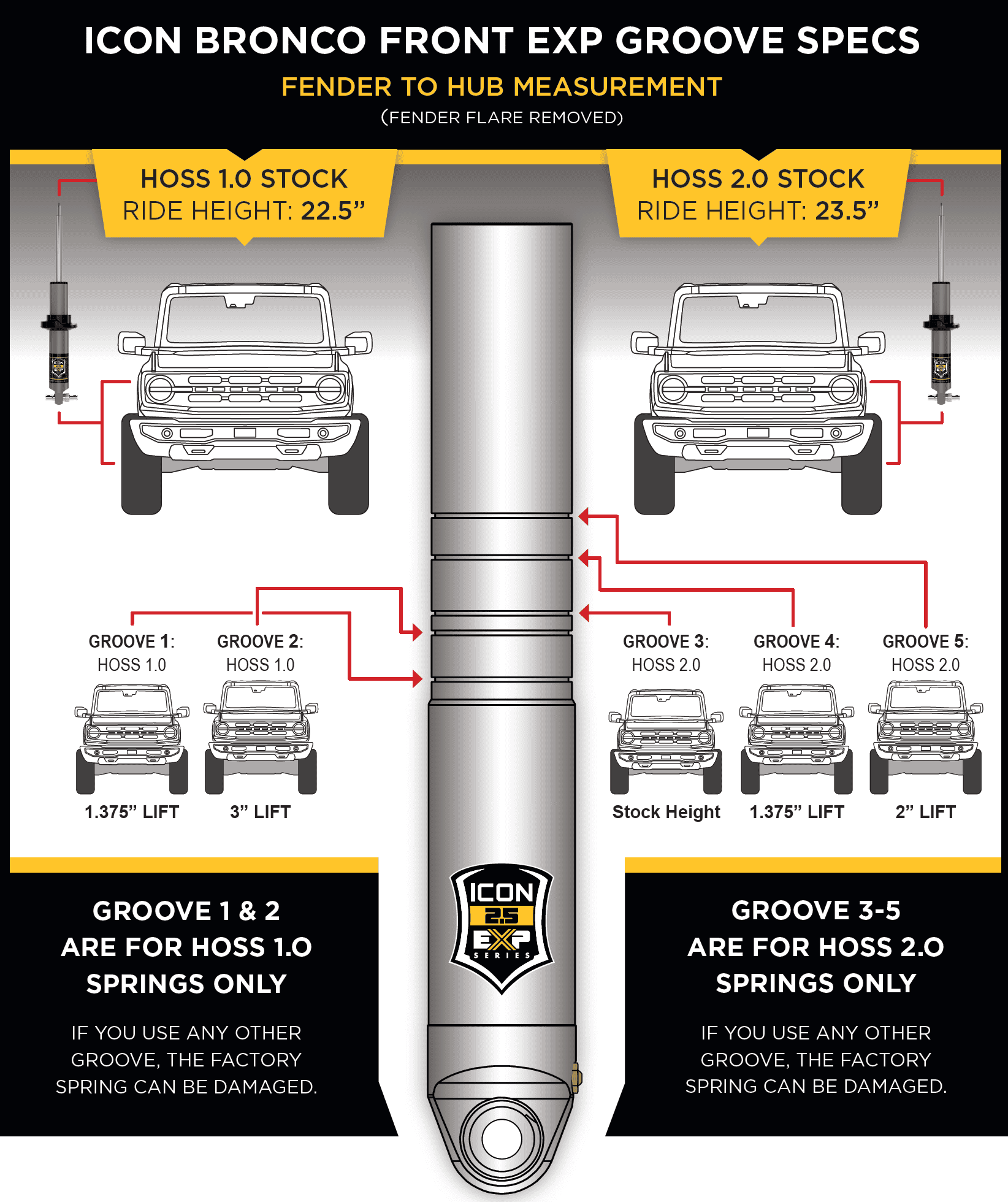

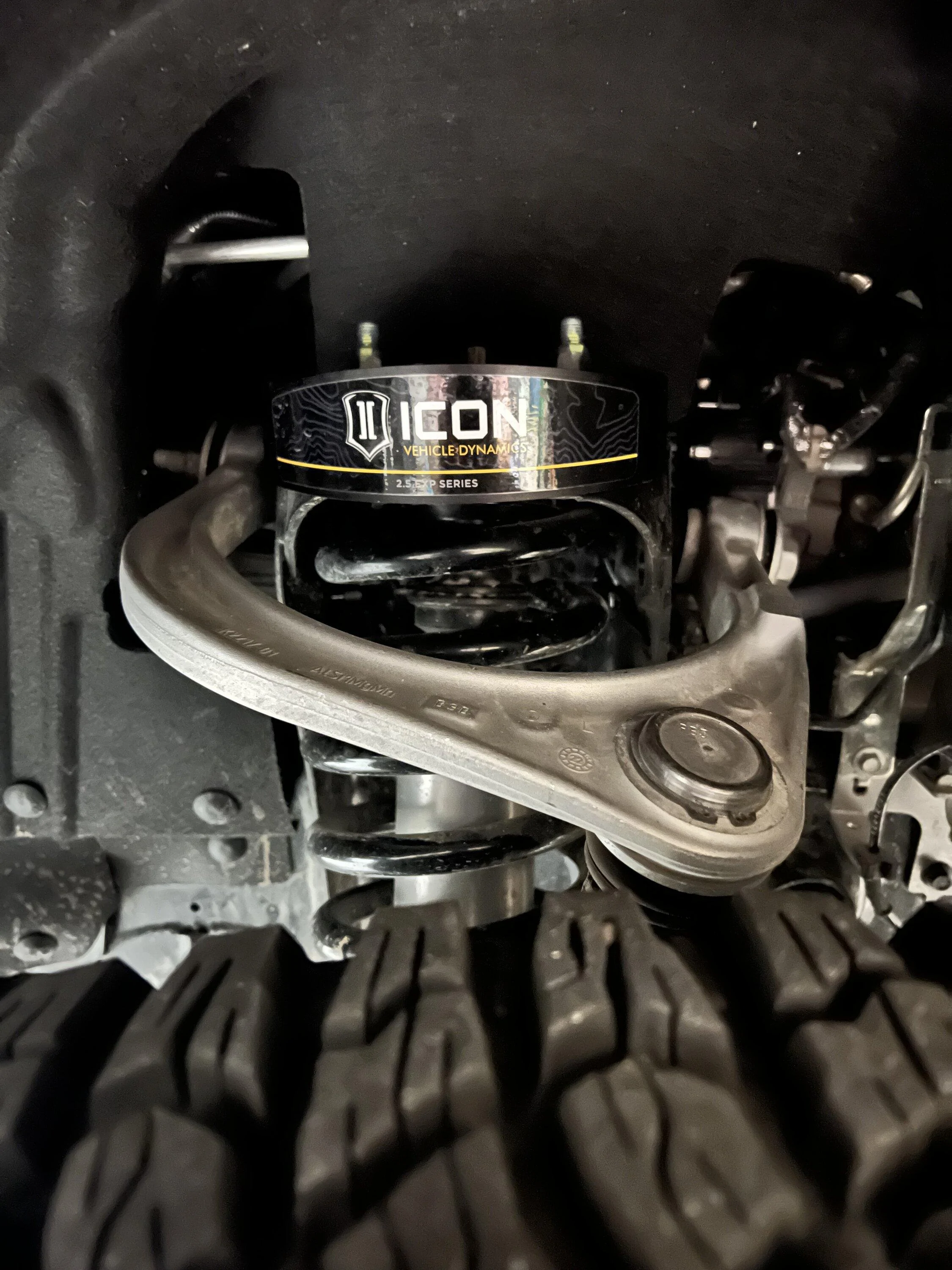

My SAS setup dropped quite a bit after Maxlider bumper, grille guard and winch. Replaced the front Hoss 2.0 Bilsteins with Icon Vehicle Dynamics 2.5 EXP ride height adjustable shocks using the factory SAS coils. Set to groove 4 on the ride height and looks and rides great.
Ford Bronco Compensating for winch weight? 1679324594217
How did the ride change with the icon 2.5s? Thinking about the readylift 1.25 level kit but maybe I should go this route. With it all the way up to groove 5 do they say you can get 37s on with no problems? Probably just stay with 35s but always like the option.

Ride is slightly firmer. Before I switched the shocks, the truck would dive pretty severely during braking. Icon's solved that problem. I purchased a readylift 1.25 (still in the box), when I saw it would take nearly the same amount of work, I went with the Icon's for increase oil volume and the ability to go up still if needed. 37's should be possible with the right offset. Not sure if the crash bar mounts would need to be trimmed.
You kept same upper control arms?
