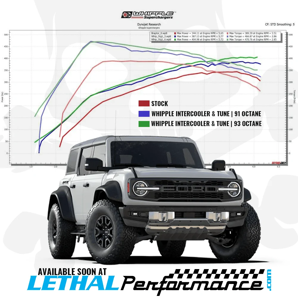

Ford Bronco ECU tunes for Bronco Raptor B463CD80-17EF-4DB1-944A-281F2A9055D7
The numbers are IN! 😱 Whipple Superchargers has their tuning done for the new Bronco Raptor, picking up 60rwhp with their tune & intercooler on 93 octane. Whew!
Red = Stock
Blue = Whipple Intercooler & Tune | 91 octane
Green= Whipple Intercooler & Tune | 93 octane
Available to ship Monday. Carb pending http://www.lethalperformance.com

Also, great work here Whipple! Very nice numbers, looks like close to 500 crank HP on 93.
Is there any possibility of a tune that can accommodate 91, 93 and something like an ethanol blend making something like 95 effective octane. Something that accommodated different fills and provides benefits for all would be ideal. Since the factory ECU can pretty well do this, why not tunes?
