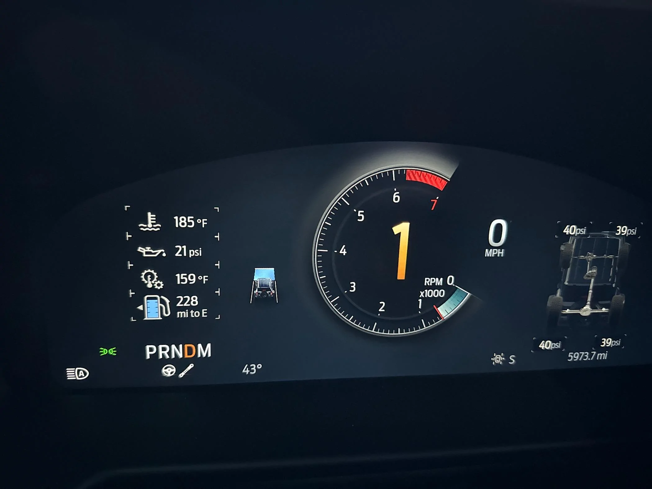

I recently installed the S&B intake. Upon start up my exhaust modes are now gone. Never had this issue.
Any recommendations or thoughts?
NOTE: Also have the Whipple Stage 1 with MegaCooler installed for 2months with no issues until this week following S&B intake install.

egg on my face… 🤣 called all the engineers, stumped them for a few days and then… I looked one more time before heading to the dealer….. I never plugged the intake temp sensor back in 🤣
