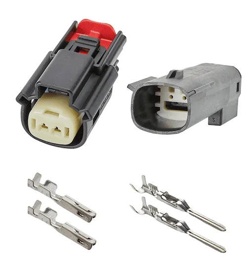

I don't think so. I believe the factory harness uses a 2-pin MX150 style connector (pictured below). I'm not sure what kind of connector it is that comes on the light kit you linked.

I just wired my new fog lights straight into the plug, black is ground, the other is power. I sealed with electrical tape so if I ever revert (no idea why I would) I can just unplug and replug.
