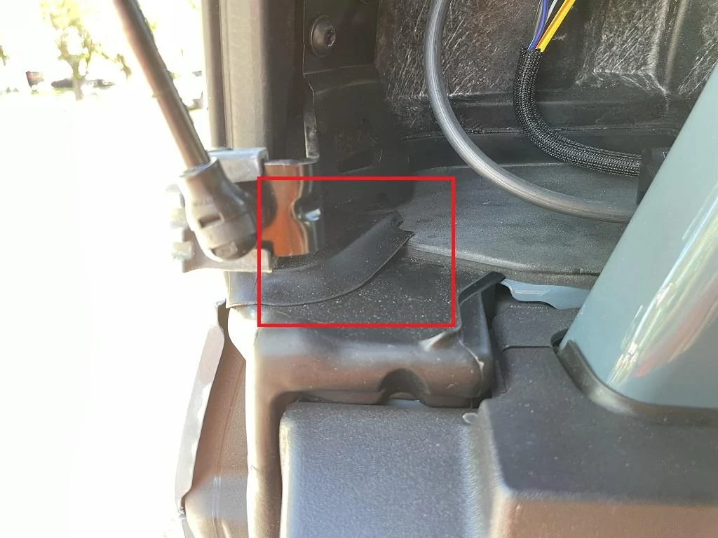

On the quest to make the roof quieter for road trips, I've been looking for gaps in the roof seals. I found one that I haven't seen on the forum yet. On each side of the roof near the rear glass, this spot had enough of a gap to see through. I put a little bit of weatherstripping in there and now it's one less place making wind noise on the highway.

What’s the weatherstripping you used?

Basic 1/2” thick foam weatherstrip.. Found at any superstore. Squeeze it thin before inserting and it expands to fill the gap. I did the same with the front roof panels where they meet the back roof and it helped a lot.
Duck Brand Self Adhesive Foam Weatherstrip Seal for Extra Large Gaps, 3/4-In x 1/2-In x 10-Ft, 1 Roll, 284426 https://a.co/d/4Tdqog5

Do you have an “after” picture? Trying to get an idea of what you did.

I don’t, and it wouldn’t show much anyway. I cut off about 1.5” of 1/2-inch weatherstripping, peeled up the rubber in the red box, and shoved it in there. Now I can’t see light coming through anymore.
