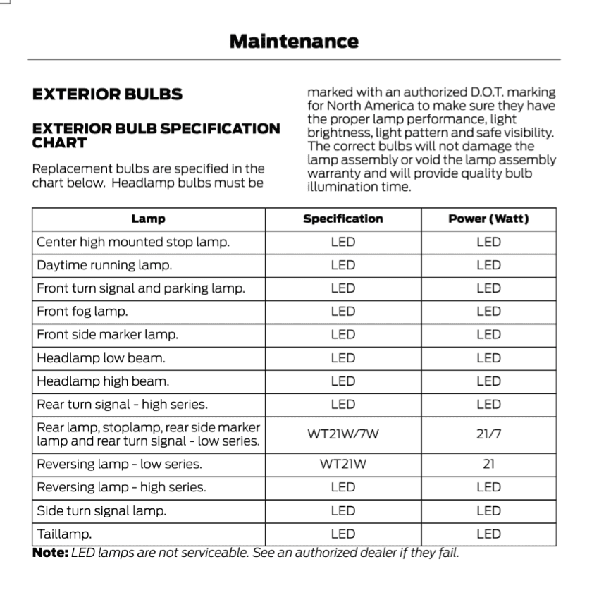

Does anybody know the specific light bulbs (model number / base type / connector type) for the following:
1. Headlight
2. Front turn signal / hazard
3. Rear turn signal / hazard
4. Reverse light
5. Inside map light
6. Fog lights on the metal capable bumper
1. Headlight
4. Reverse light
5. Inside map light
Here's from the owners manual:
https://www.fordservicecontent.com/...d_Bronco_Owners_Manual_version_1_om_EN-US.pdf
Ford Bronco HERITAGE EDITION Bronco Club Screenshot_20240428-170446
All the outside lights are LED if you selected the front signature lights. If you have standard front lights then the rears are halogen bulbs. Which one you getting?
I have the standard front lights and swapped my rear reverse lights for LED bulbs for more light.

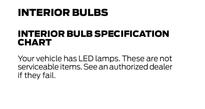

All interior lights are LED:
