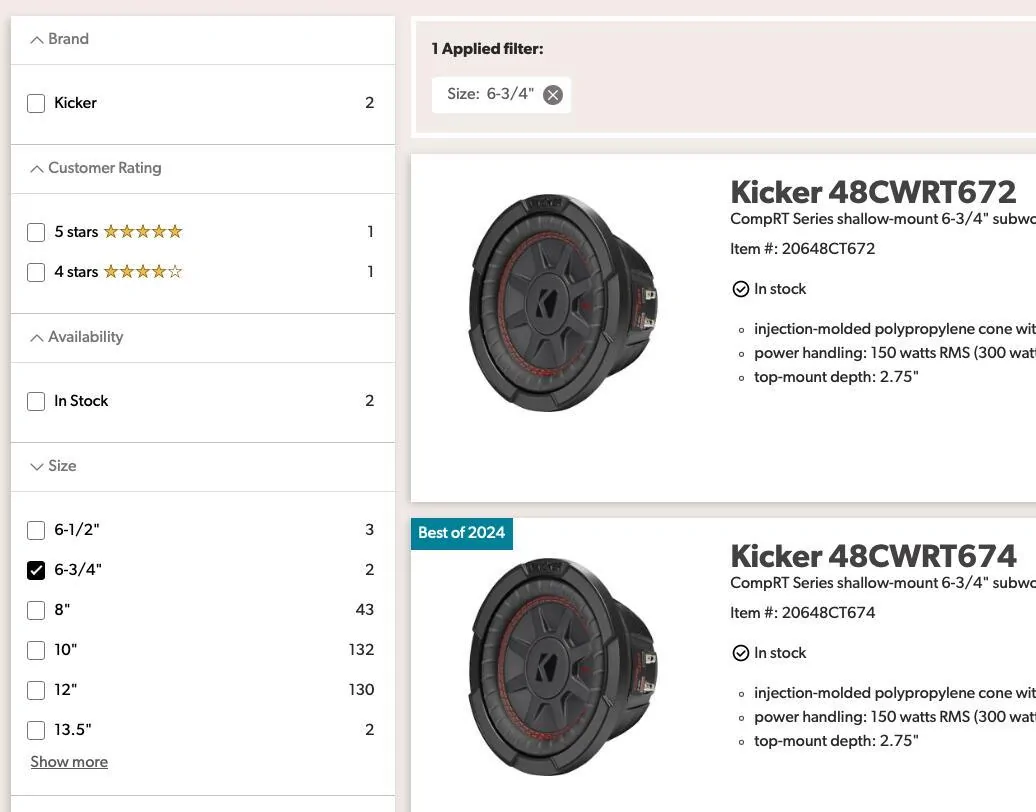

Definitely check out the link to the 2023MY subwoofer megathread at the bottom of my first post. (I would link it here but I'm on mobile at the moment.)
A lot of people are buying a Ford Fusion amplifier, pairing it with a Kicker 6.75" 4Ω subwoofer, and turning it on with Forscan. You'll still have to remove the rear panel in the cargo area to access everything, but that is as close to "plug-and-play" as you are going to get, and it removes a lot of the complexity. You won't get fantastic results as you are essentially installing a factory-like setup. But it is much simpler overall if aftermarket gear is a little too overwhelming.
If you DO want to dig into the aftermarket gear though... feel free to ask questions here and we can help you get going. Or if it's easier you can just send me a direct message.
I have a 2023MY 7 - working factory sub. Is there a plug and play amp and subwoofer without doing forscan? Is this what you are talking about in this reply?
