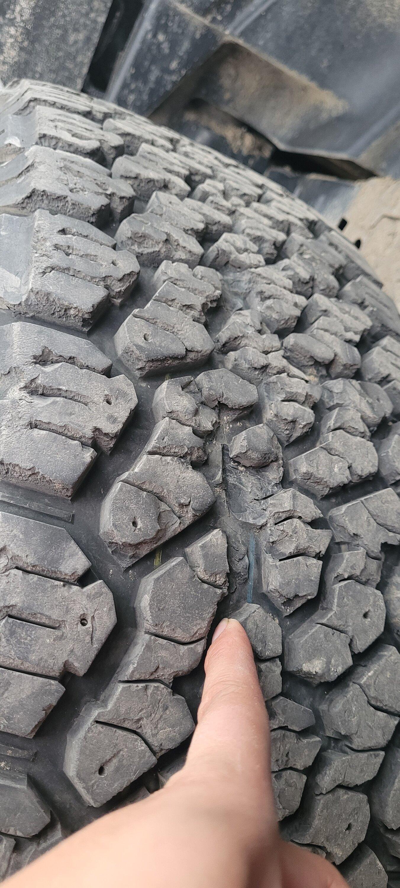

I took my Bronco Black Diamond 2.3L offroading a few times since I purchased it 2 months ago. Last time I went really hard on the trail and bashed some plates. Mostly scratches, nothing dented or broke. One of the obstacles was a 28 degree climb on very loose gravel with narly rocks peppering the ascend. It did a big number on my General Grabbers, some areas have tread litterally ripped out.
I've since been noticing a very low hum/very faint grind at speeds over 10mph. No noise when idling or going very low speed. Noise doesn't significanltl increase when accelerated and is only audible when windows are completely rolled up. When windows are down the road noise completely drowns it out.
What could this be?
I'm thinking of replacing the tires and hoping the noise would go away but worried I might have damaged bearings/suspension parts...

my money is that it is the tires..... Do not know without hearing it.

It’s the tires, when you lose pieces of your tread, it opens up the lugs, which causes the tired act like a mud terrain, which are very noisy

thx 5GeNIDN, uploaded a picture, what do you think?
Yea those tires look a bit worse for wear.... I would suggest those would sing pretty loud. Probably the sound you are hearing. I have seen a worse but those are pretty bad.

yep tires i had chips and a specific speeds it would chatter back lol
