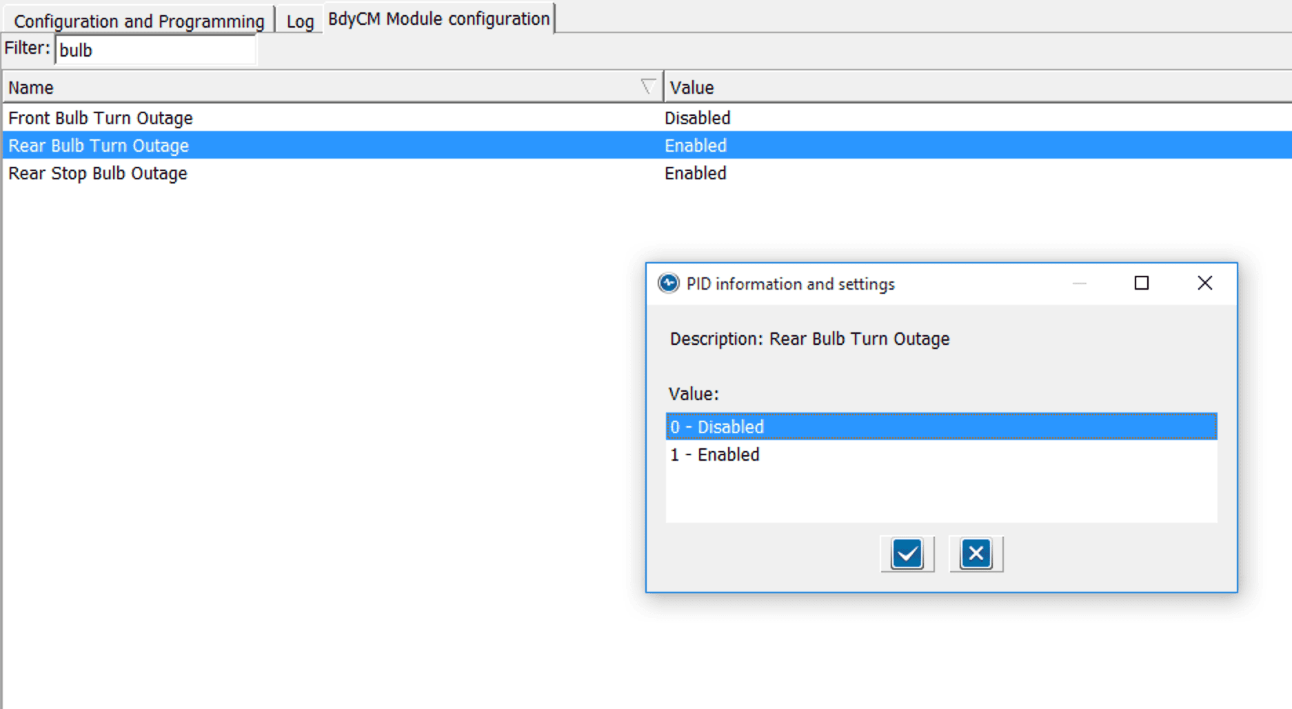

This may be the places to look for in BdyCM
@Jabberwock good luck and report back!
Ford Bronco Hyperflash disable in ForScan? Screen Shot 2021-12-16 at 9.09.53 AM
I was able to eliminate hyperflash last night in ForScan by going into one of the non as built modules. I don’t remember if it was the BCM or which one it was. I’ll go back in today on ForScan and check and I’ll post in the thread about how I did it so others can do the same if they want.
