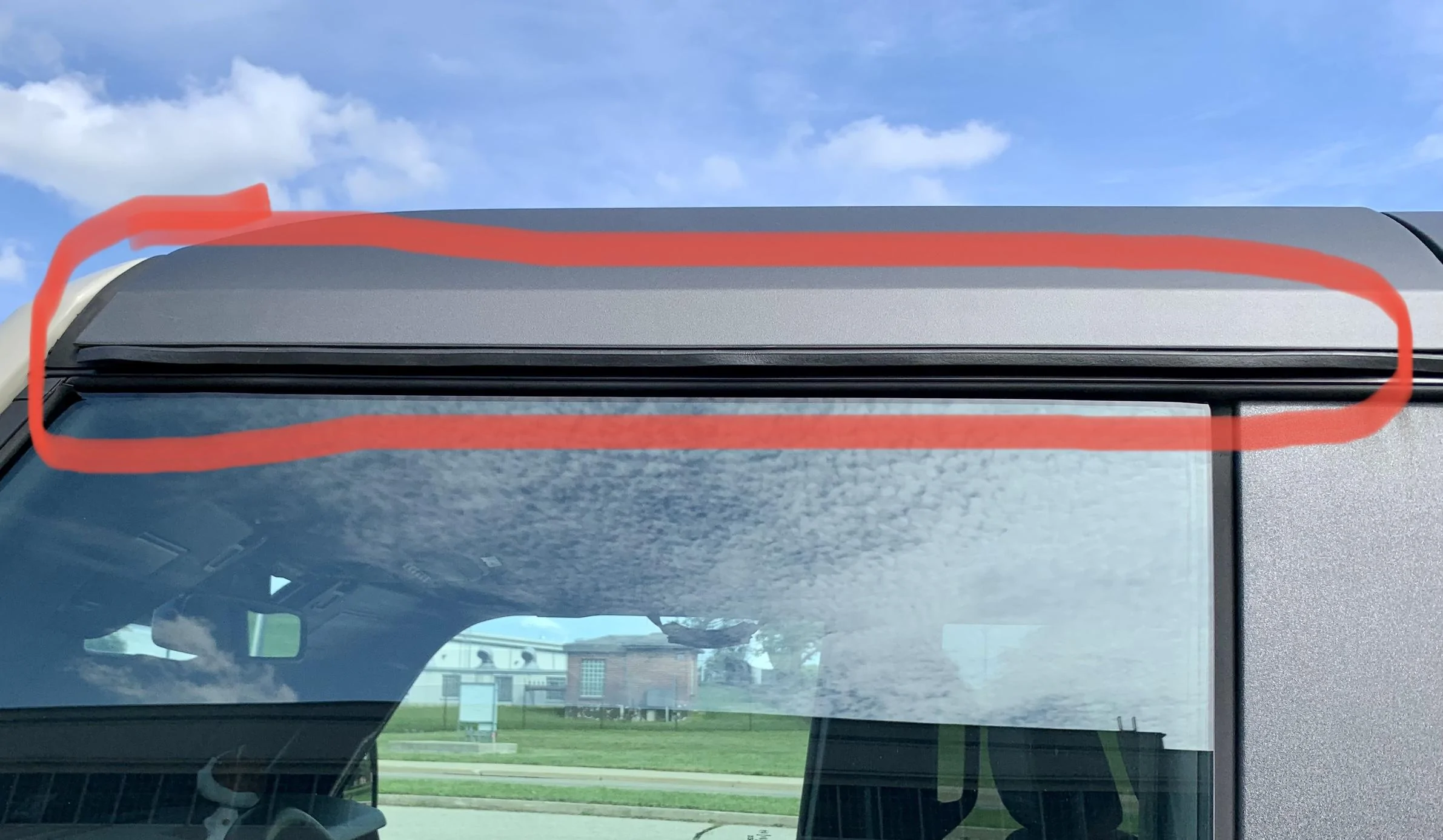

So, we know these are Built Wild... but my wife didn't appreciate it sounding like a hurricane everyday. Who wouldn't want to hear the subtle guitar, bass, drums and notes of your favorite music on the sound system for which you paid? After reading 4+ threads and looking at various modifications people made, I decided to create a single guide here of everything I did to reduce the interior noise. The ideas are not all my own, and credit is due to those individuals whose brilliance came first. Shoutouts to some of those brilliant individuals- jlatigo, mountainbronco, Geo2 and more that I can't put my finger on.
My family says it's significantly quieter now, and I tend to do whatever they say. Hope this helps enhance your ride!
Total cost is about $75. Total install time is ~1 hour if your hard top is already off. If it's not off, what are you waiting for?

Windshield
  • In the front channel, adhere #1 in the Grocery List inside the full length of the channel.
  • Cut 4 short strips of #2 and stick them 2 each, side by side, vertically in the ends of the channel.
  • All of this is hidden with the top on. With the top off, it will either look factory installed or like a small kid used the scissors if you don't cut straight. I have both results.

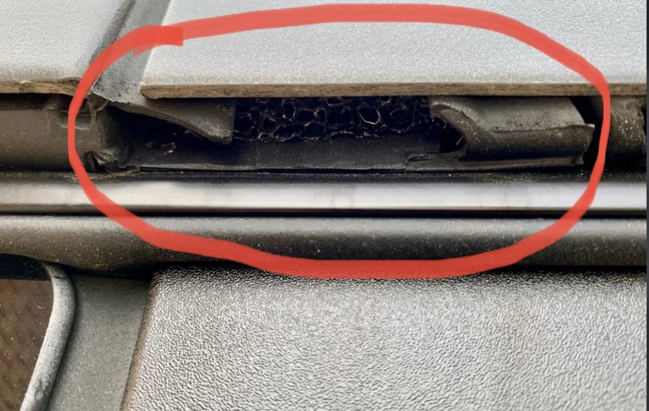

Rear Panel
  • This is the fun one and makes a big sound impact!
  • The picture is probably the best explanation of what goes where.
  • I'm not sure if the top most #3 install is needed- and I forgot to take another picture of it properly adhered. It basically curves along a small section on top. I had some extra stripping, so I used it.
  • The small square of #2 goes on top of a similar, but thinner material that Ford already has in that same place.
  • The Z Shape #4 is great stuff, and I think makes the exterior even look a little sleek (no one ever described a Bronco as sleek, right?). I'd measure this one and cut accordingly- I did 15.5". Adhere it right along the edge of the panel. This helps with wind noise by sealing the gap between the frame of the Bronco and the rear panel.
  • This is not visible except for #4 (Z Shape stripping).
