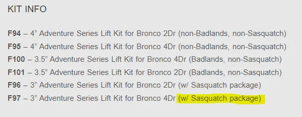

So I was looking up Zone Lift Kits and found the 4" lift are for Non-Sasquatch editions. Is your WT possibly equipped with the 3" Zone lift kit for Sas equipped Broncos? I'm assuming you are counting the 3" lift from the kit and the 1" lift from the Sas package?

So I was looking up Zone Lift Kits and found the 4" lift are for Non-Sasquatch editions. Is yours possibly the 3" Zone lift kit for Sas equipped Broncos? I'm assuming you are counting the 3" lift from the kit and the 1" lift from the Sas package?
Ford Bronco My Wildtrak build - 4" lift on 37's 1658071905198
Correct. It’s the F97. Should have been more clear.
Thanks for the confirmation; I now have the F97 on order for my BL-Sas. I was on the fence with 37s due to rubbing issues but your post helped me decide to get 37s with this kit.

The only thing that fits a Badlands or Wildtrak / Squatch on Zone’s website is a 1” level kit. That lift says for base (i.e. not Badlands or Squatch) suspensions only.
Zone makes a 1, 2 and 3” lift for badlands or Wildtrak.
