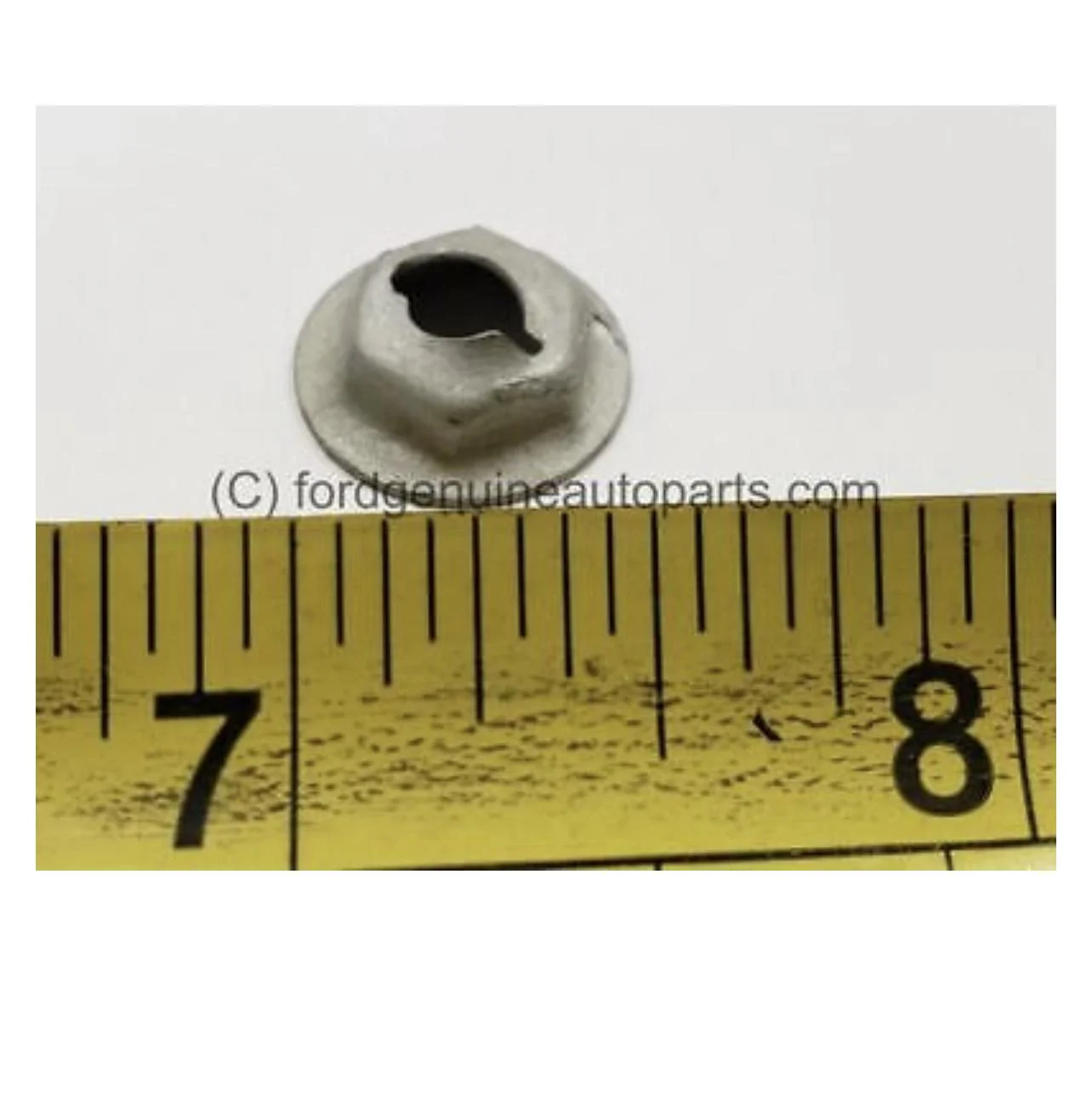

Not trying to plug my store but here's what we found works well and is reversible. The originals are likely sonic welded or they've got a special jig with a heated iron. These nuts are available aftermarket and likely a lot cheaper than OE.

Screw on like a nut and cut their own threads. I want to say they're for a 5mm post but don't want to swear to that.

Found a pic online, you think it would just push onto the stakes and hold it in place?
They self thread when installing. If you look at the pic in the link, you can see a light thread cut into the post. They're called speed nuts.

You should be able to get the "speed nuts" at any hardware store or auto parts store, just take one of the letters with you to match up correct size.
