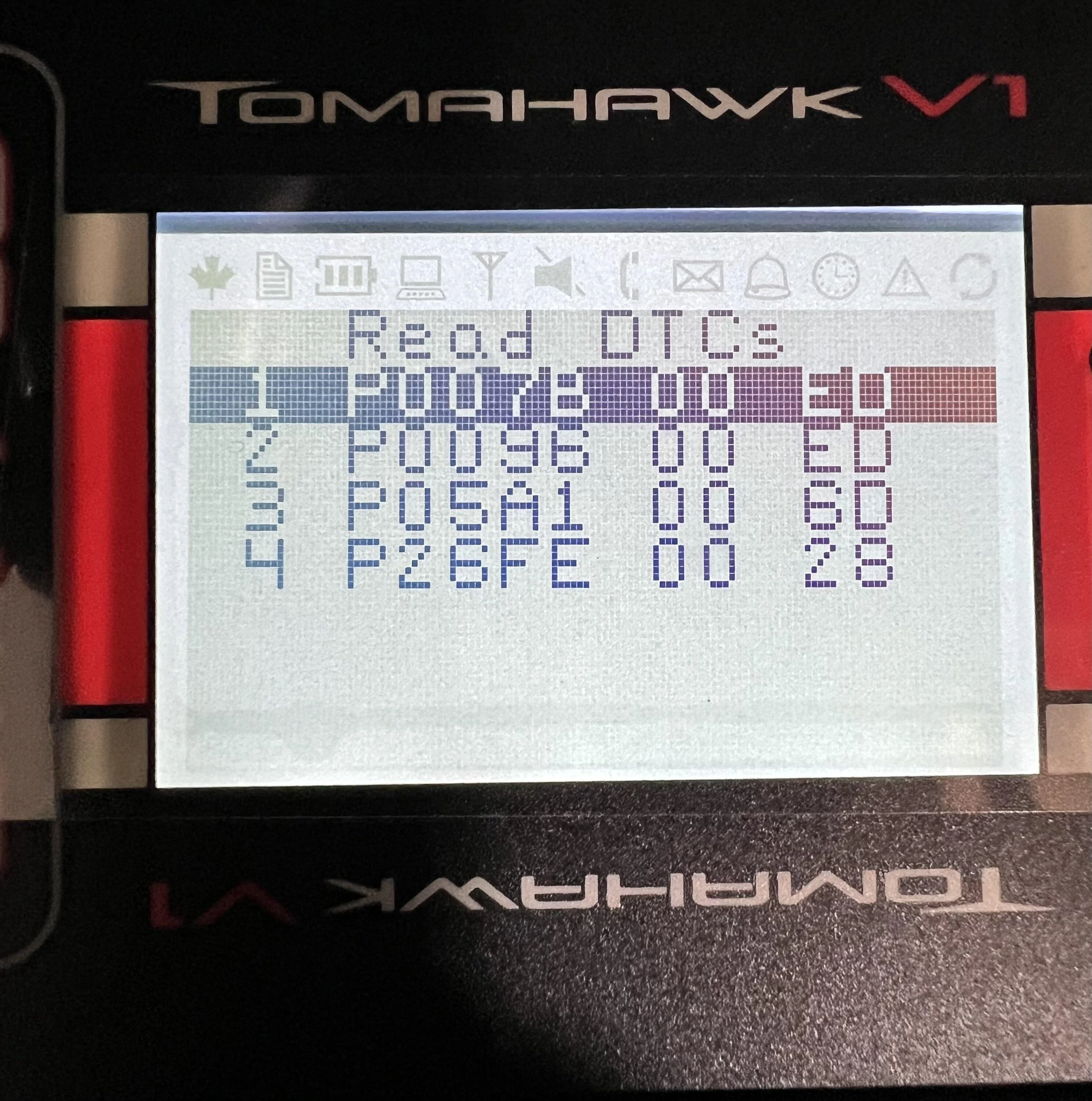

DoubleBB
May 1, 2023
Denver
Bronco Raptor
I've been having the same problem. These are the codes that I get.
Ford Bronco Possible issue with Whipple Intercooler and Tune IMG_5909
