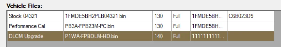

Just checked mine out - here's what I see
Ford Bronco Procal 4 update 1707436018082
It now asks if I have upgraded my FDU to a M210 or Dana Super 44 (I have not) when it goes to get the latest tune update.
