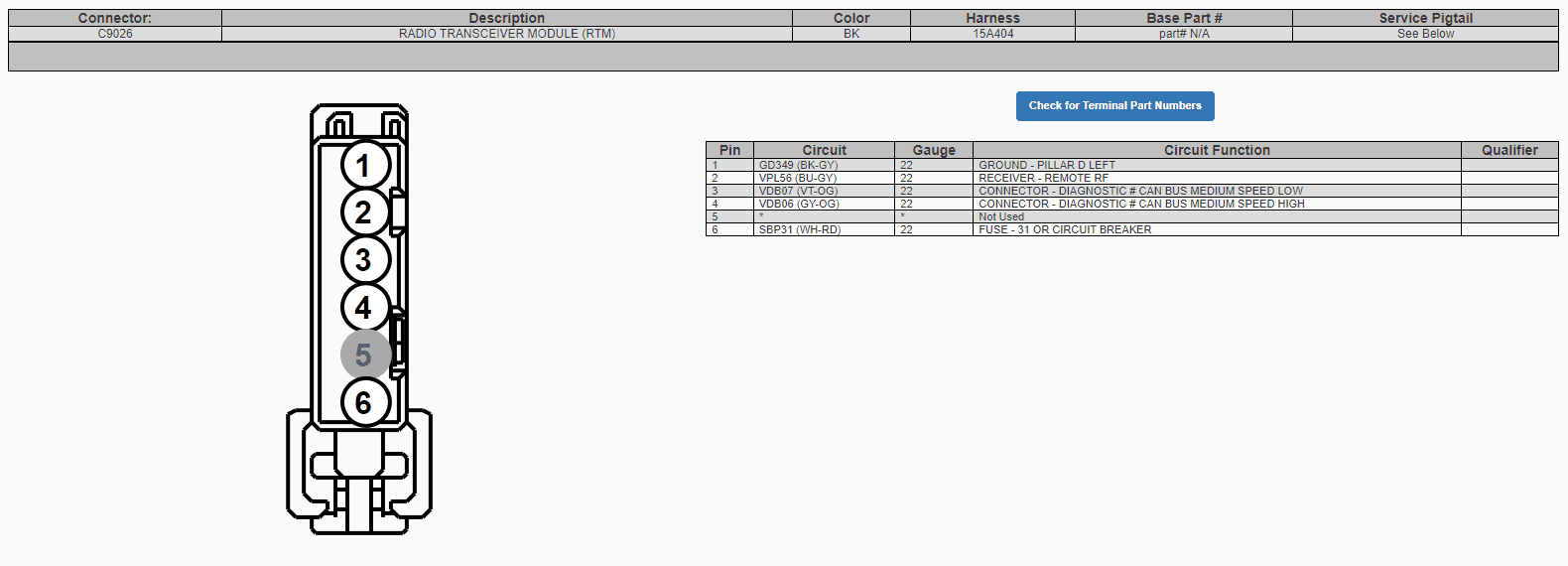

So I have already turned off communication with Ford in the Sync 4 infotainment settings (not looking to make this political or conspiratorial - just technical). Still there is a SIM card and modem buried behind the infotainment screen that could still be sharing my private driving data with Ford and data brokers. I have searched the 6G forum to answer to what I am asking without specific result. Fuse 20 under the dash is for the "telematics modem" but it also states in the owners manual fuse 19 is "ignition switch. headlamps". From the fuse diagrams I have been looking at fuse 19 and 20 seem to be integrated into the same three prong fuse, so if I pull that three prong fuse 19/20 I will disable the telematics modem and the ignition and headlights (no surprise Ford would make this hard). Am I correct on this? Is there a work around on pulling that fuse and maintaining ignition and headlights?

Fuse 31 may kill the radio transceiver module. Probably still going to continue to gather data unless you pull wires from the connectors and keep the network wires. This may still cause network problems but it's worth trying. Only surefire way to keep data from going out is not to ever have a software update done and somehow wipe the telematics module off-line prior to selling the vehicle.
I think this may also disable the vehicle from starting though. It needs the RTM to send PATS information to the BCM.
Because it will kill the network? I assumed it would just kill the antenna but if it takes down the rear and side antennas too, that won't work.
Well I think the key fob would still receive the signal from the PATS antenna, but then the fob needs to send out a signal to the RTM, which would never happen and prevent the BCM from getting the PATS information from the RTM.
Although starting it in the back up location may still work
I didn't look at individual circuits, that'll teach me.

F19 and F20 are what is known as a Micro 3 fuse, two fuses in one package. So there are two fusible links, one for the lights and one for the transceiver module. Just cut one of the links then plug the fuse back in making sure that the link for the F19 position is intact so your lights will still work.
There's a chance that the Bronco might not like it since the transceiver module talks to the Gateway Module which handles Canbus communications. You might get an error code. So have a spare fuse handy before modifying F19/20.
The Bronco has two interior cellphone antennas. You might have better luck finding them and unplugging the cables to them. Hopefully the Telematics module won't notice.
Keep in mind you want to reverse anything you do when it comes time to sell your Bronco. Otherwise you might kill resale value.

I was able to disable the modem with FORScan. I'm not sure if it keeps the telemetry from working, but I would assume it does.
