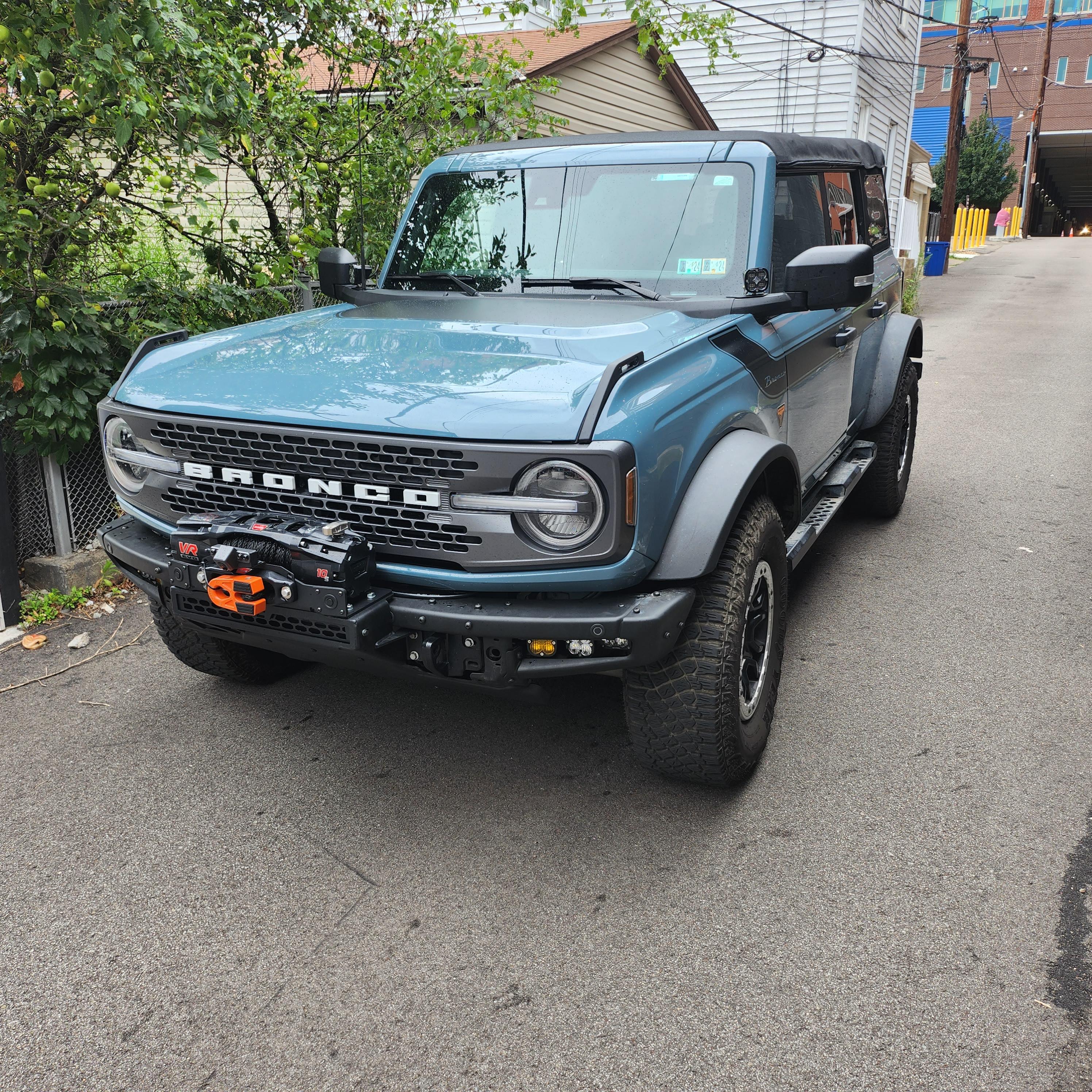

I got my winch finally installed, but I'm having issues with the parking sensors. Any suggestions on how to debug? I got tired of taking everything apart trying to tighten up connections.

What kind of issue exactly?

I get a constant park aid error, and all the ultrasonics are turned off. Plus my dashcam/mirror that gets power through the same fuse started cycling through the camera views. I'm not sure if that one is related. If I hook up to the obdi port, will it tell me which sensor is messed up or will it just say the whole front harness?

I initially had warning and didn't seat the connection to one of the wiring harness. Unplugged, blew out the socket and plugged back in. Immediately went away.

Yeah, next day it started giving me a sensor blocked error and it seems to have gone away today. I think road vibrations clicked it into place.

The easy fixes are the best ones. 😆
