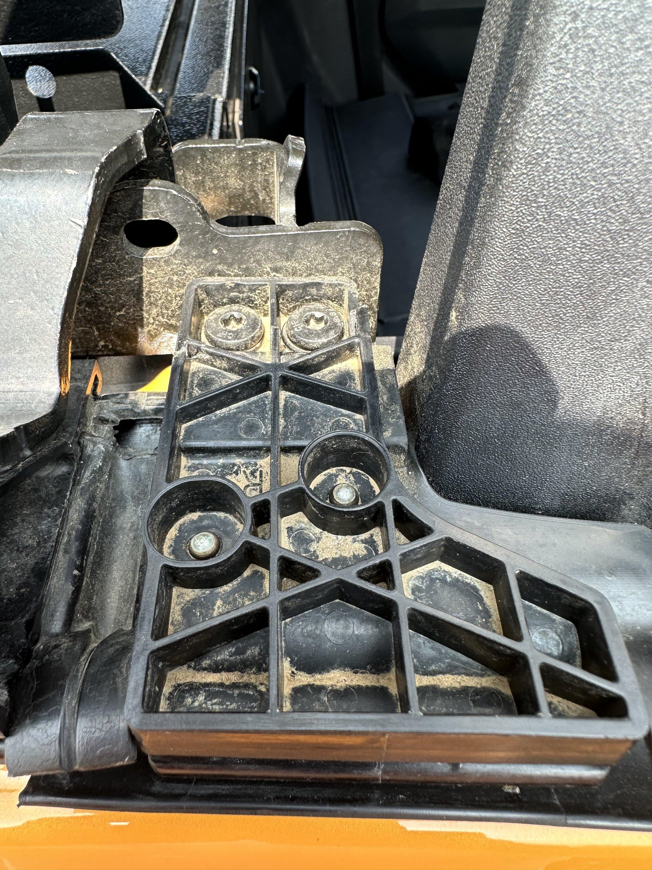

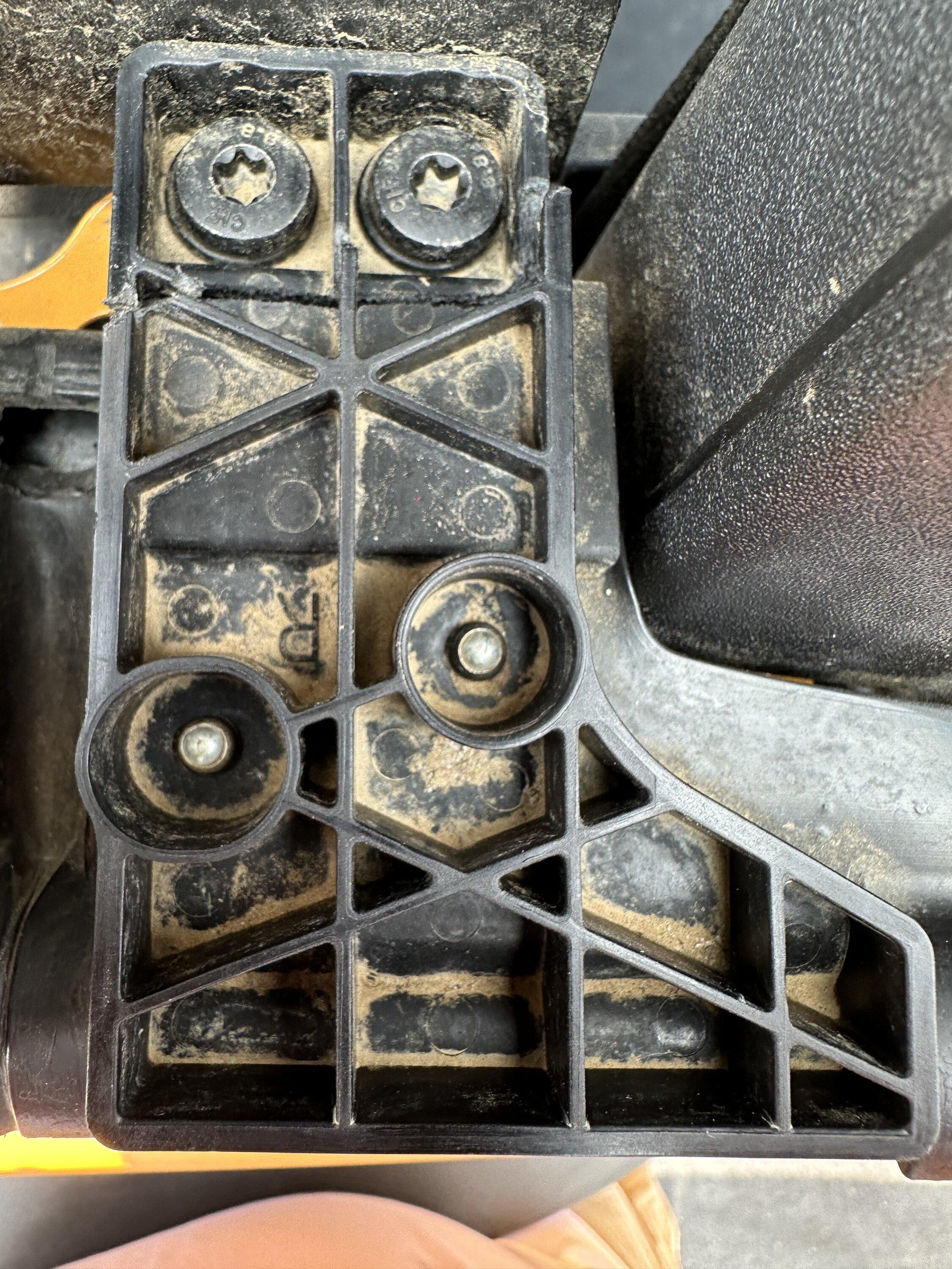

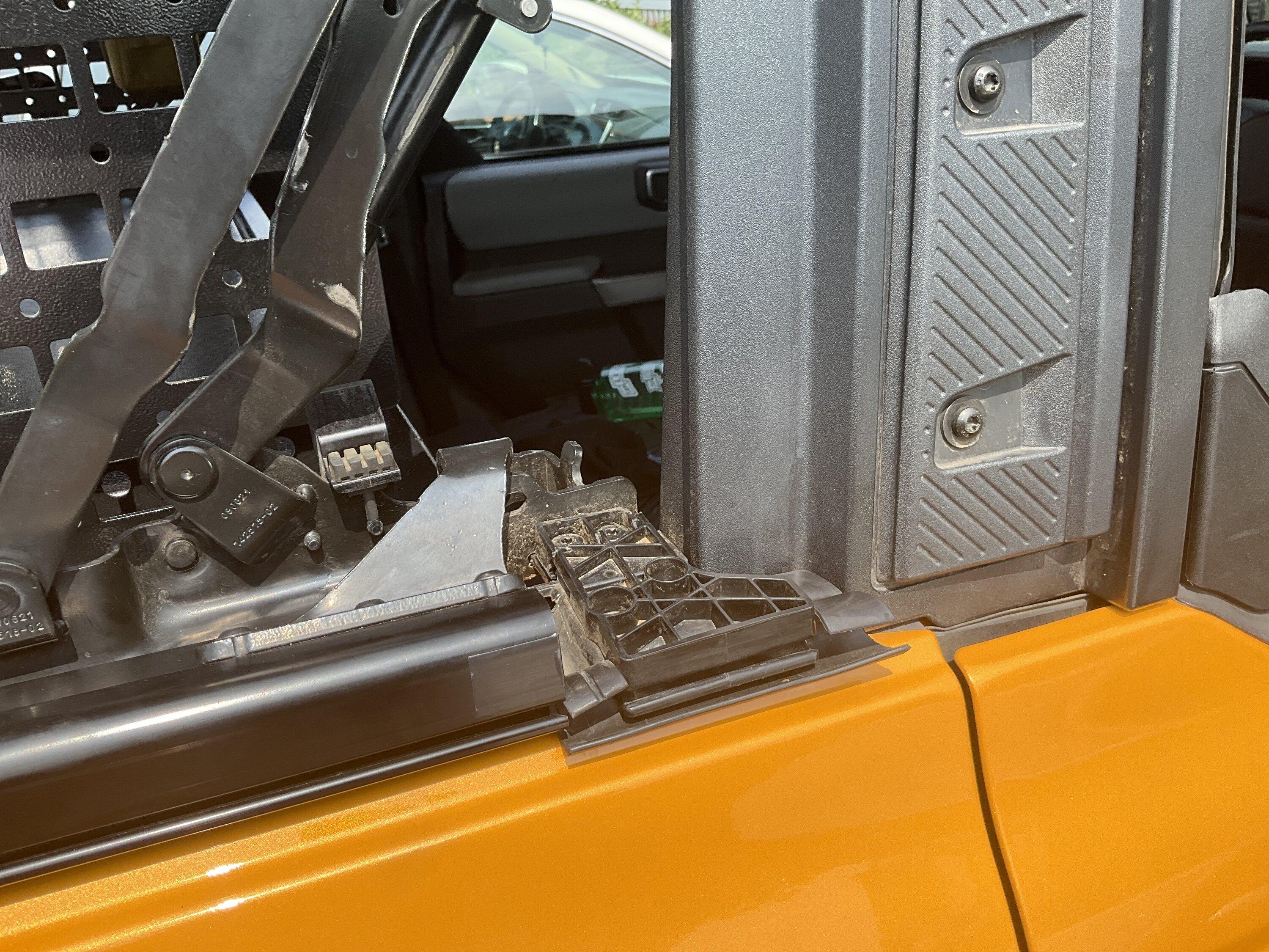

It looks like I broke a piece of my soft top. It is this plastic trim piece that holds the bottom corner of the side window in place. It’s difficult to tell from the pictures below, that this is actually cracked, but it wiggles and trust me. It is cracked looking to find the part number for it. I hope I can order it separate from an entirely new soft top.
Ford Bronco Soft top - side window lower retainer part number IMG_3929
Ford Bronco Soft top - side window lower retainer part number image
Ford Bronco Soft top - side window lower retainer part number IMG_3930

So, to close the loop on this -
To replace this part
- that is the correct part number for the passenger side
- there are 2 rivets that attach that to the underlying rubber gasket/skirt/piece. The skirt and the rivets are not included in that part number.
- The rubber skirt - in addition to the 2 rivets that attach to that part - is attached to the soft top frame by a single screw or rivet. Havent got that far yet, it looks like it could be either. Have remove the soft top and tilt it up to see if its a screw or rivet to the frame. Will post here once i have time to find out for certain.
