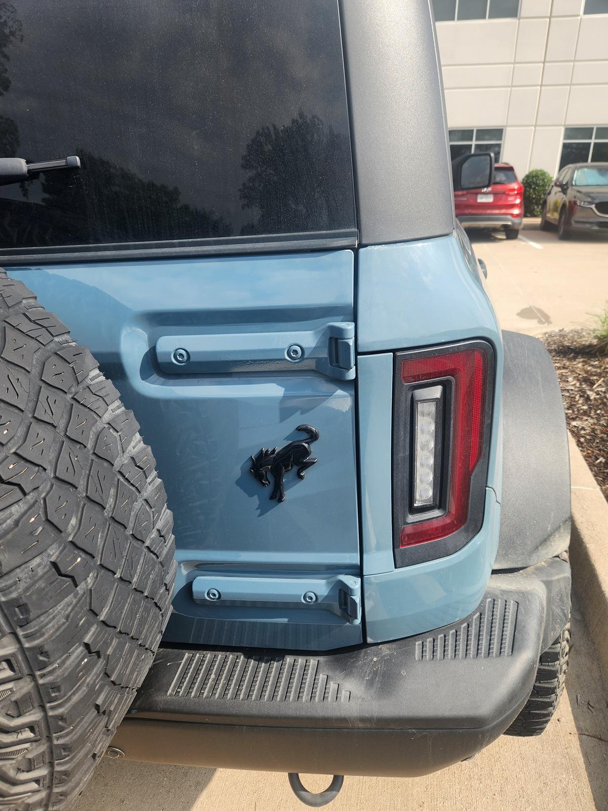

I wouldve noticed so this isa current development. There is not much gap where the tailgate shuts. Can I adjust it my self, take it to the body shop, take it to the dealer? I am out of the 3/36.

Got a shot of the passenger side?
Yes, it can be realigned. It can be a royal pain in the rear and, unless you get lucky, almost needs a couple sets of hands. There’s three different adjustment points depending on how it needs adjusted.
If you can afford to, taking it into a body shop isn’t a bad option and shouldn’t take them long.
It could also just be that little piece of trim that sits next to the taillight, and the upper and lower pieces look about right. I think that piece has a couple of little screws on the inside

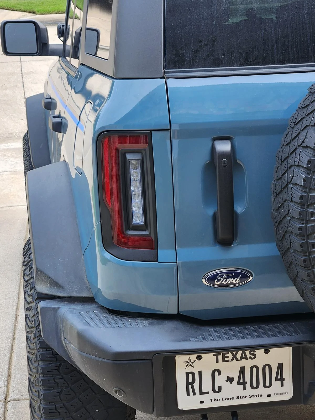

My picture isnt loading... I will upload soon...but it looks fine
Ford Bronco Tailgate Alignment 1000005162
You can do it yourself but will require removing the passenger taillight to get to the interior latches. Hardest part is getting the taillight and trim pieces off. Many videos out thereto help.
Ive remove the taillight and trim before, the hardest part will be getting the extra set of hands :)
ETA:
Pretty sure it is due to the oracle light, or the trim piece that was mentioned before
I got new wheels and it was aligned fine. I put the oracle lights in and I took a picture of a failure of the light and noticed the misalignment.

I think in your case, yeah, it's the Oracle light and that trim piece, but if your shot of the passenger side pops up we can see a bit better.

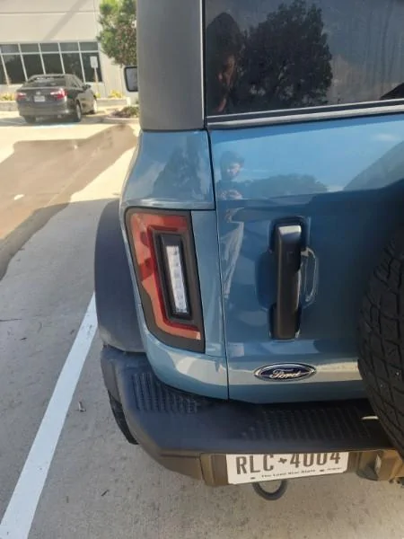

I reinstalled the oracle light. Trimmed a little more per oracles instructions.
Ford Bronco Tailgate Alignment 1000005174
That doesn’t look half bad there!
