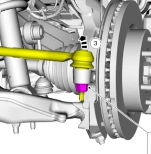

Outer Tie rod end46 ft lb
Ford Bronco Torque Spec Reference List 1000001127

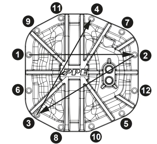

Rear diff cover boltsStage 1: 177 lb. In
Stage 2: 25°

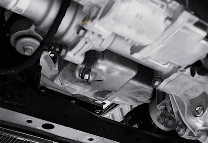

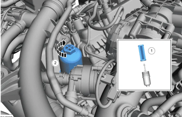

2.7 Oil filter canister18 ft lb

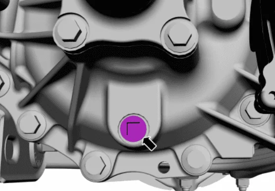

Front/rear diff fill bolt21 ft lb / 20 ft lb
Ford Bronco Torque Spec Reference List 1709907715445

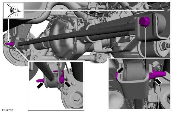

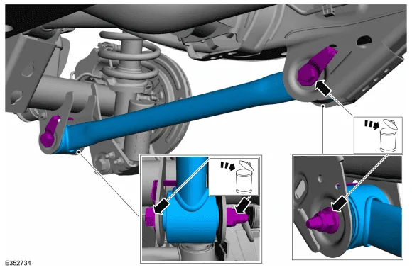

Trailing arm159 ft lb
Ford Bronco Torque Spec Reference List 1709822018958
Ford Bronco Torque Spec Reference List 1709822088529

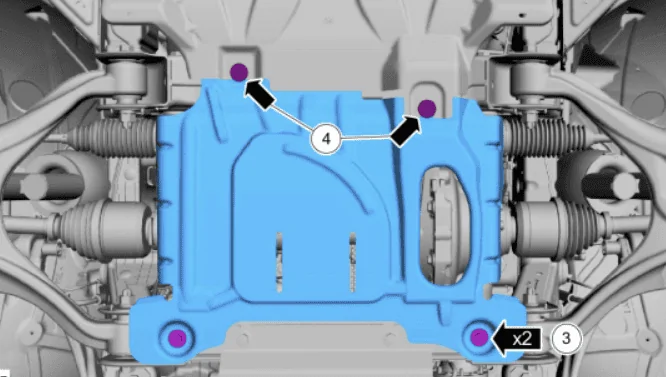

Skid plate bolts22 lb.ft metal, 124 lb.in plastic

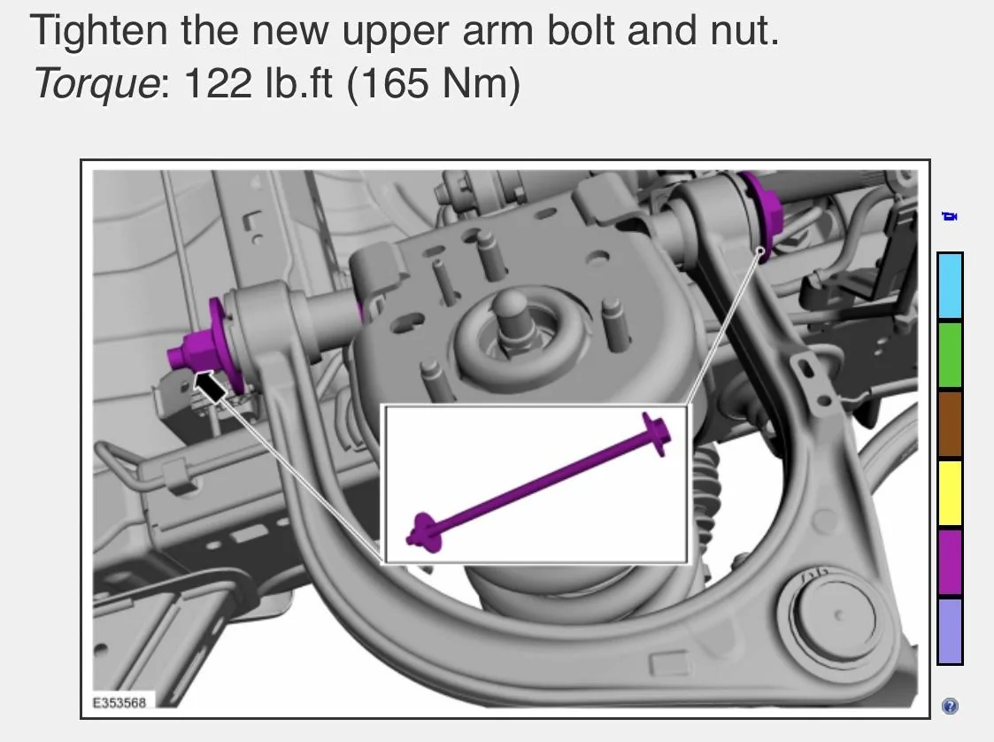

Upper control arm bolts122 ft lb

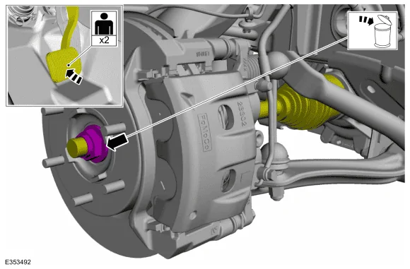

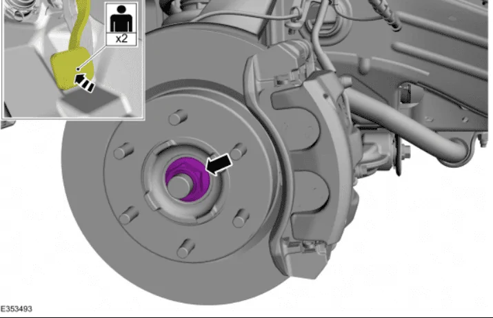

Axle Nut221 ft lb

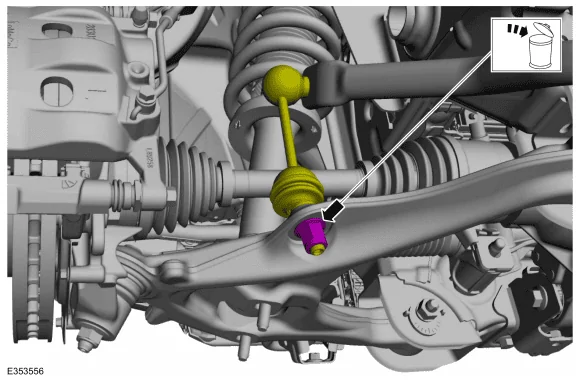

Stabilizer bar link lower nut122 ft lb

Wheel Hub Nut221 ft lb

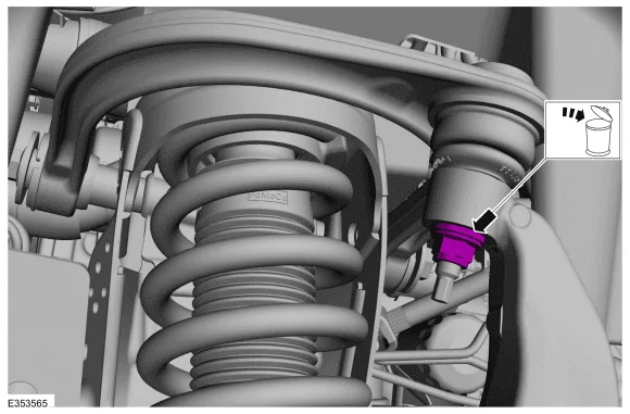

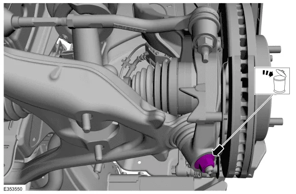

Lower ball joint nut85 ft lb

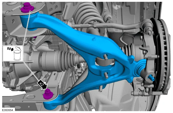

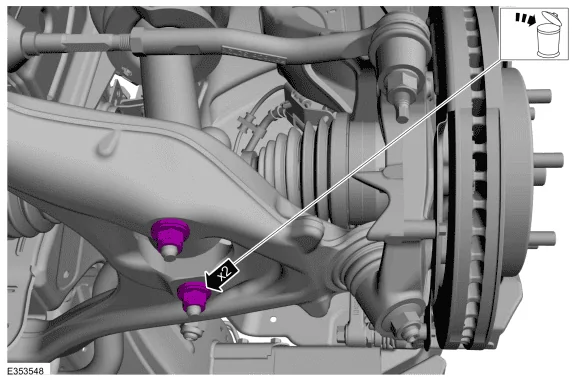

Lower control arm bolts210 ft lb

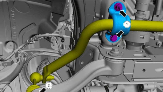

Front stabilizer bar bracket66 ft lb

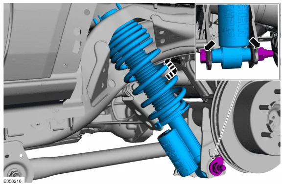

Shock absorber lower bolt and nut350 ft lb
Ford Bronco Torque Spec Reference List 1709822145138

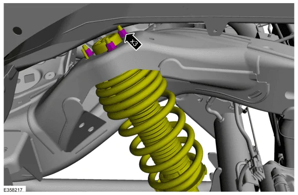

Rear shock absorber upper nut41 ft lb
Ford Bronco Torque Spec Reference List 1709822172277

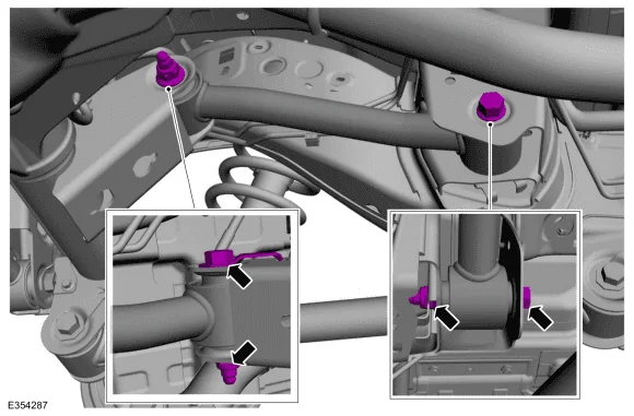

Panhard rod159 ft lb
Ford Bronco Torque Spec Reference List 1709822332180

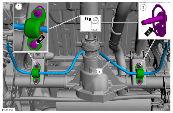

Rear Sway bar30 ft lb
Ford Bronco Torque Spec Reference List 1709822515862

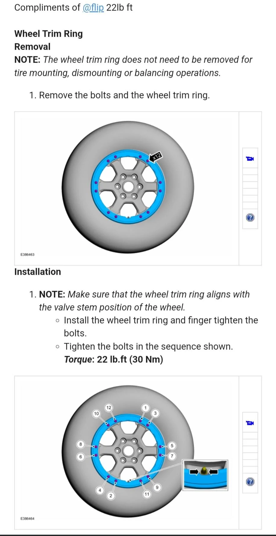

Beadlock vanity ring22 ft lb

Lower control arm210 ft lb

Axle Nut221 ft lb

Wow - 350 ft-lbs to change a shock. My torque wrench collection is wholly inadequate. Looks like I may have to invest in an 8 ft breaker bar :p
Heh. My buddy has a high end Porsche. It requires 450 ft lbs (I think) on the single lug nut. He has the torque wrench for it. It’s huge! 3/4” ratchet heads. Used that on my rear shock mounts. Still hard to torque as it’s so long you don’t get a lot of movement with the Bronco on the ground.

@Crashingken Upper control arm should be 122 lb.ft, not 210
443 ft lbs for center lock wheels on a Porsche AND they need to be torqued while off the ground!

The bash plate below the oil pan has Torque spec for bolts: 30 Nm (22 lb.ft)
