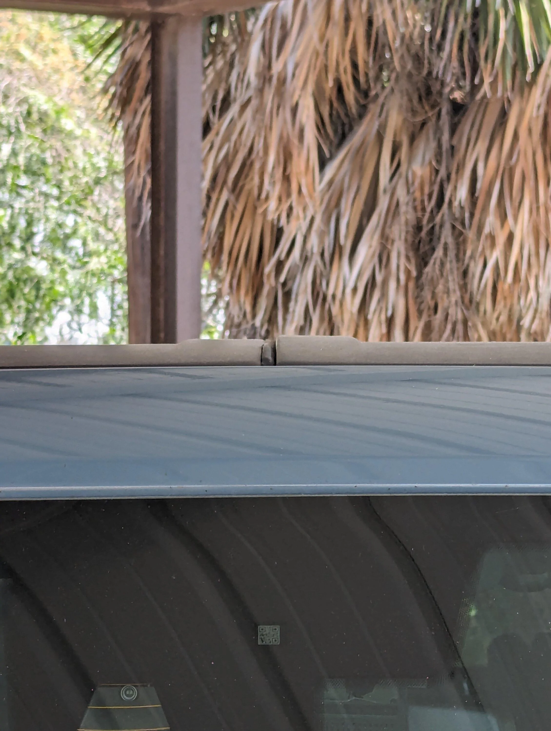

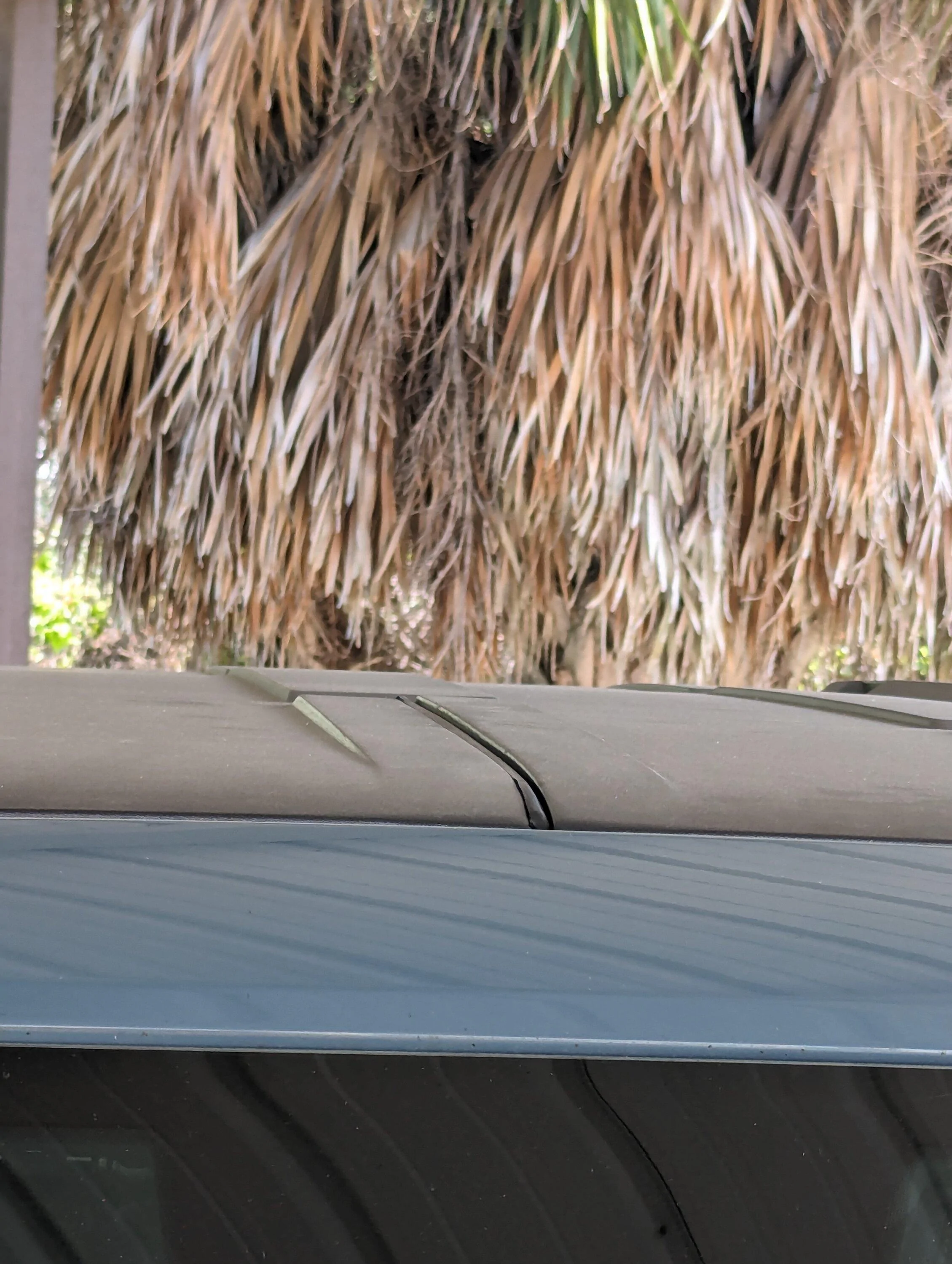

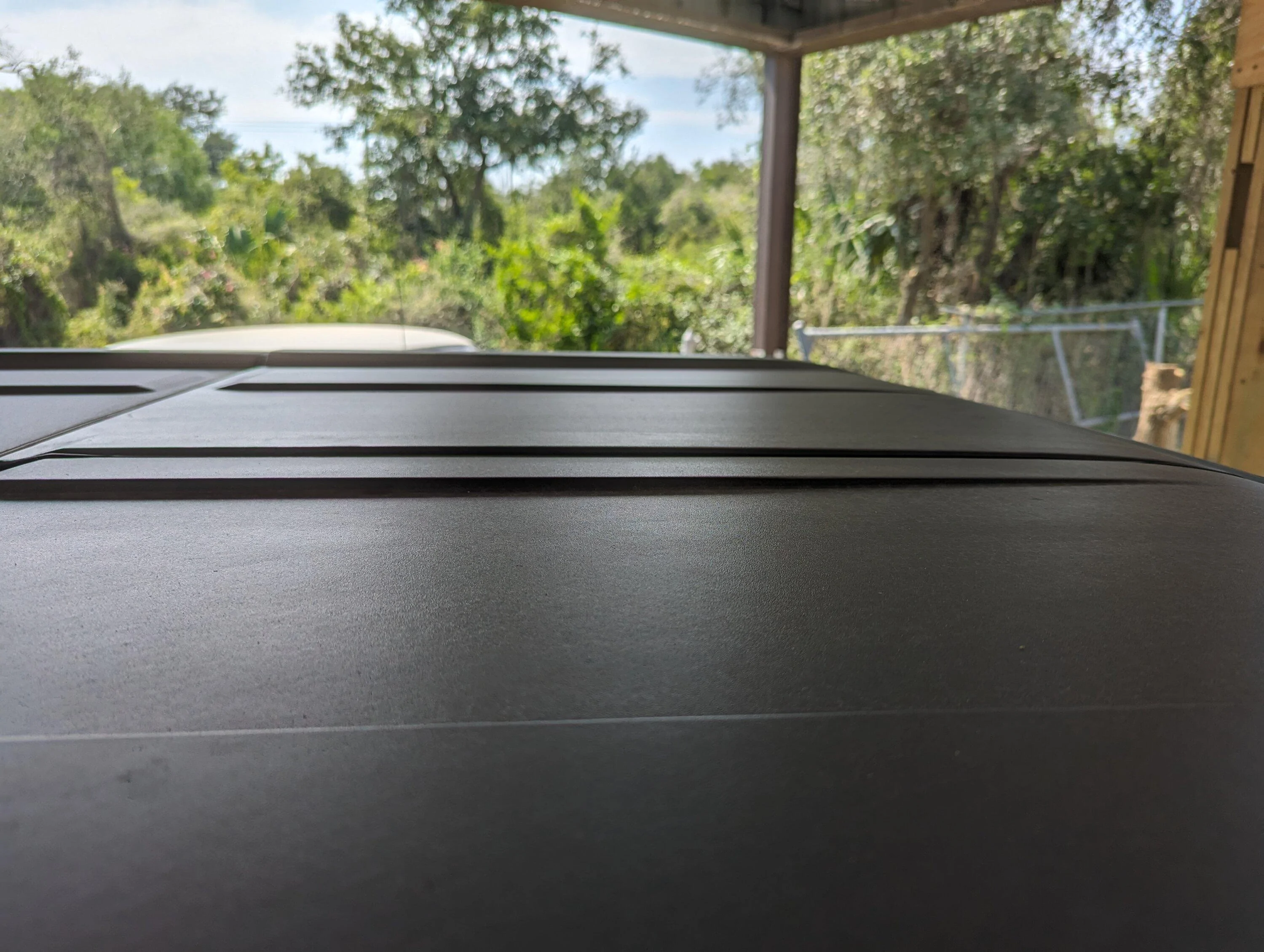

Curious to know how other's front panels fit on their Bronco. Is it normal for there to be some unevenness or are they meant to be completely flat?
Ford Bronco Uneven Front Hardtop Panels PXL_20240509_204151351
My 2023 2 door Badlands is the same...uneven... so I too assumed it's normal too!

You can easily adjust the latch points to fix this. You need to pull down the overhead console to get access to the latch plate bolts. They adjust up/down.
same for my 2023 BD. No water or sound issues.
