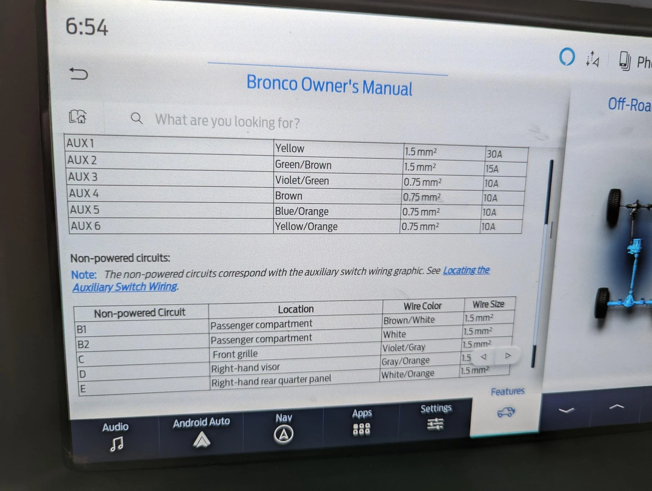

To start off, I'm not an electrician: I know enough to be dangerous. To that end, I'm looking to I stall a pair of ditch lights, each one has a 48 watt draw (according to it's website). Based on that and the 12v from the battery, it would be pulling 8 Amps. Based on the attached picture from a March 2021 post, that leads me to believe that the only switch capable of handling this is Aux 1-3 (unless I were to pull some solenoid/relay shenanigans).
Is this true, or am I missing something?

You are correct. It’s best to give yourself a little headspace when dealing with electrical components, if you don’t plan on adding too many more accessories I would use the 15amp AUX 2, but you’re safe using the 10amp AUX 3 if you want to.
As noted in the diagram, the difference in wire size is the main restriction along with the fuse.
Lights pull a constant draw, as opposed to stereo equipment or a winch. A lot of times people only use the switches to activate a relay ON/OFF so the draw is temporary, in your case electricity will be constant which I why I recommended using the 15amp switch.

That’s an old chart - Aux 4 through 6 have been upgraded to 10amps each so you can use any Aux connection for an 8amp load and it will be fine!
While I want to believe you, do you know where I could find that new chart? Obviously it is an older chart posted back in 2021, but this is also the first I've heard of upgraded wiring. (I also haven't really been looking that hard)
Have you read your owners manual?
Attached in the Bronco installation guide which also illustrates the correct figures.

For future reference for anyone also looking, this is the current chart for a 2023 Badlands Sasquatch.
Bschurr, thanks for the heads-up!
