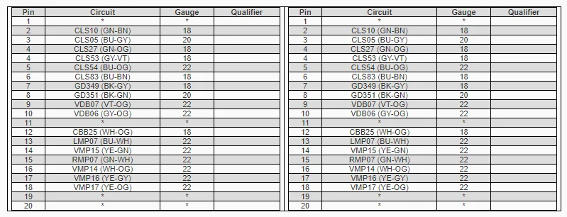

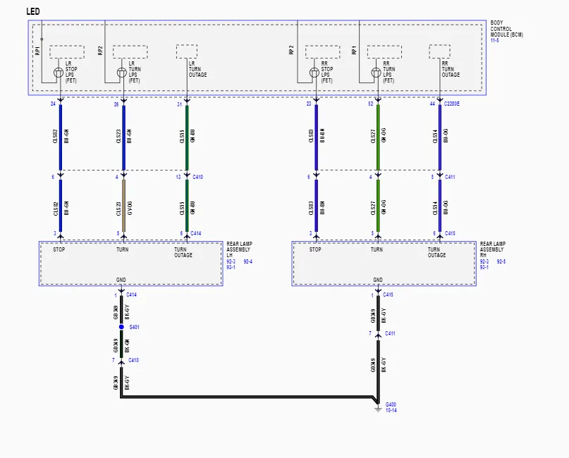

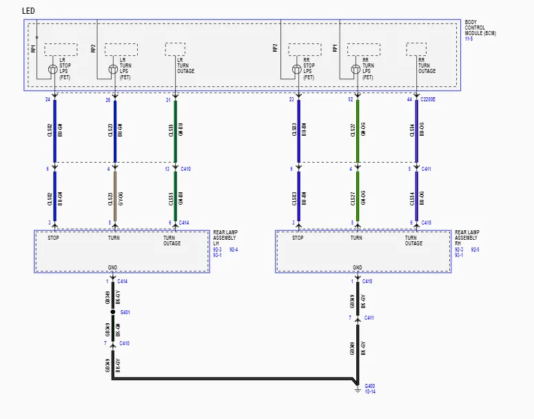

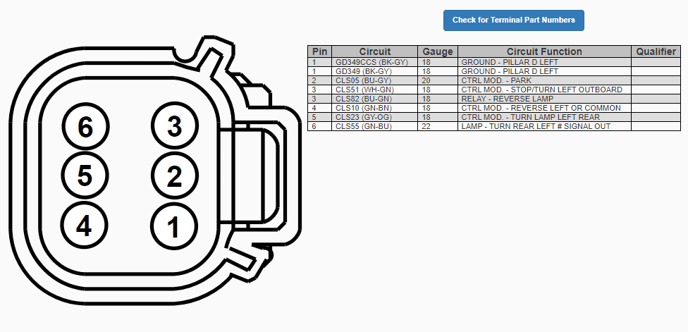

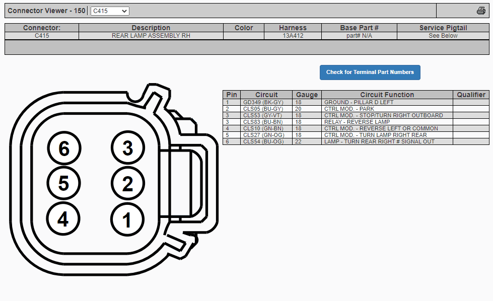

I saw your post of the wiring diagram for the rear led tail lights. But I’m trying to see the pin out for the 6 wire connector. Any thoughts ? I’m trying to wire in
im looking for the pin out for the rear led taillights. I installed a xglow spare tire brake light and need to wire it into the tail lights but I am not sure what wire goes to what , need left turn right turn backup power ground etc. from the 6 pin connectors on both sides. I do not have a tow kit to wire it in to.

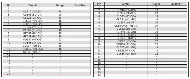

Ford Bronco 2021 Bronco Wiring Diagrams - NEEDED 1664795038218

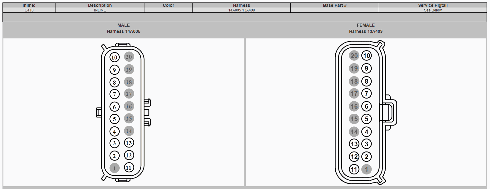

Left inside connector
Ford Bronco 2021 Bronco Wiring Diagrams - NEEDED 1664795087711
Ford Bronco 2021 Bronco Wiring Diagrams - NEEDED 1664795112105
Right inside connector.
Ford Bronco 2021 Bronco Wiring Diagrams - NEEDED 1664795158689
Ford Bronco 2021 Bronco Wiring Diagrams - NEEDED 1664795186317

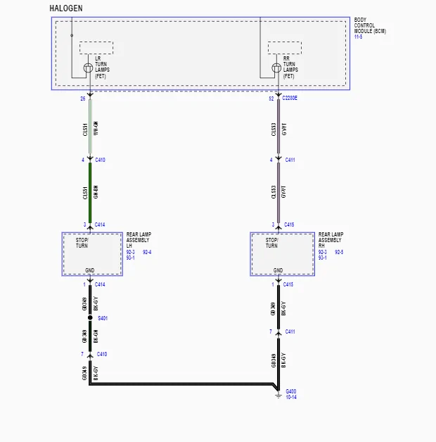

C414, left outside connector behind tail light.
Ford Bronco 2021 Bronco Wiring Diagrams - NEEDED 1664795222416
C415, right outside connector behind tail light.
Ford Bronco 2021 Bronco Wiring Diagrams - NEEDED 1664795259425
Thank You , question, might be a dumb one, but which wire would be the appropriate one to tap into on the turn signal harness for a reverse light? The Xglow spare tire brake light and the appropriate one for turn signal?

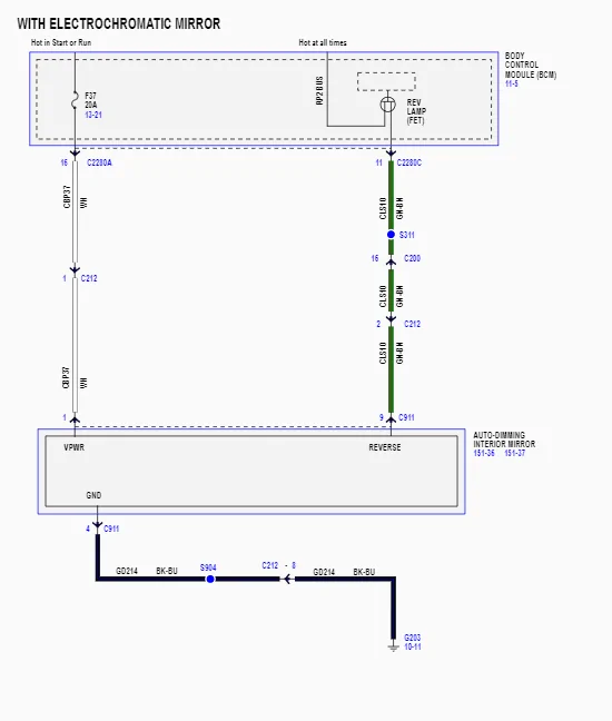

Flip,

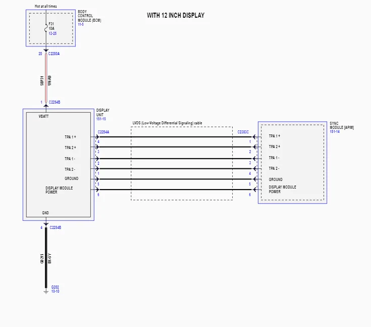

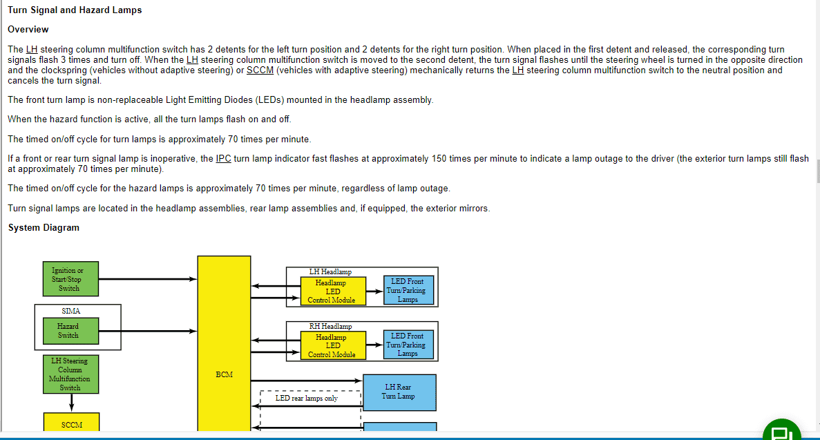

I am trying to hard wire in a radar detector and need 12v ignition power. Am I understanding this screenshot correctly that it should be the white wire plugging into my mirror? I tapped into the white wire and grounded against the frame above the aux switches but have no power to the unit when the vehicle is running.

Flip,
That's the way I'm reading it. I assume you checked to make sure the fuse is good? If so, do you have power there when your headlights are on?
checked the fuse and no joy tried with lights on auto, parking, and full on.

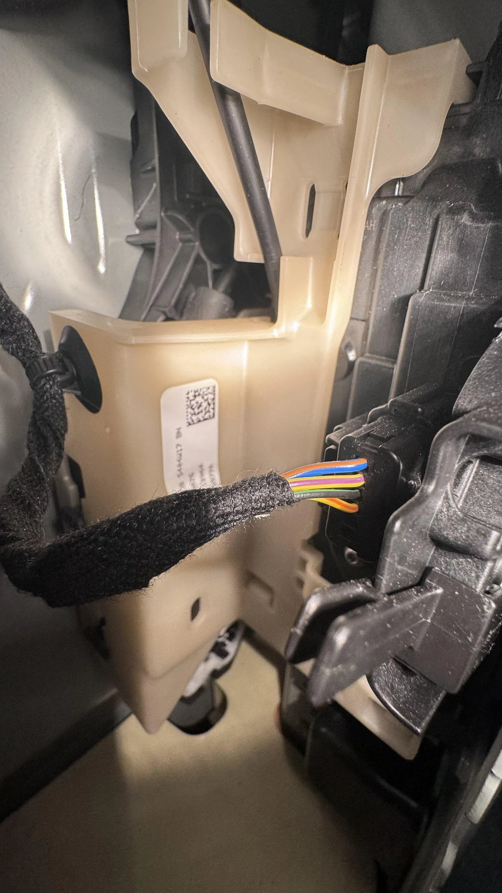

Anyone have one for the tailgate? Looking for a constant on for license plate lights in the gate
Ford Bronco 2021 Bronco Wiring Diagrams - NEEDED IMG_0760

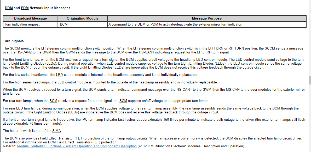

@flip or anyone else :)

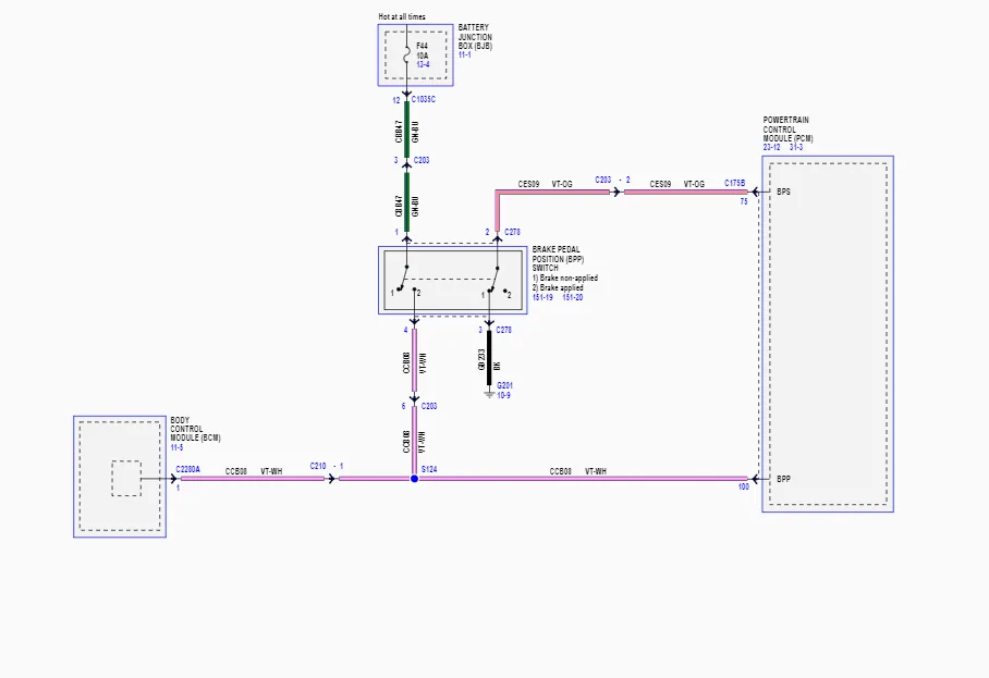

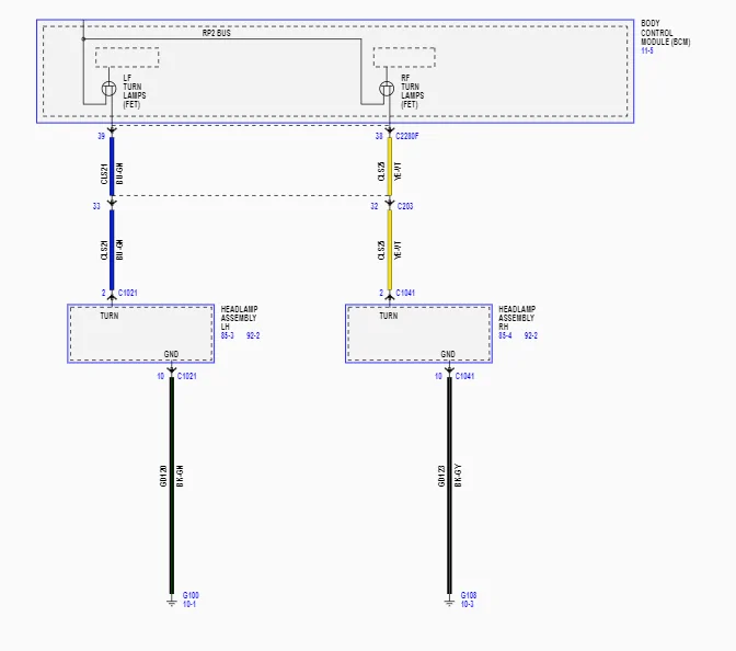

i have been searching and this thread keeps popping up in my search, I am trying to find the wiring between the turn signal switch itself and the BCM, the one at the light already blinks ( cycles power on , and off, creating the blink ) which I assume is controlled in the BCM, but am looking for a constant power if signal is enabled. ( Hoping that the wire between the switch itself and the BCM carries constant and then the BCM tells it to pulse? )
I used the power and ground that were going to the original license plate light in OEM bumper and ran wire to relocated plate on tailgate.
