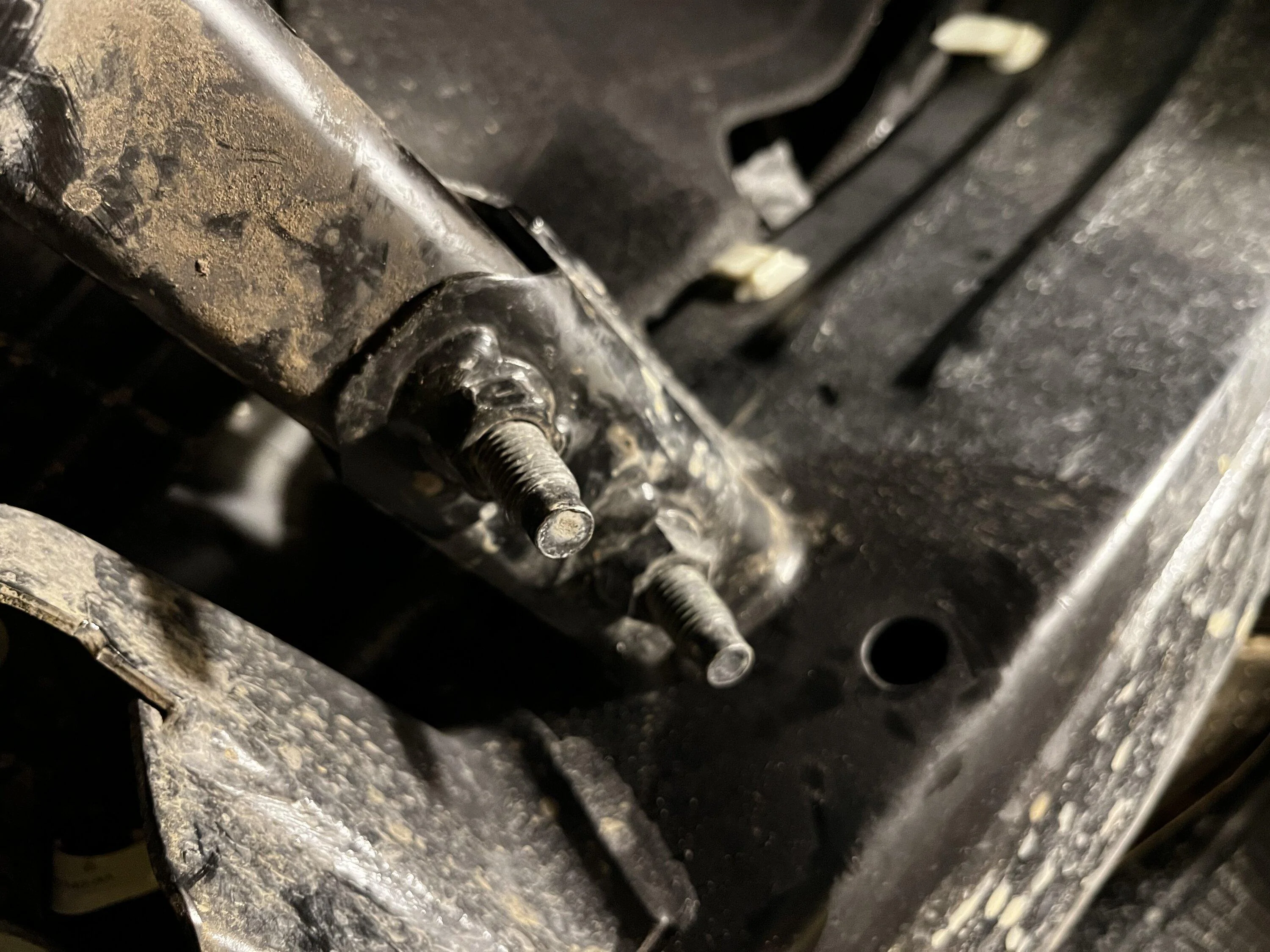

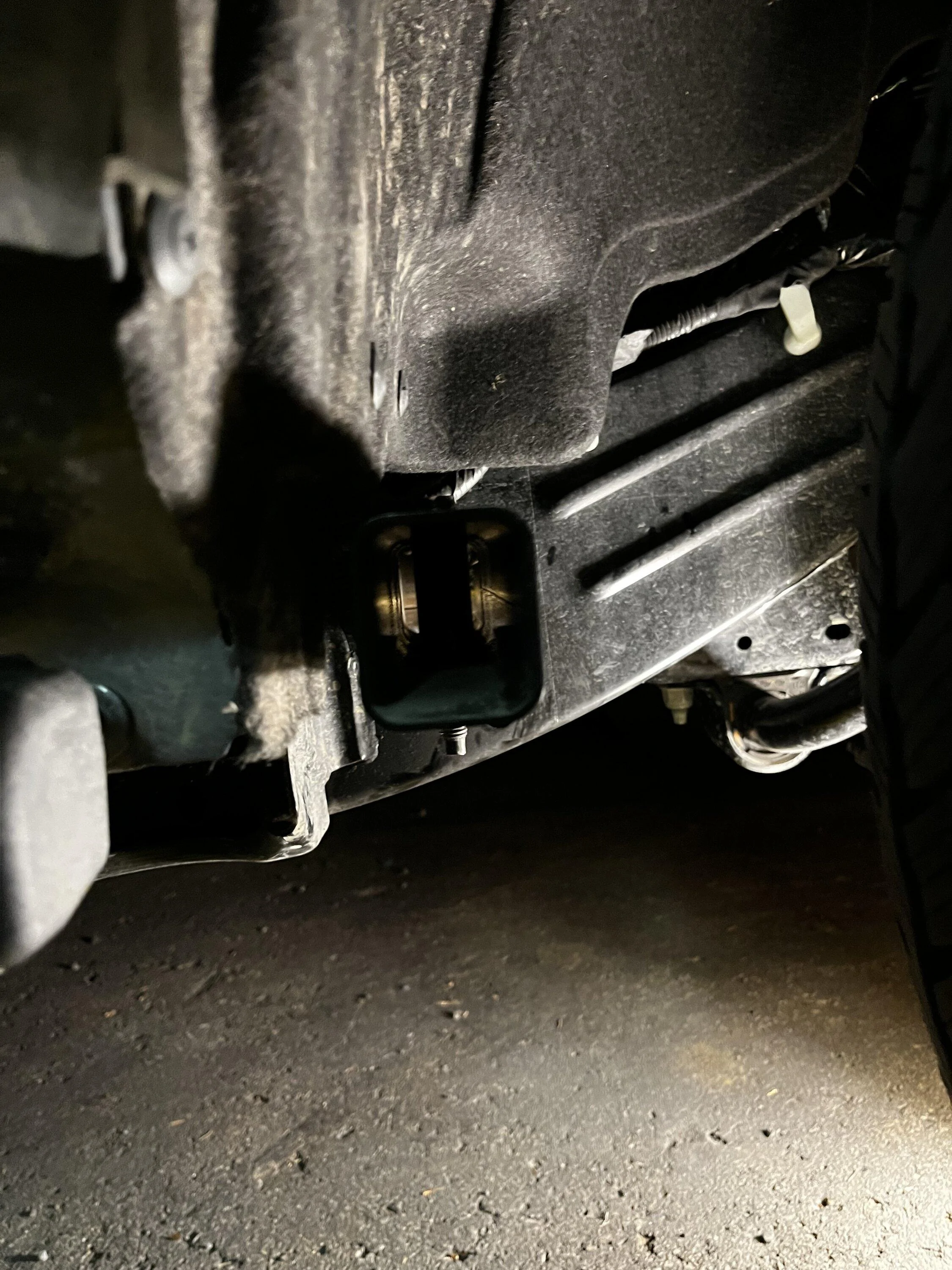

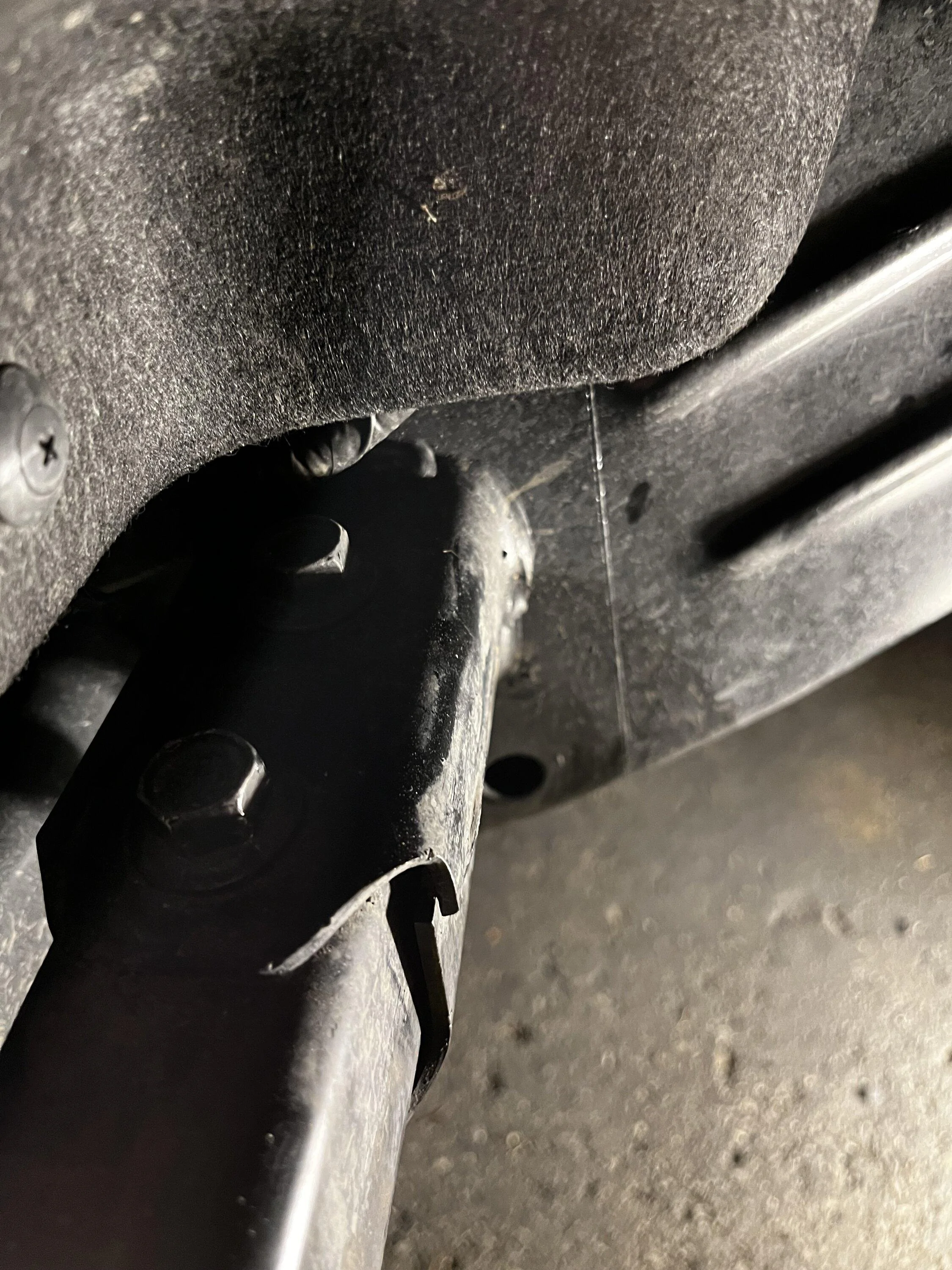

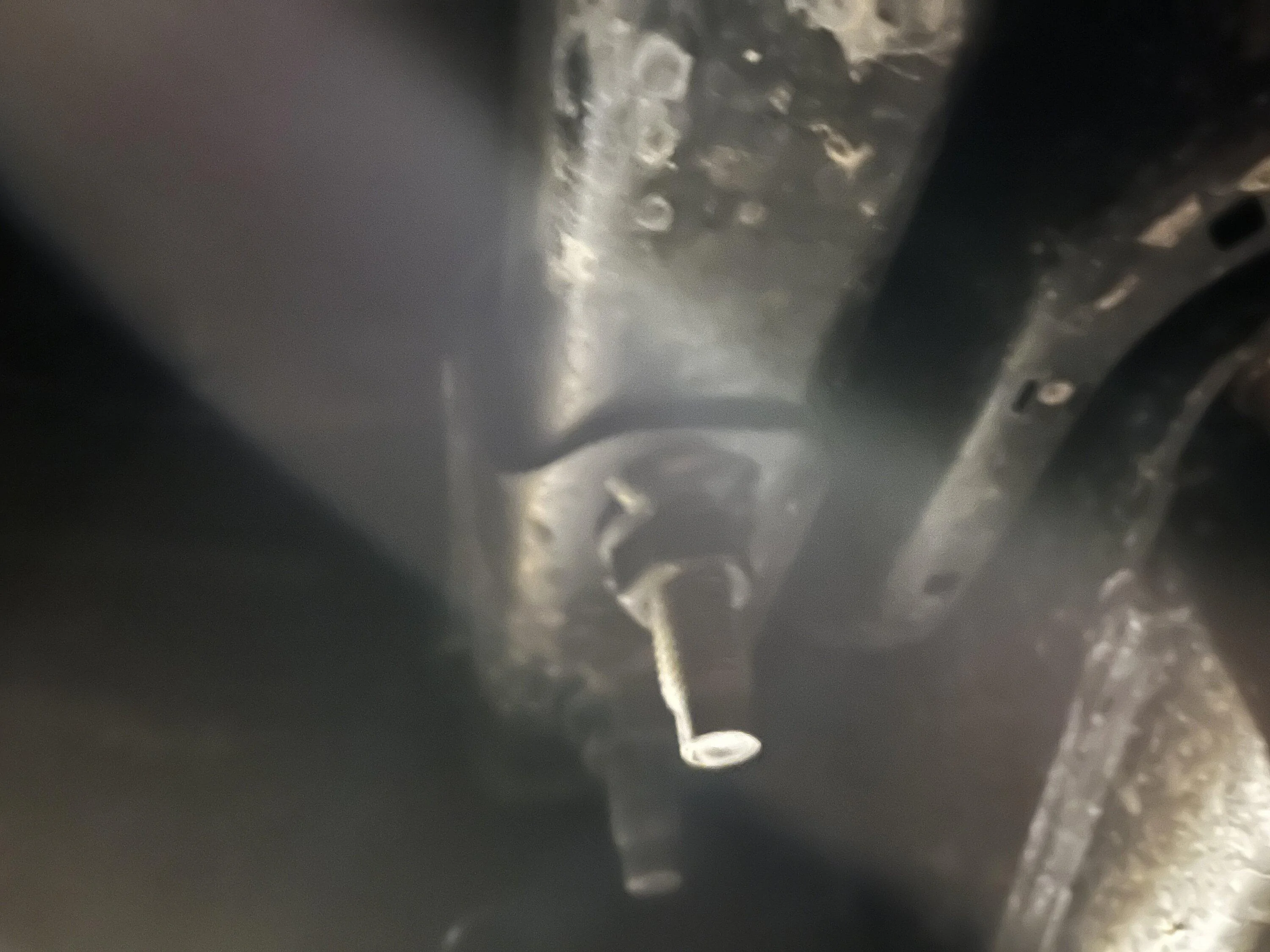

I installed the rear flaps just fine, but when I went to install the front flaps, I needed to remove 2x 5/8 bolts that run through the anti-intrusion/crash bar (see video). I was having a difficult time removing them, and just happened to look underneath, and it looks like the bolt was welded to the bar (see photos).
It’s pretty late here to the pictures might not be the best, i’ll try again tomorrow in the sunlight. Would love to hear from anyone else with a ‘23 to see if your crash bar is welded on as well.

I do have some knock off rokblokz but assuming they mount in the same way. On the ones that I have the arm that supports the back of the mudflap will rest on top of the nuts that are welded into place and then you chase additional nuts over it to sandwich the piece of metal between the two sets of nuts.
Alternatively you can remove the crash bars very easily if they ship certain sets for specific configurations.
There are two bolts on the top side of the rear crash bars that you remove then the crash bar will slide out.

It turns out that I needed just a little more elbow grease than I had (I didn't have an impact drill or a torque wrench). It just so happened that I was visiting my dad out of town the following week and he managed to get them off for me!

The bolts can be removed, the nuts are welded to the bracket. You remove the bolts from the top by turning the bolts, the nuts stay in place.
Impact Wrench is the name you're looking for and never use a Torque Wrench to loosen anything.

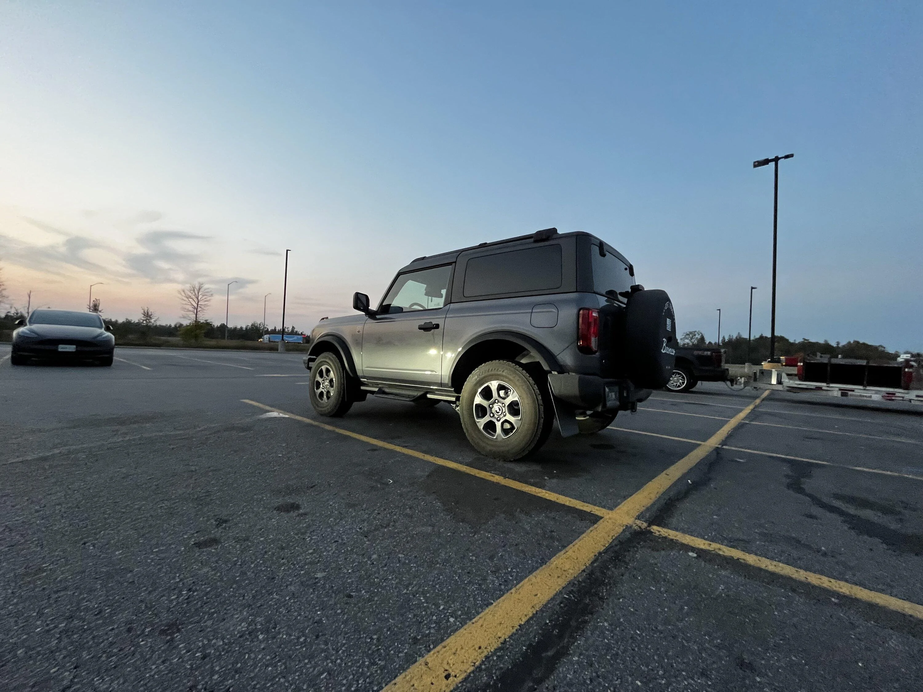

Here’s them on my 23’ Big Bend (Original length) if that helps! I also forgot to take this thread down, but will wait until things die down I guess.

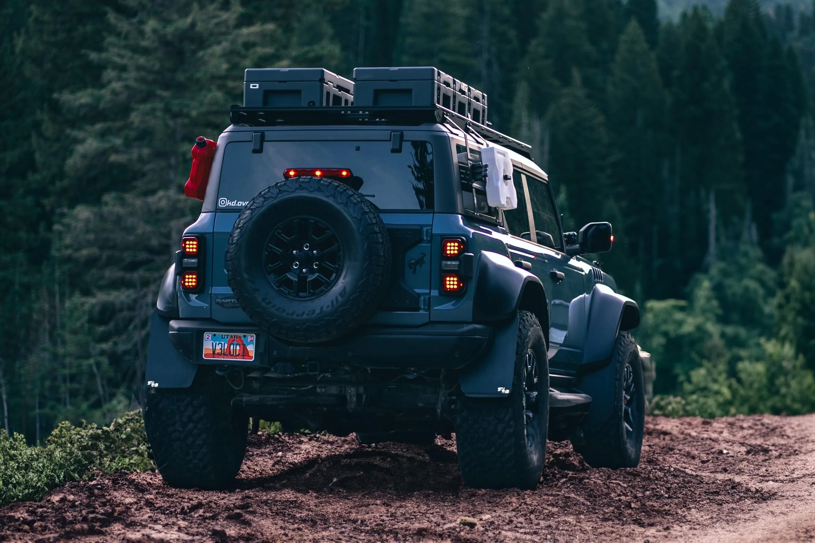

My second set, these fit and look more natural then factory with a better fitment and look then the standard 6g. They can take a crunch well and are a proven solution.

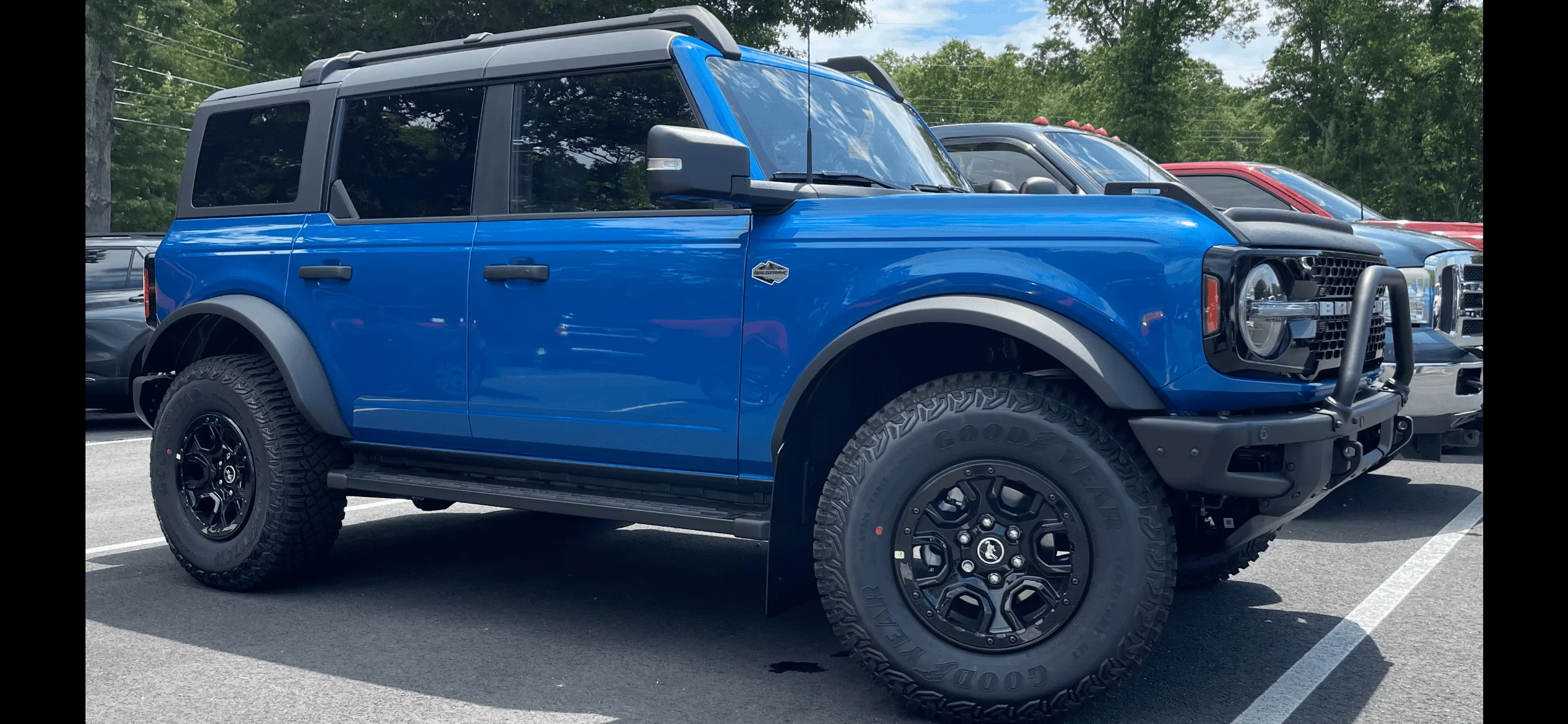

Here’s a picture of the XL set on my 23 Wildtrak. I haven't had any issues with rubbing or clearance. I installed them prior to leaving the dealer - day of purchase. Didn’t want to drive until I had them installed.
