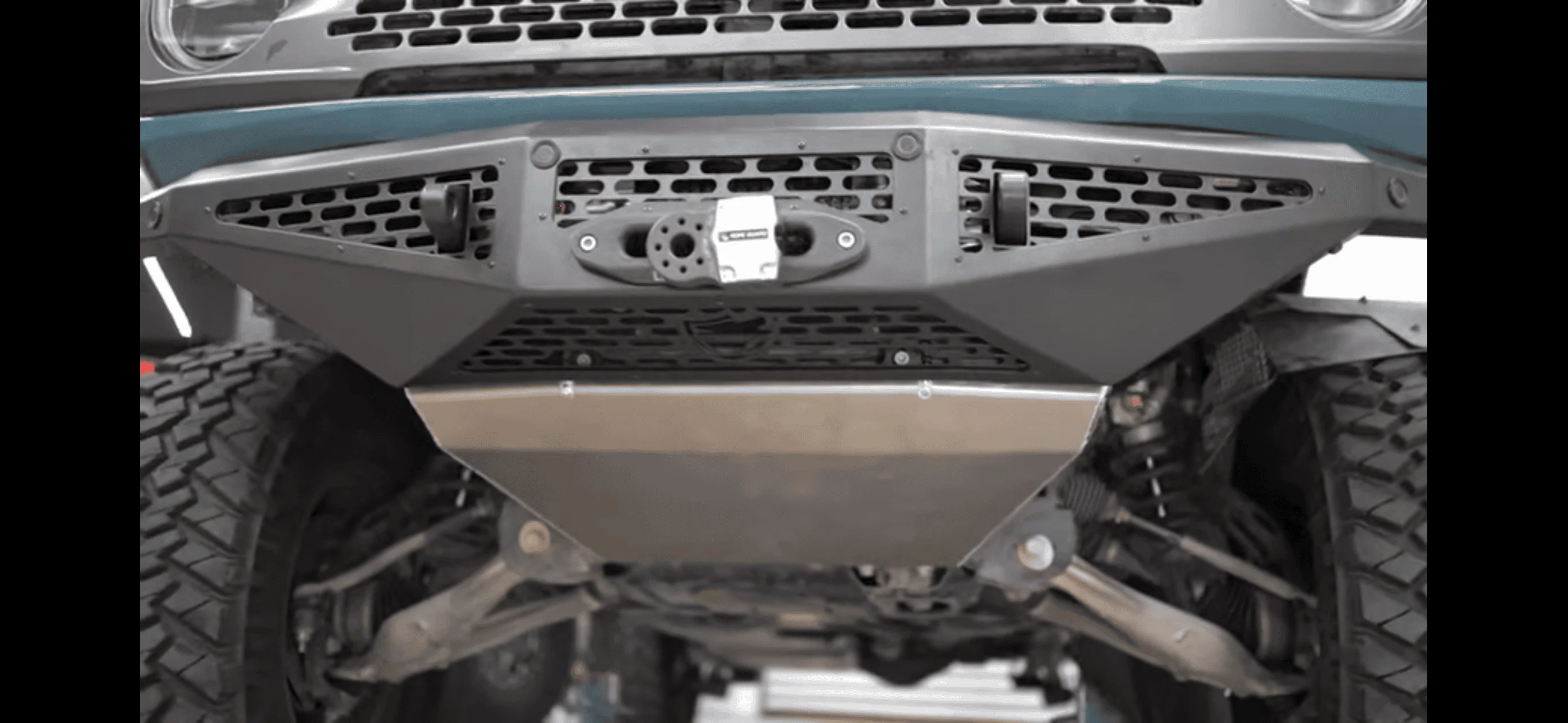

Did you take a look at the Lobo Off-Road WNC front bumper? Itā€™s designed to work with the Warn EVO series winches. Lobo is a B6G sponsor and Chris is great to work with.
