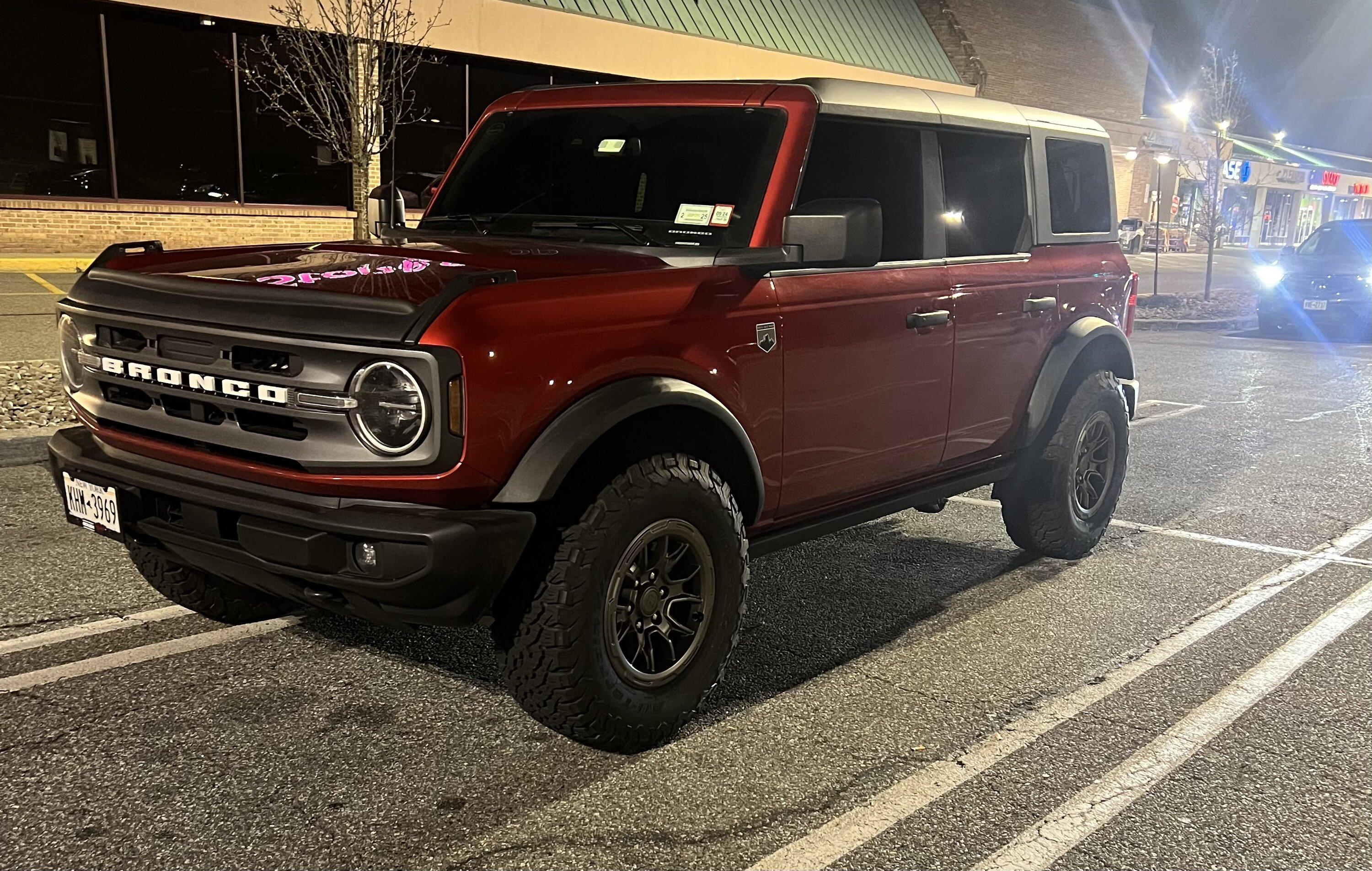

I have 275/70/18 coopers load E . mine is a BigBend with OBX wheels ( I like the wheels ) these tires are a true 33" tall, 4.27 rearend , 2.3 turbo , gas milage is a respectable 18ish plus on hi way . smooth ride , very happy with my choice . have this for 1.5 yrs now
they make these in 17'" too. ( I think )
good luck on your choice

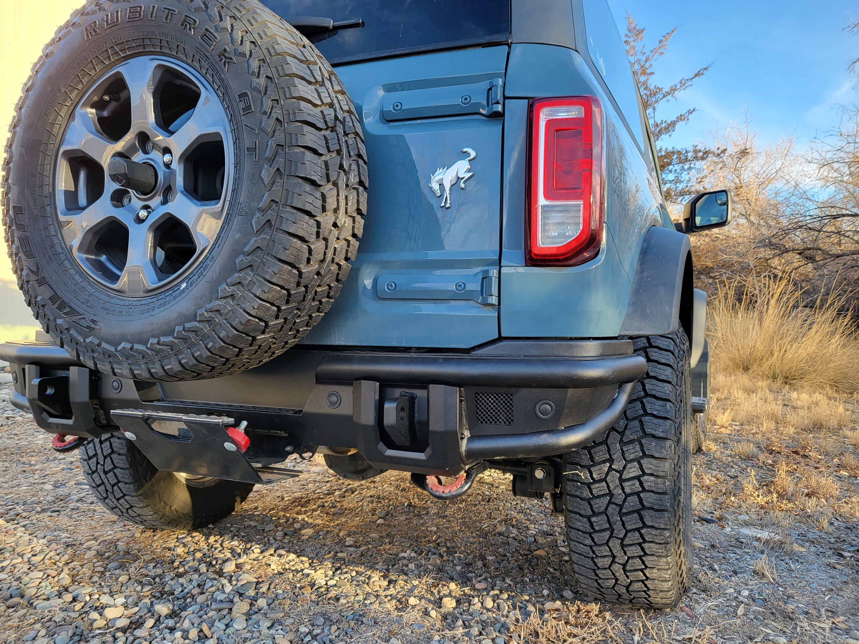

I ran the Bridgestones for a year and was quite happy with them, but I can't leave things alone. I got Falken Rubriteks, 265/70x17. Almost the same as a Wildpeak, just a hair milder and slightly cheaper. 285s would be good too.

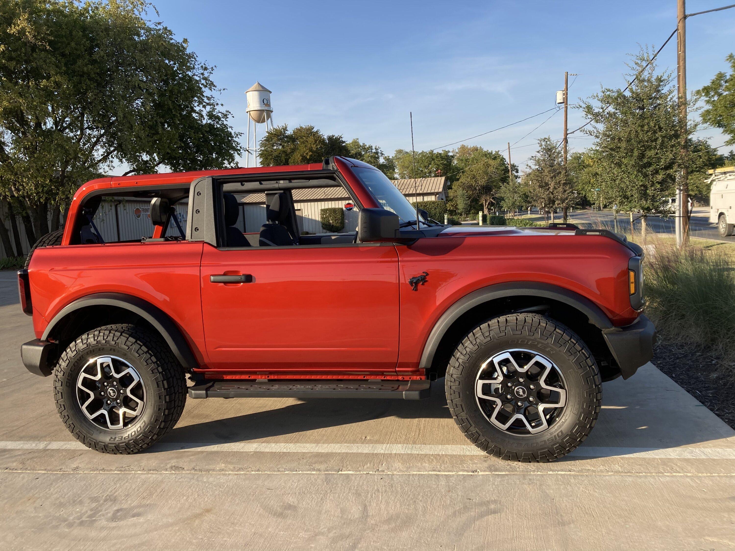

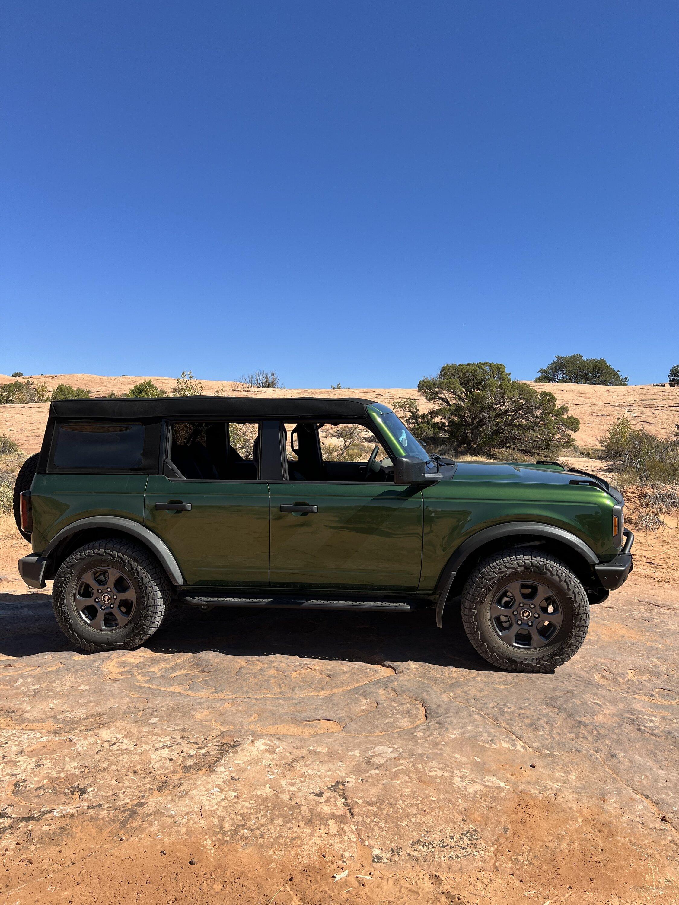

I have 285/70r17 Falken Wildpeak AT3W in load range C and am happy with them. They fill the wheel wells much better than the stock tires, look great, handle well, and are capable off road. You will need to order the Badlands rubber tailgate tire supports as the 285s are wider than factory.
My Big Bend below in Moab before I upgraded the suspension.
