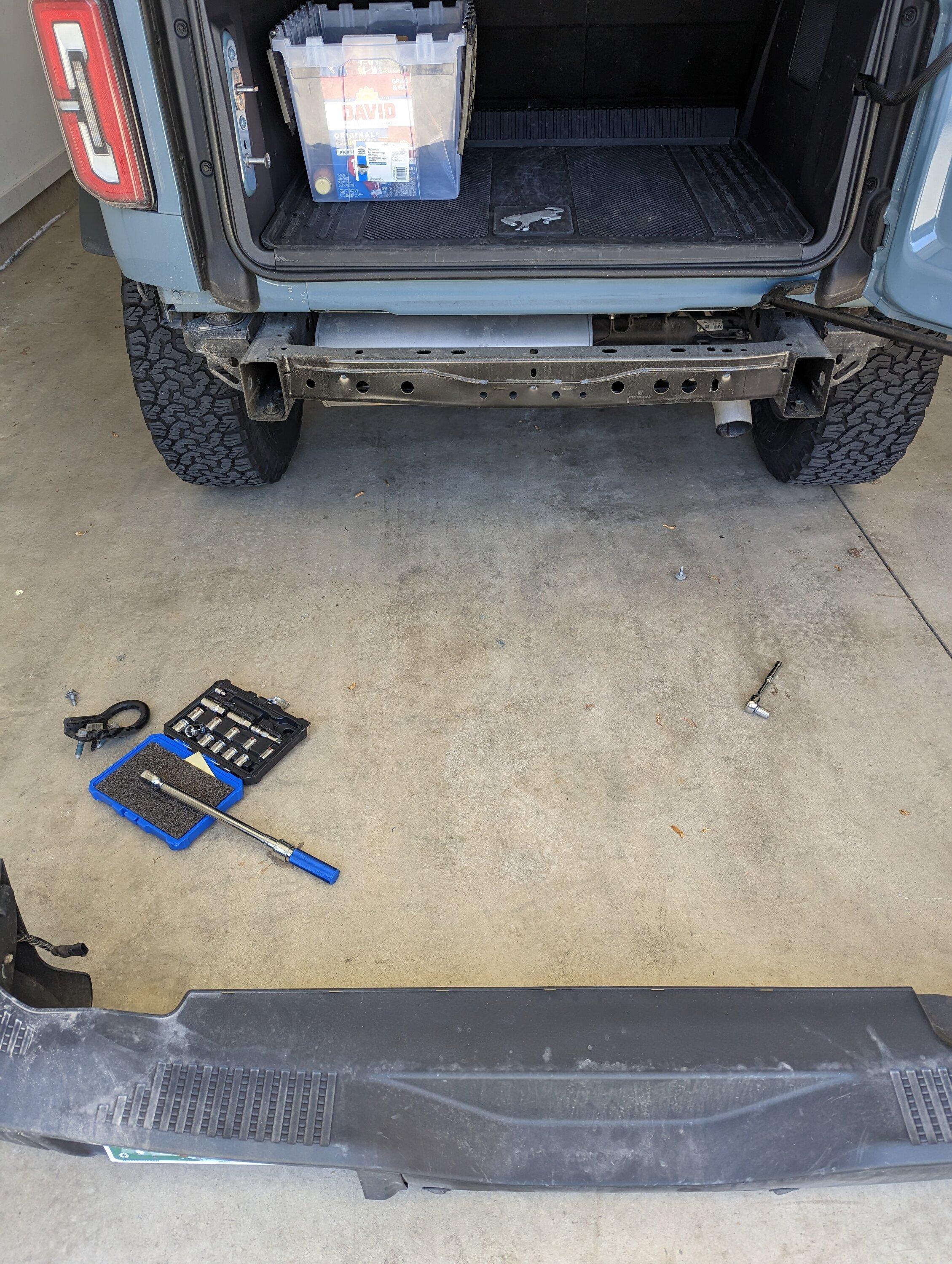

I appreciate this post, helped me with my decision and install. I went with the Curt hitch and had no issues installing it onto the frame.

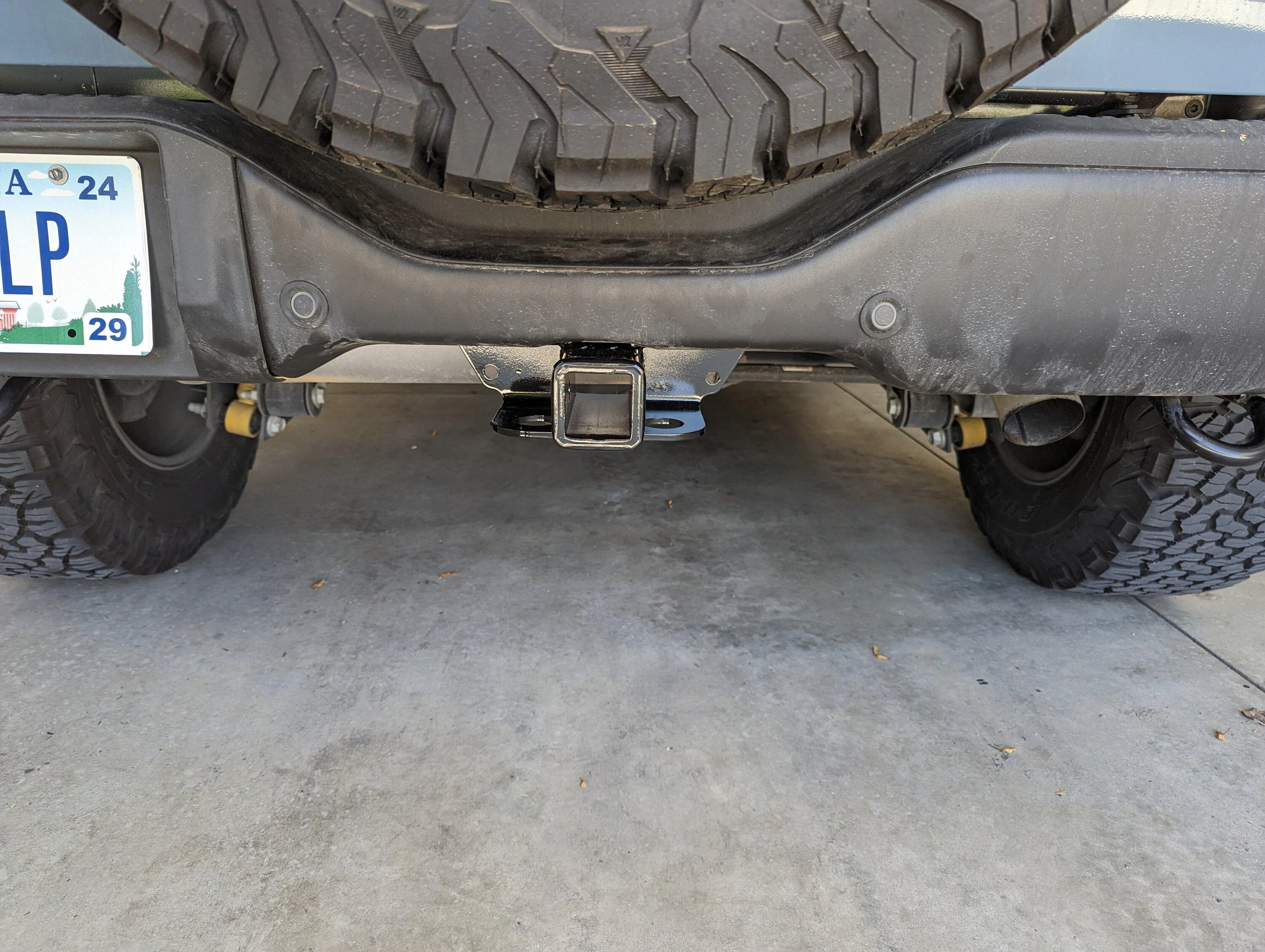

I found this to be a better option for my towing needs rather than an extension. Clears the spare tire just fine.
CURT 45260 Class 3 Trailer Hitch Ball Mount, Fits 2-Inch Receiver, 7,500 lbs, 1-Inch Hole, 2-In Drop, 3/4-Inch Rise https://a.co/d/57EjeuW
