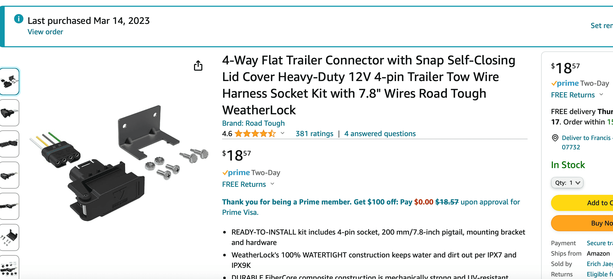

I did the Curt install. It's not hard. Just take your time routing the wire to the front. You can follow the brake lines or other wiring under the chassis. Zip ties are your friend. Use this connector.
Ford Bronco Aftermarket Towing Package / Kit? Screenshot 2023-08-15 at 8.35.49 AM
