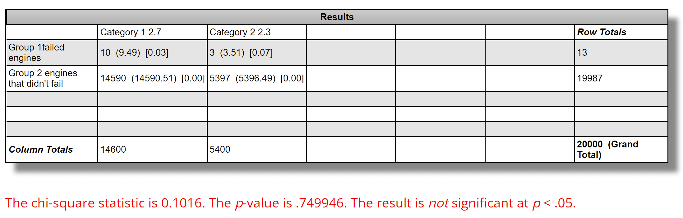

Using this anecdotal data, I ran another chi test.
Ford Bronco Another blown 2.7 engine on a Bronco 1639134699912
A chi-square test of independence showed that there was no significant difference between the failure rate reported on B6G between the 2.7 and the 2.3 engines (2.7 or 2.3), X2 (1, N = 10) = 0.1016 , p > .749946.
Even with made up data from information on a message board, we are seeing that it is less and less significant. The p value needs to be at least .05 for these results to be significant, and it is getting farther and farther from .05. Now if we get some actual numbers, I suspect the p value will be closer to 1 than it is with my unreliable and completely made up data set.
In other words, Dear B6G, please stop saying this is significant because it clearly is not.

This math (Chi-square analysis) is flawed on many levels, however the most glaring fault is treating the random 2.7 failures known as complete population data and additionally assuming that it is equivalent to the reported 2.3 failures (also treated as population data) which could be confounded by so many other variables that it's ridiculous.
That's a gross misuse of the Chi-square test.
Want to make it at least somewhat meaningful, survey all B6G members and use that for your Chi-Square analysis... At least then you can say that used population data and that it would be valid for B6G. Another way would be to take a truly random sample of owners and then run the data... Problem is that you will be under-powered unless there are many more failures.
I guess you didn't read where I already said all of that in my first post? :LOL:
