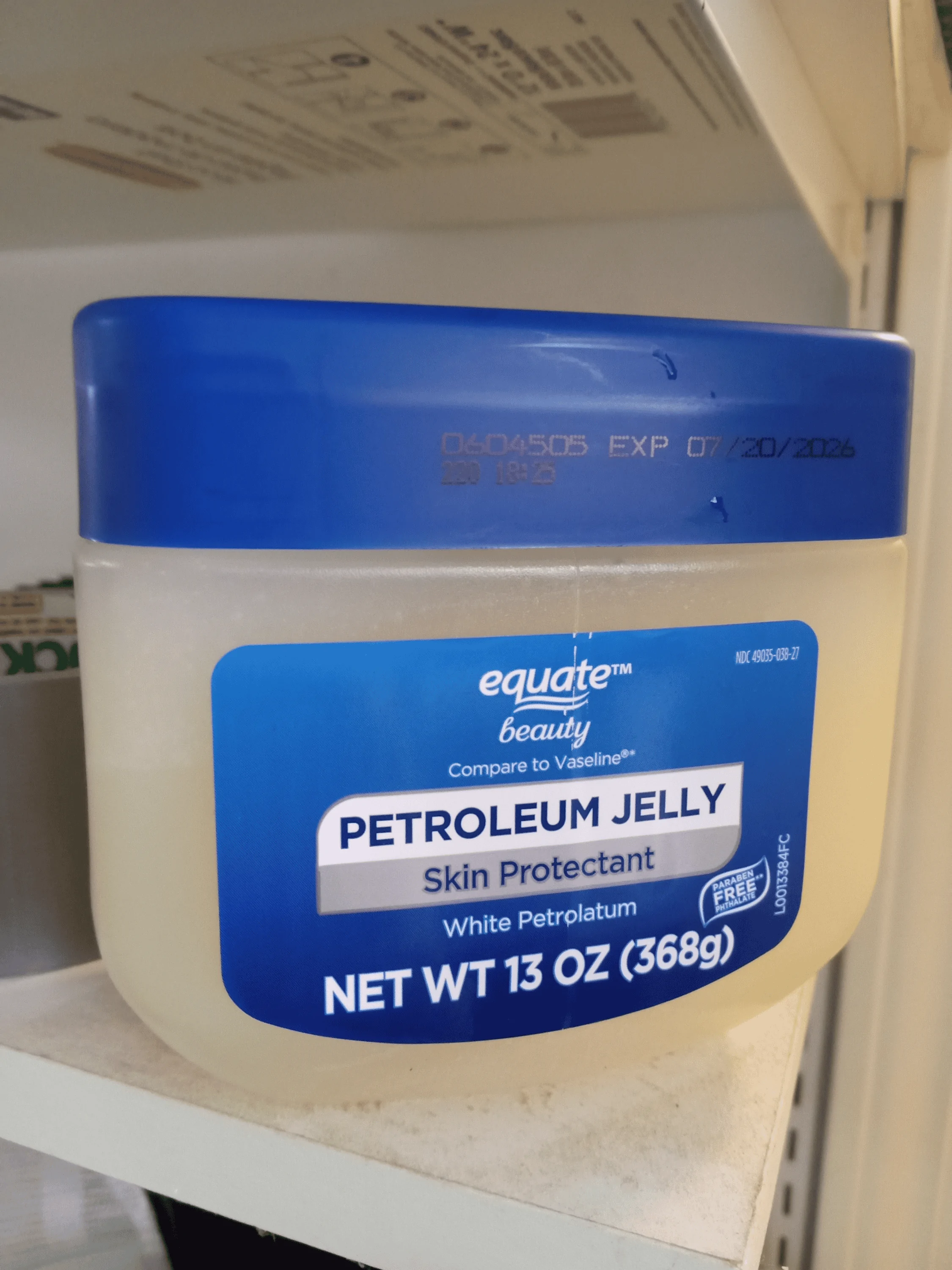

If it's from the rubber...
Ford Bronco Anyone have a fix for squeaky window? 1702218854852
