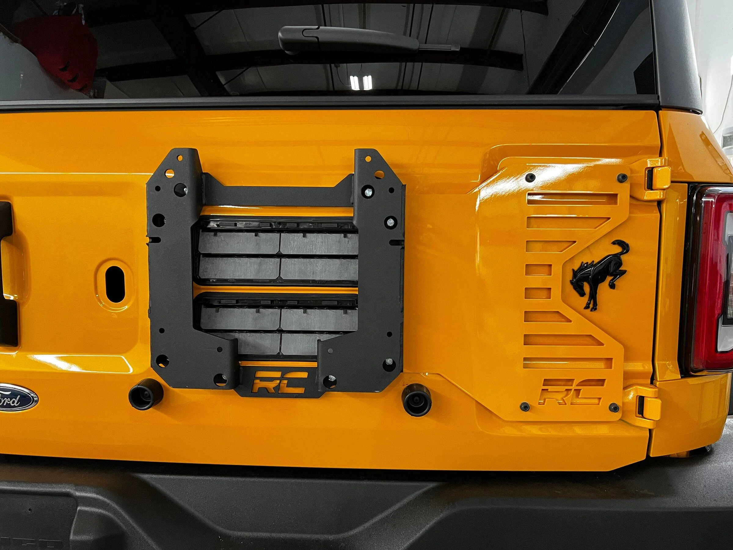

Anyone have the Rough Country Tailgate Reinforcement? How was the install? Do they provide any rubber padding or bushings to keep the reinforcement metal off of the tailgate painted surfaces (including on the hinges)? Thanks for any feedback and photos!

I installed the RC spare relocation kit (without the reinforcement). It was a powder coated steel plate that would go flush against your aluminum tailgate paint. I had some furniture felt stickers (that you'd put on the feet of couches so they slide around and not dent your floor) and I stuck about 6 to the back of the plate before install. This kept the plate about 1/4" off my tailgate, leaving enough space for water to wash between but also secured the plate on tight. I was worried about rubbing and rust. This solved both issues.

I had mine painted to match. Easy install. The kit comes with spacers that go between the Reinforcement bracket and the hinges. No paint on paint issues.

That is rad. I have cyber orange as well and will do the same. Is that remaining black part part of the basic strengthening kit? Was the install extensive? If you don't mind...what was the brand and color # for the yellow powder coat. Thanks....it looks very nice and should solve the reported rusting issue.
Thank you, the remaining black is part of the spare tire relocation bracket from Rough Country.
Install was simple.
It's not powder coat. It's actual paint. :)

OK thanks. The color match looked perfect....my local paint shop can do that. Thanks!
