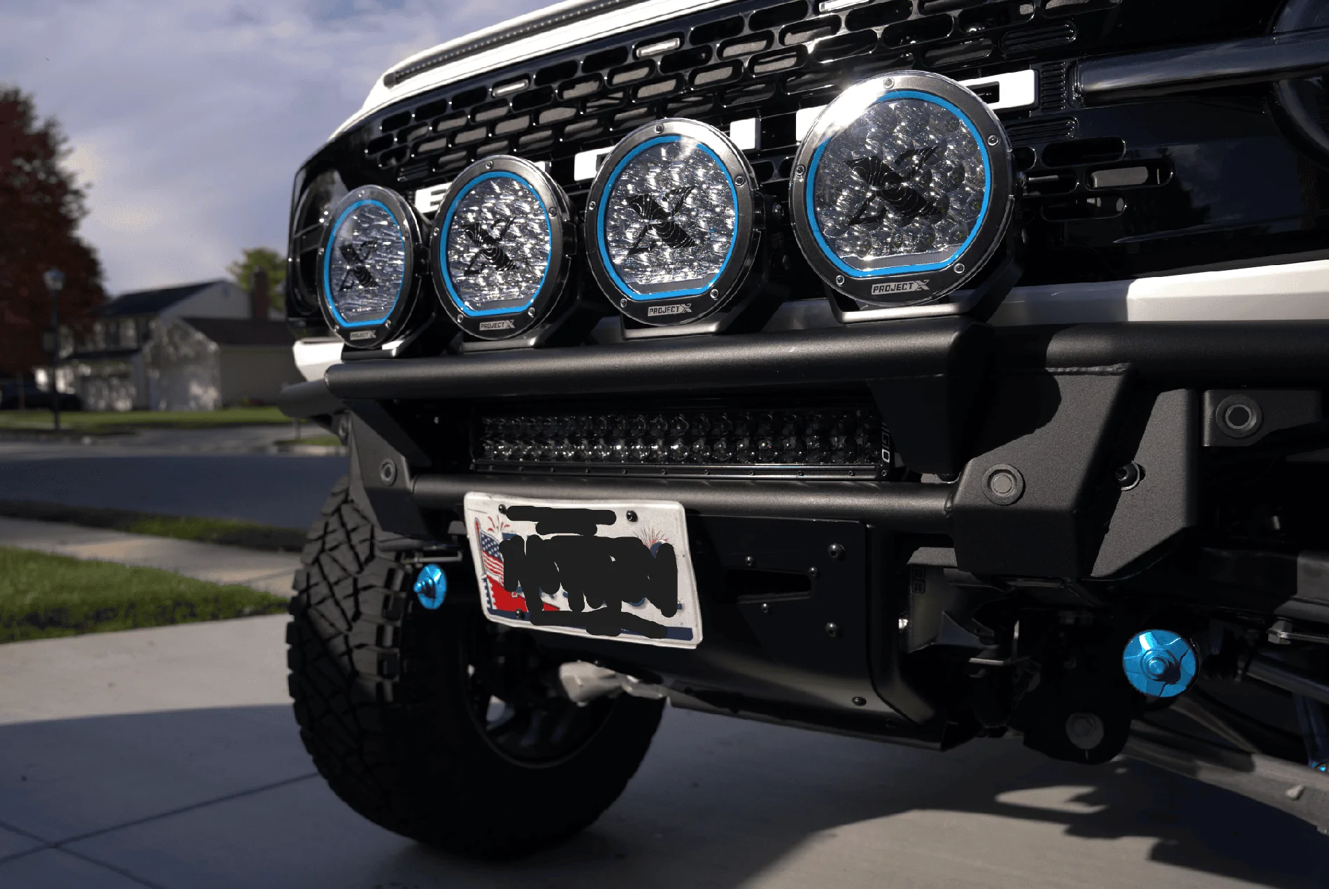

I have already pre test fit the aFe aluminum intercooler sleeves, and they do appear to fit nice and snugg on the COBB.
Install pictures and more to follow.
2022 Bronco Wildtrak 2.7L Lux.
UPDATE: AFE H&C pipes fit together nicely with the Cobb IC. Now I just need to move my license plate that is blocking the air flow partially.
Need to figure out if there is a way to trigger the radiator louvres and radiator fans to open fully on Sport mode using Forscan.....
