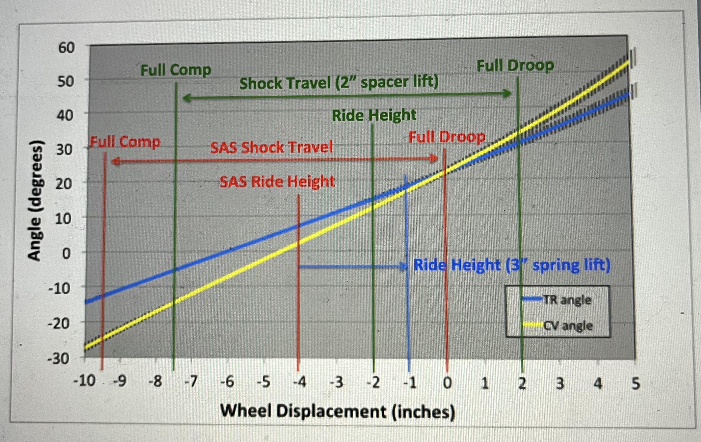

Does anyone know or does someone mind taking a quick angle measurement of the CV Axle on a stock Sasquatch sitting level on the ground. I forgot to check mine prior to adding level kit. Thanks.

Attached is a chart showing calculated CV axle angles for my near SAS geometry. I estimate my angles vary from +20 to -20 degrees for full droop to full stuff. And are about 5 degrees at ride height. There are likely some small measurement errors in this.

Thanks for the reply and the info. After my 1.25” level my CV axle is sitting at 10 degrees at ride height and 24 degrees at droop, so it’s not far off the standard SAS geometry. Gives me a better feeling about future potential issues. Thanks again.
