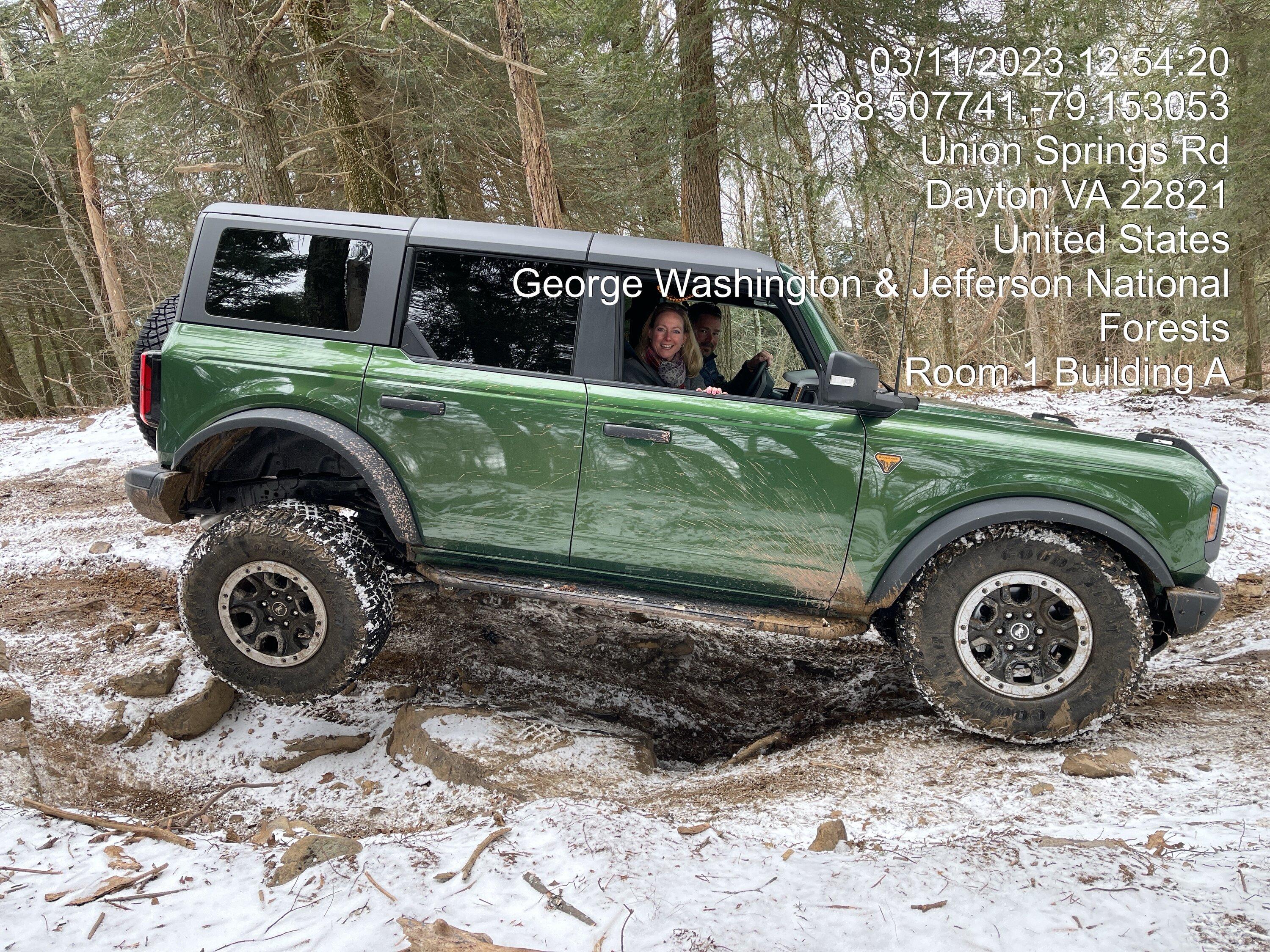

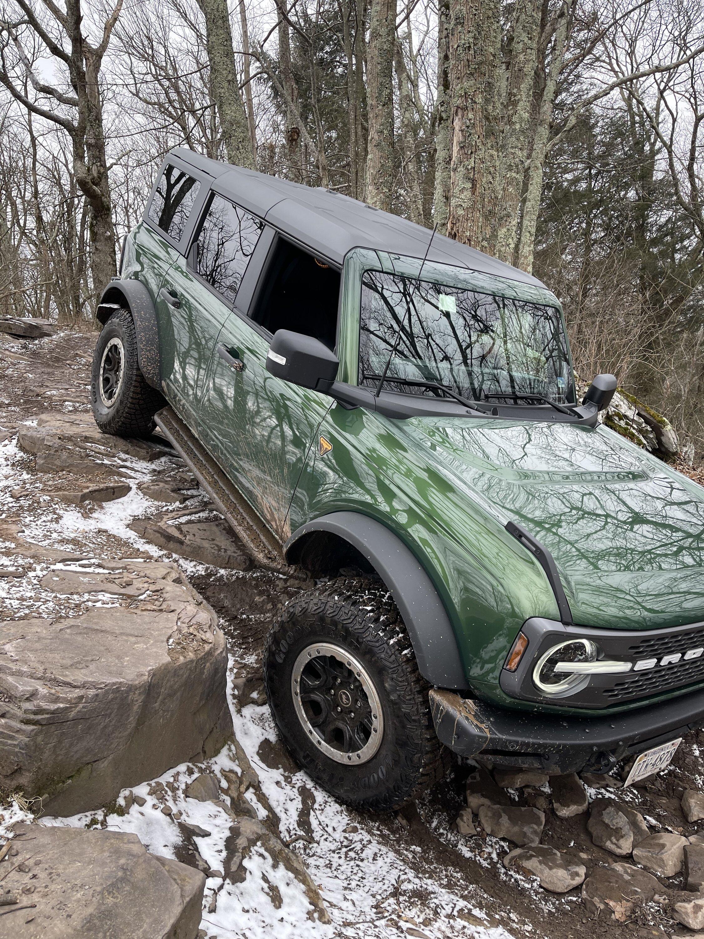

Here a few pics of the great day!

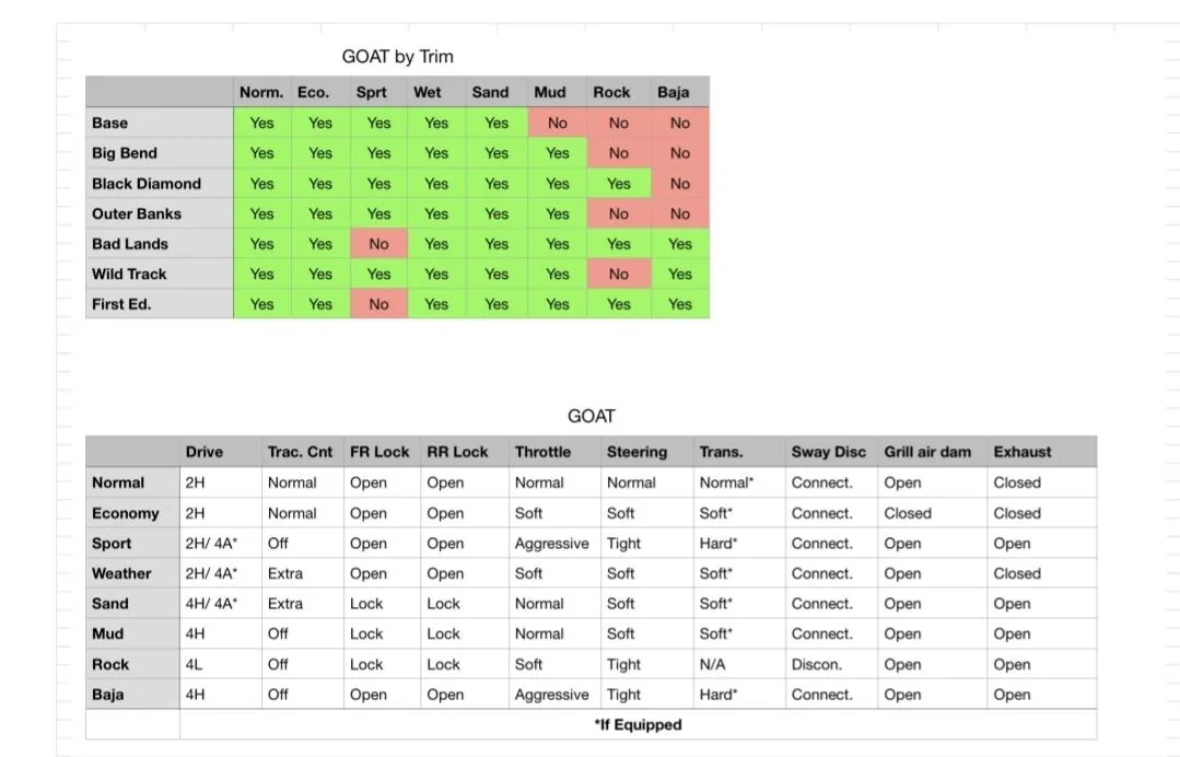

Thanks. Edited my previous post. Mud/Rut mode does not automatically disconnect swaybar. I dont have that feature so indont know if you can manually disconnect it in that mode.
Ford Bronco Different GOAT programming based on the model and package? Screenshot_20230212_175054

There shouldn't be a difference. Swaybar disconnect is allowed in mud mode (allowed in any 4H/4L mode at low speed), it's just not the default. ABS could be a problem with erratic footwork or not using low gear on low traction downhill (not maintaining control).
Your second table is interesting. Ours did not lock the front in mud/ruts. And if I recall correctly, I could not lock the front in 4H regardless of mode. I’ll need to double check that.
Correct, front locker available in 4L only...
