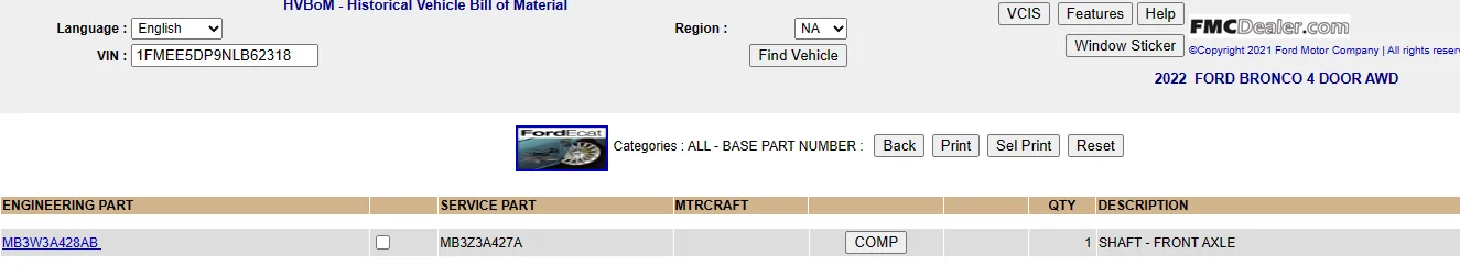

Trying to make sure I ordered the correct part -

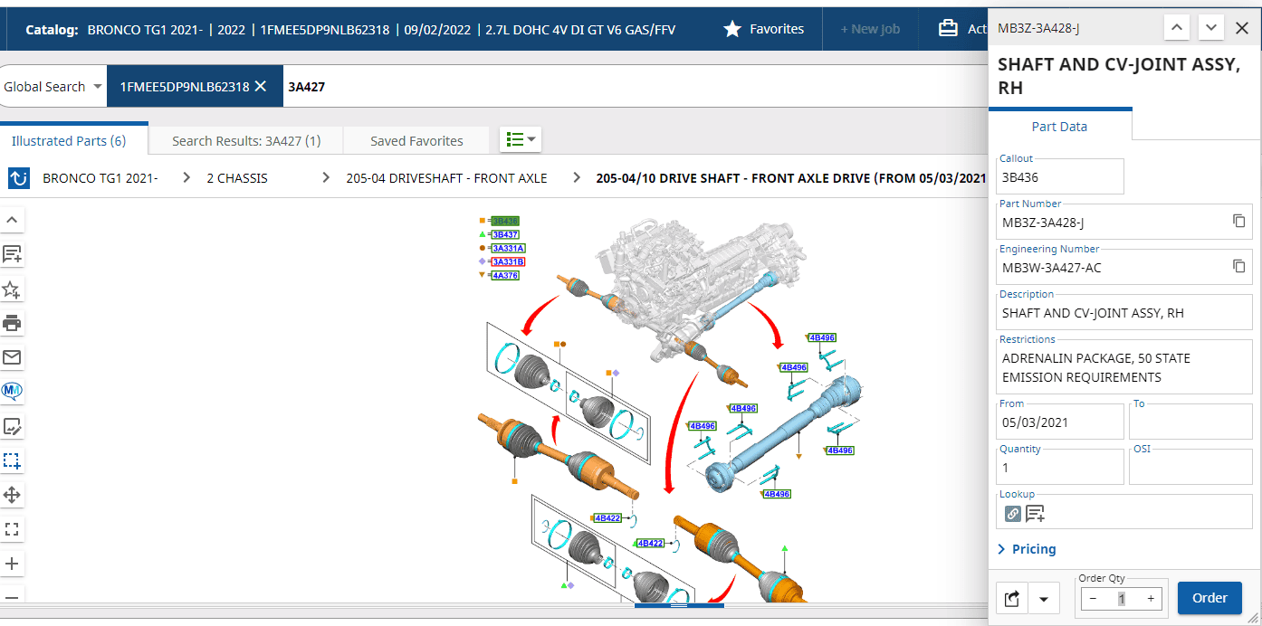

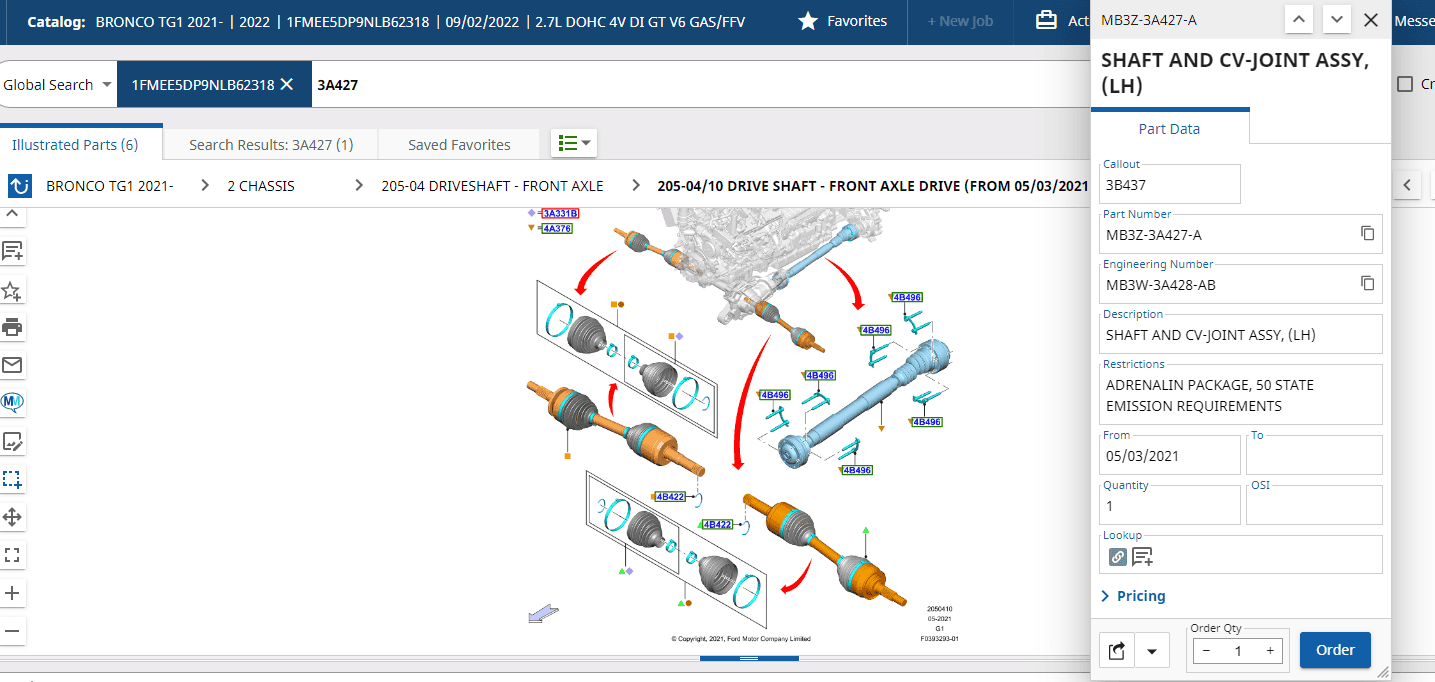

I’ve got a ‘22 Wildtrak and to spare the details I need a new Driver’s Side (left) half shaft. I’m thrown off because the number on the sticker on the stock half shaft is MB3W-3A428-AB. I know that isn’t necessarily the part # for replacement but everywhere I’ve looked the replacement part # is MB3Z-3A427-A (which I ordered). The xx428 number printed on the stock shaft comes up as all the Passenger/Right side options when shopping around and all the xx427 numbers are drivers side. On my vehicle as it sits from Ford xx428 is on the driver’s side shaft and xx427 is on the passenger side. I’m assuming they aren’t identical so it matters which side is which, right? And is there a chance either I have ordered the wrong part # for the driver’s side (all online retails sources have it wrong) OR they installed them backwards OR it’s just a strange coincidence and those aren’t part #’s at all on the shafts just manufacturing numbers that are oddly similar. Thanks
