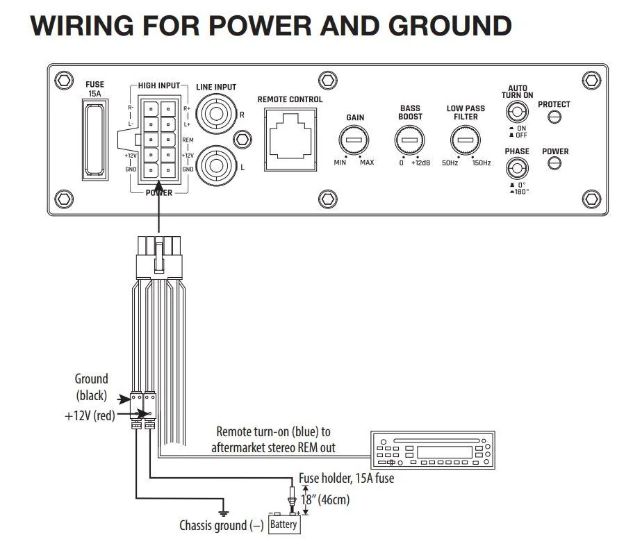

I added the Pioneer mini hybrid sub with 6 new Kicker speakers. Bass is much better - not booming but full range is deff there and you get some good punch. I'd compare it to a nice home theater level of bass. Rounds things out. Fits right under the driver seat, is pretty cheap, and runs off an easy 20 amp fuse in the dash panel since it's designed for hybrid vehicles.
