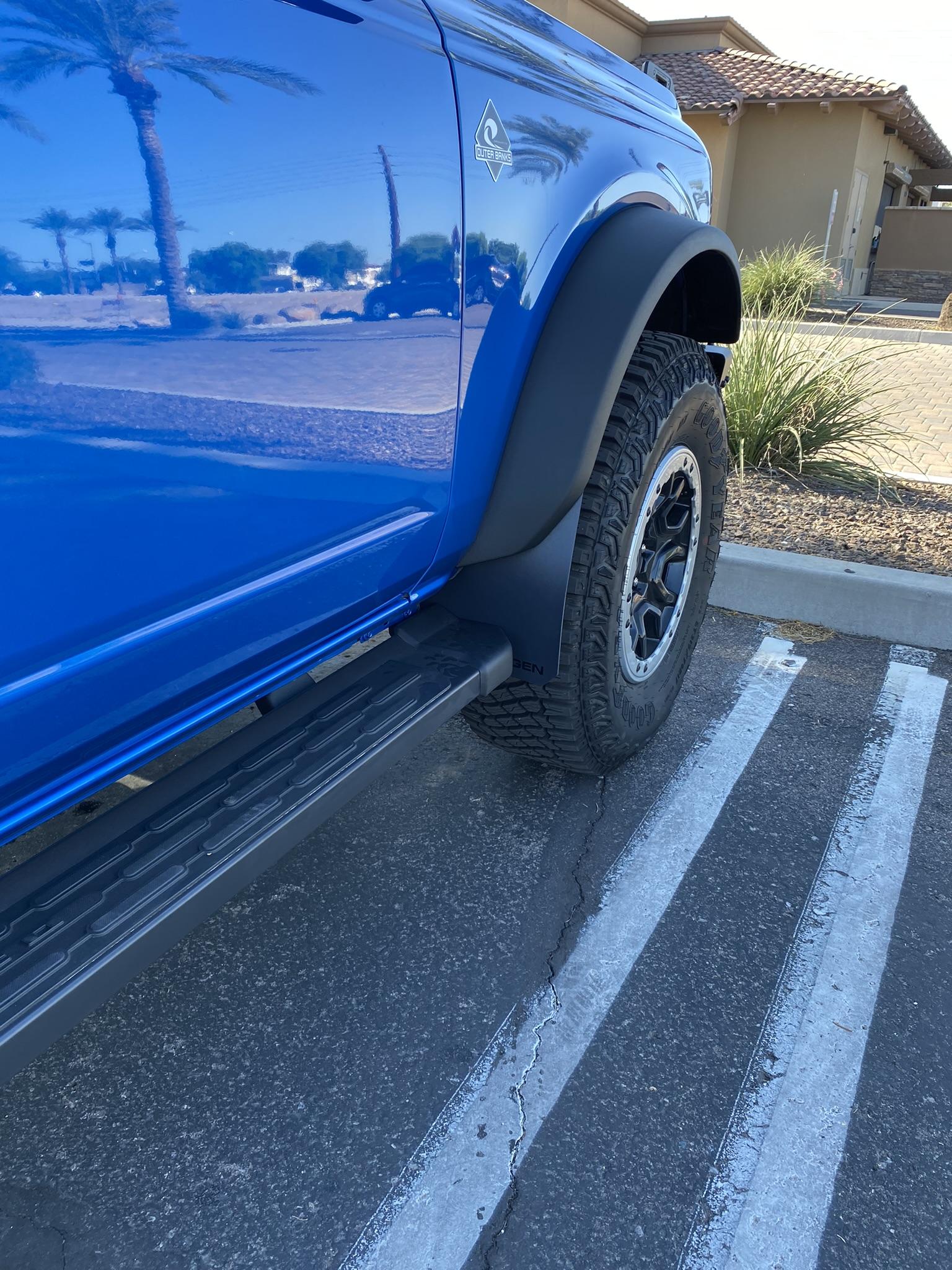

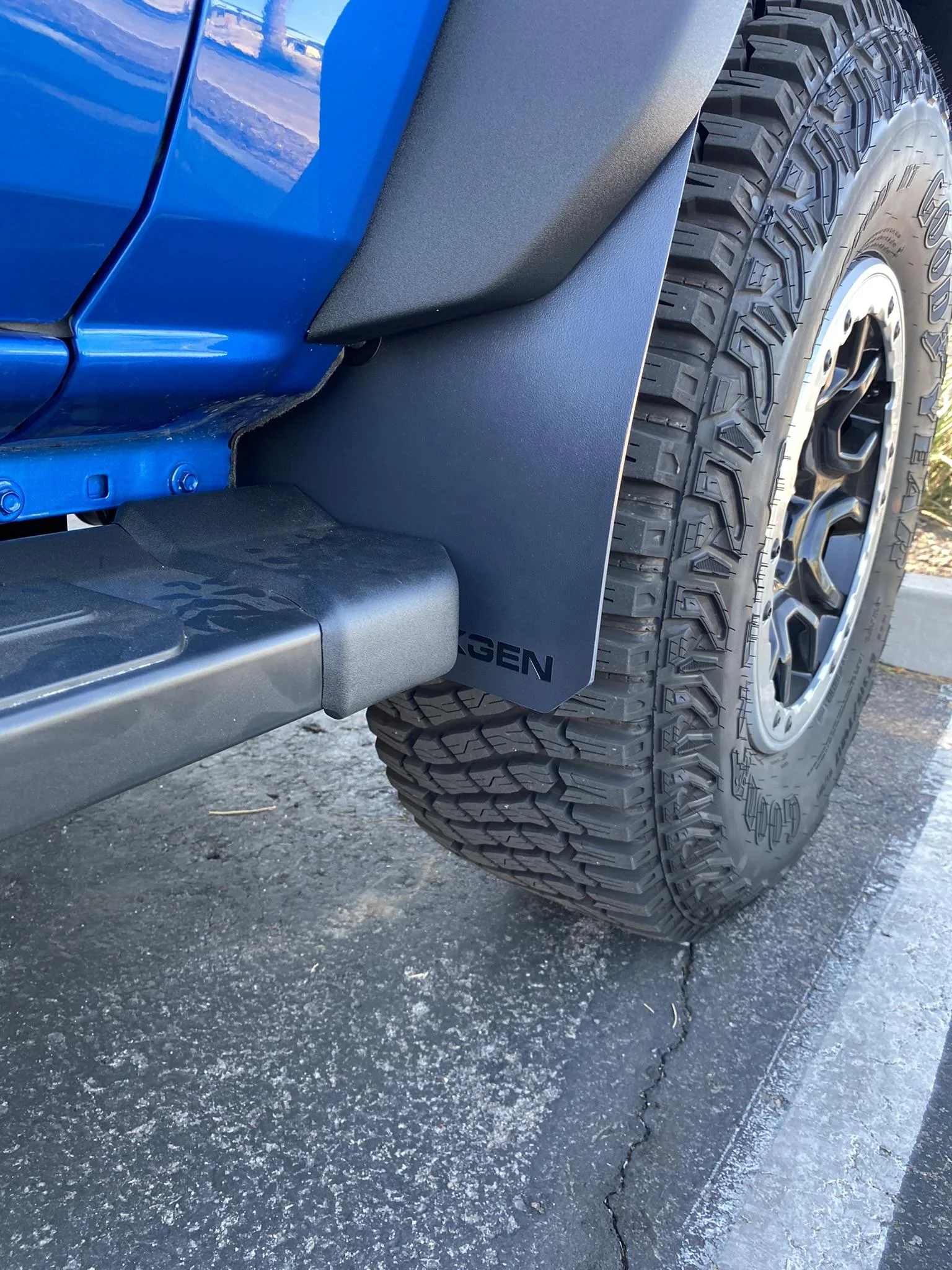

Factory side steps + RekGen mudflaps look and work great. 3 months in and I’ve heard plenty of rocks fling with only 1 small chip. I have the Sasquatch package.

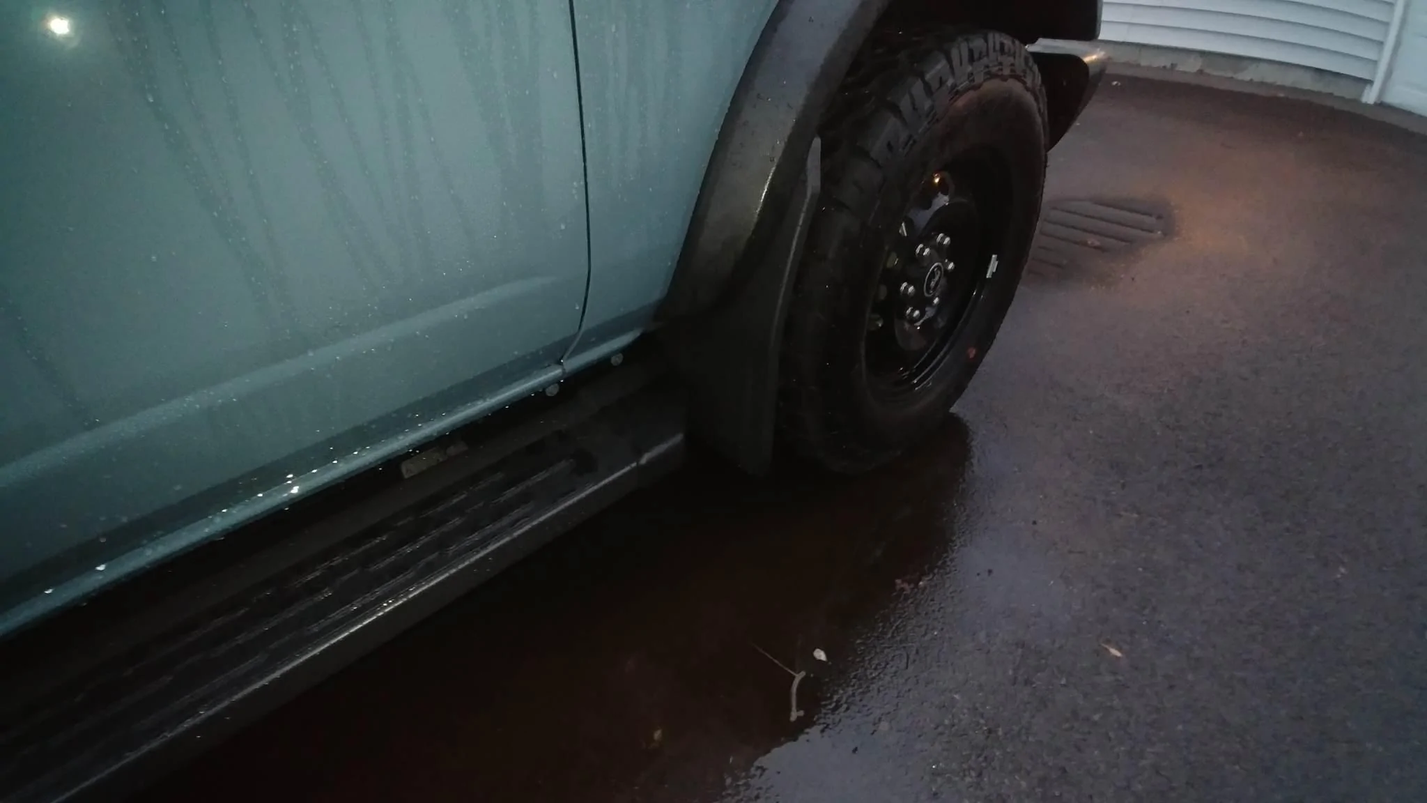

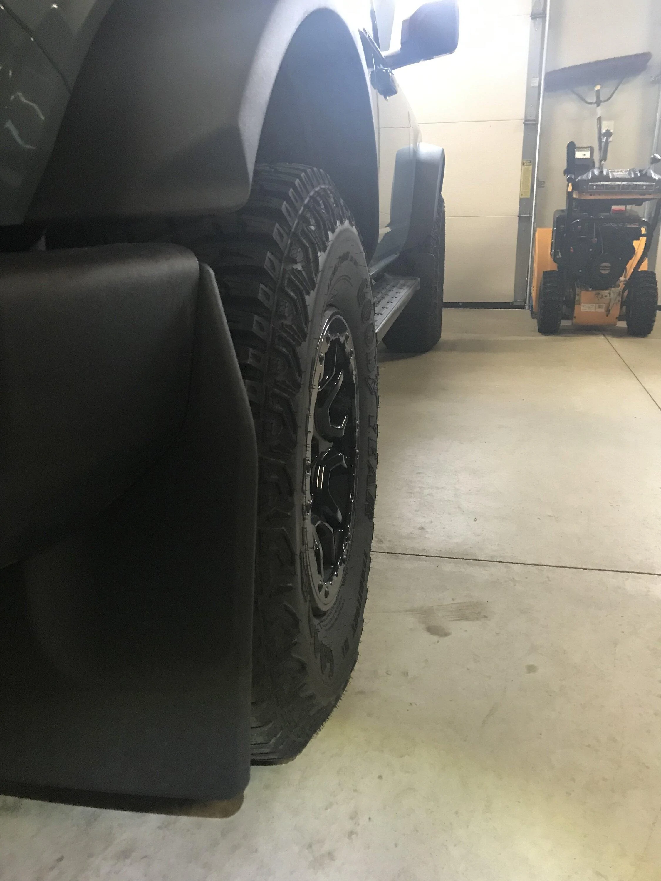

Weathertechs seem to help. The Goodyears grab rocks and hold on to them until you reach highway speed and then fling them out. Cringe every time you hear them hopefully wack the underside of the running board.

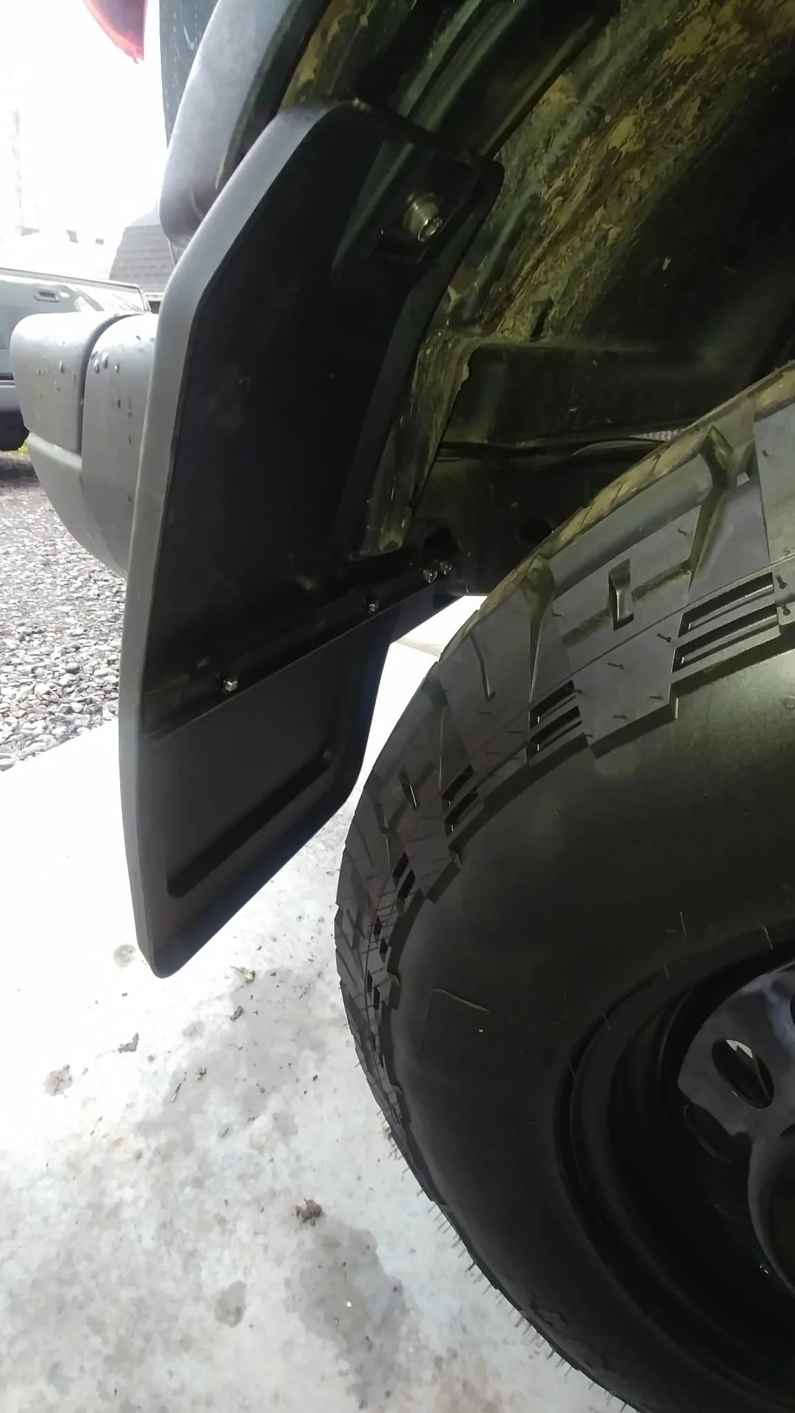

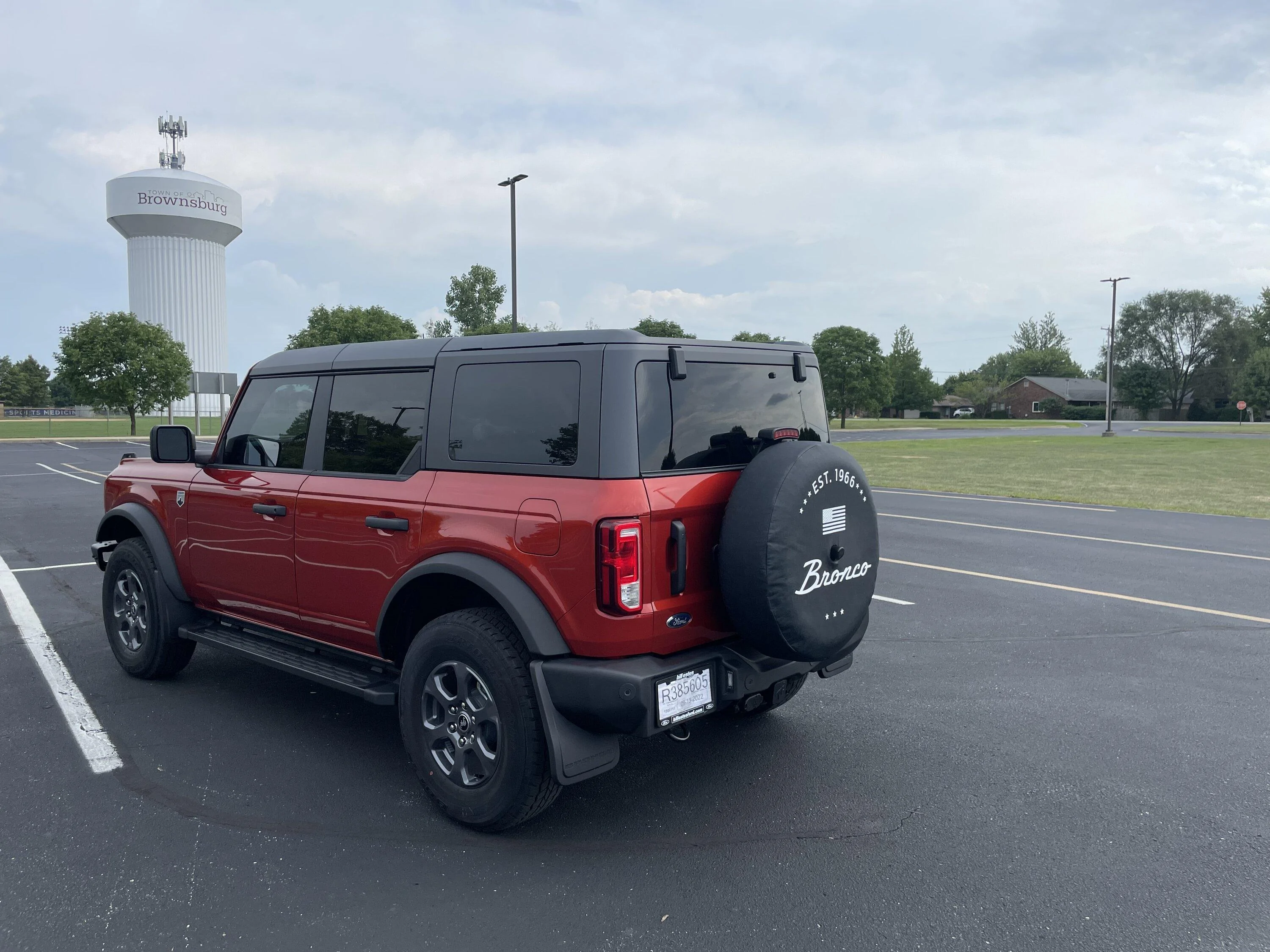

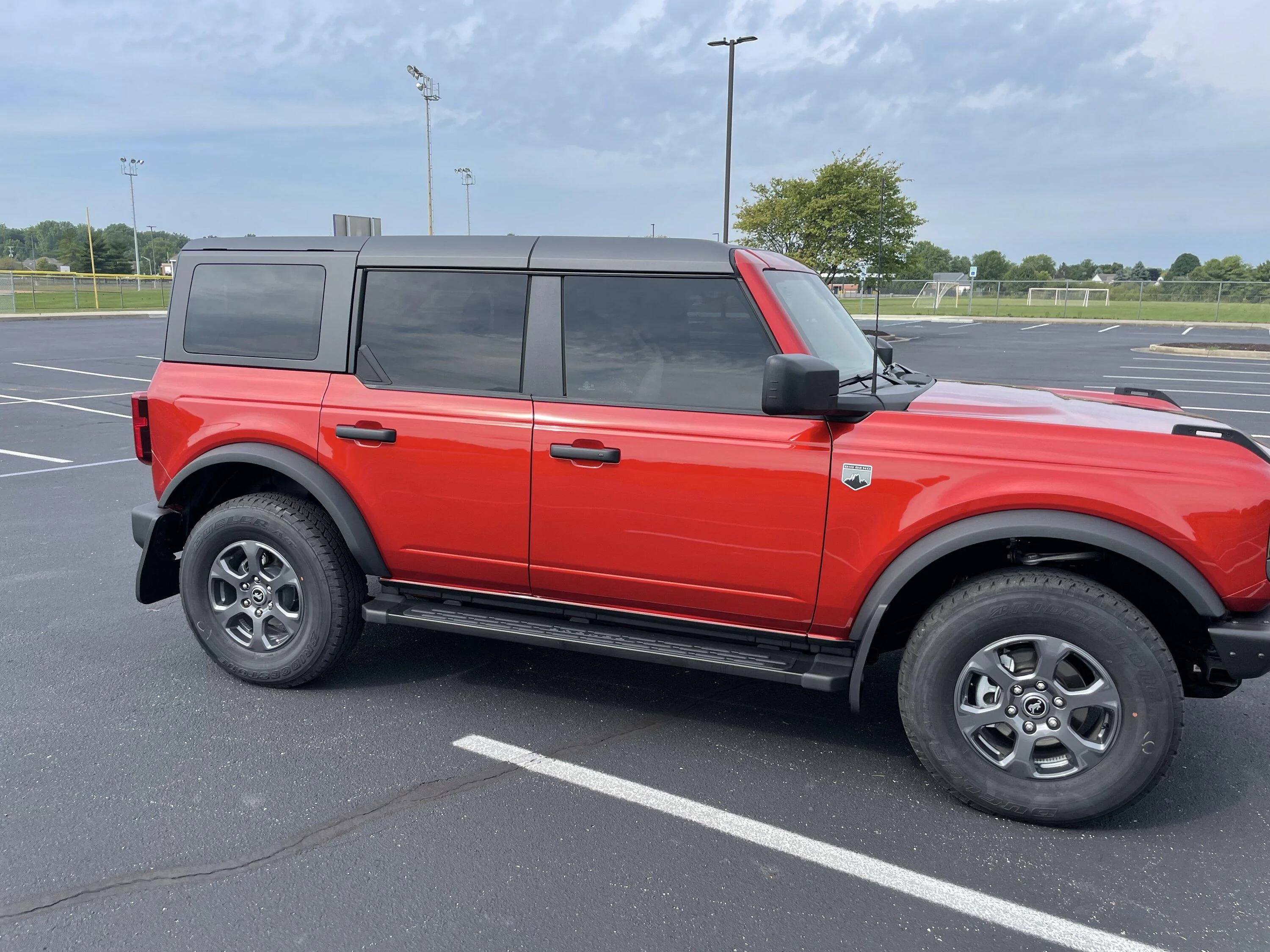

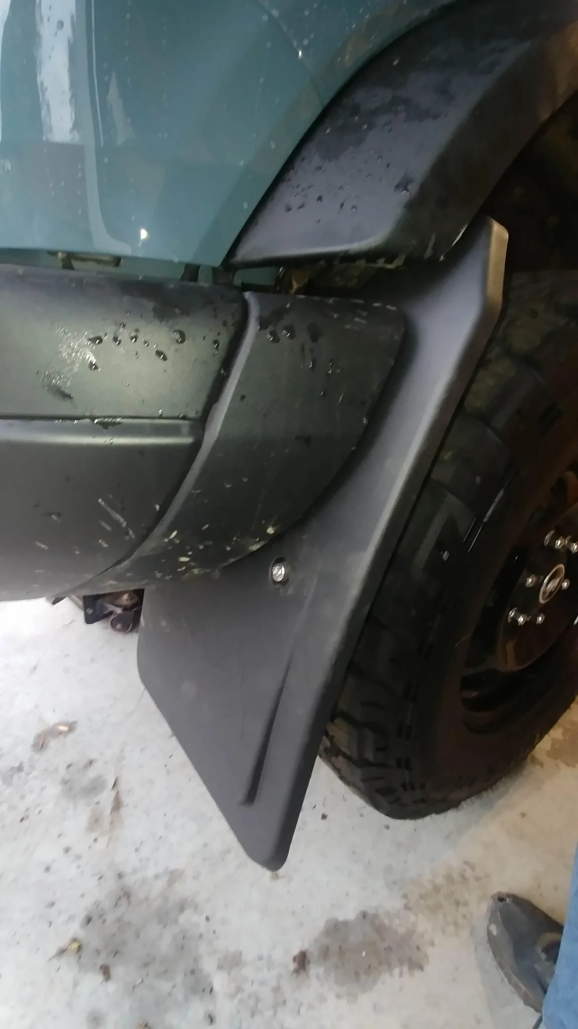

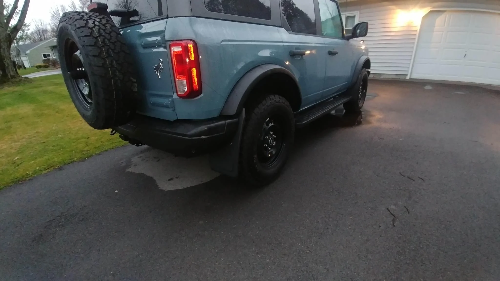

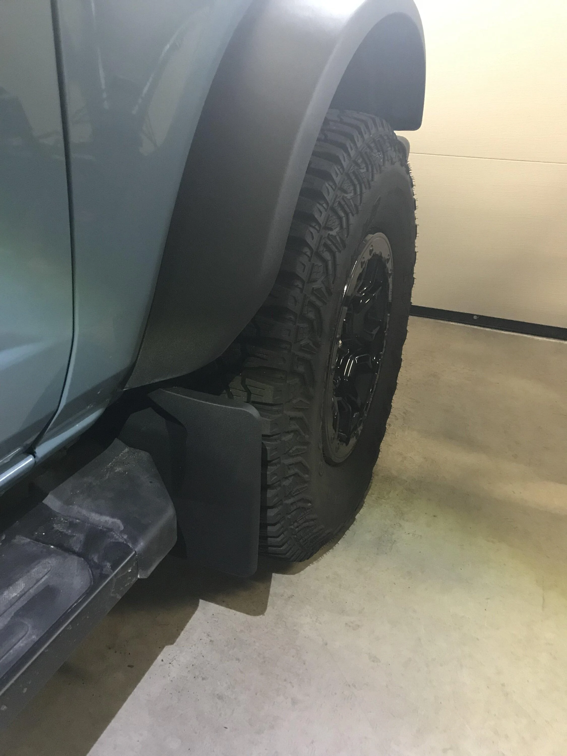

OEM steps, flaps, and rocker panel cover.

I'm leaning towards picking up a set of these for the front (M2DZ16A550AA). Did you have to cut them up to clear the step or has Ford finally updated the design on these?

Not sure if Ford has updated the design. I did not want to cut the flaps as they fit perfectly around the flares and wheel wells. I moved the steps back about 1 inch. A bit of a PITA, but I was able to keep the integrity of the flaps in place and everything fits perfectly. I ended up tapping a few holes to make sure that everything lined up correctly after I moved them back, Ford definitely didn’t make it easy to use OEM parts together on this setup! Do luv $53 for flaps though instead of hundreds of dollars. 😁

That looks clean. I think somebody on here also had success swapping the steps between the left and right sides. Apparently there is more clearance when they are reversed.

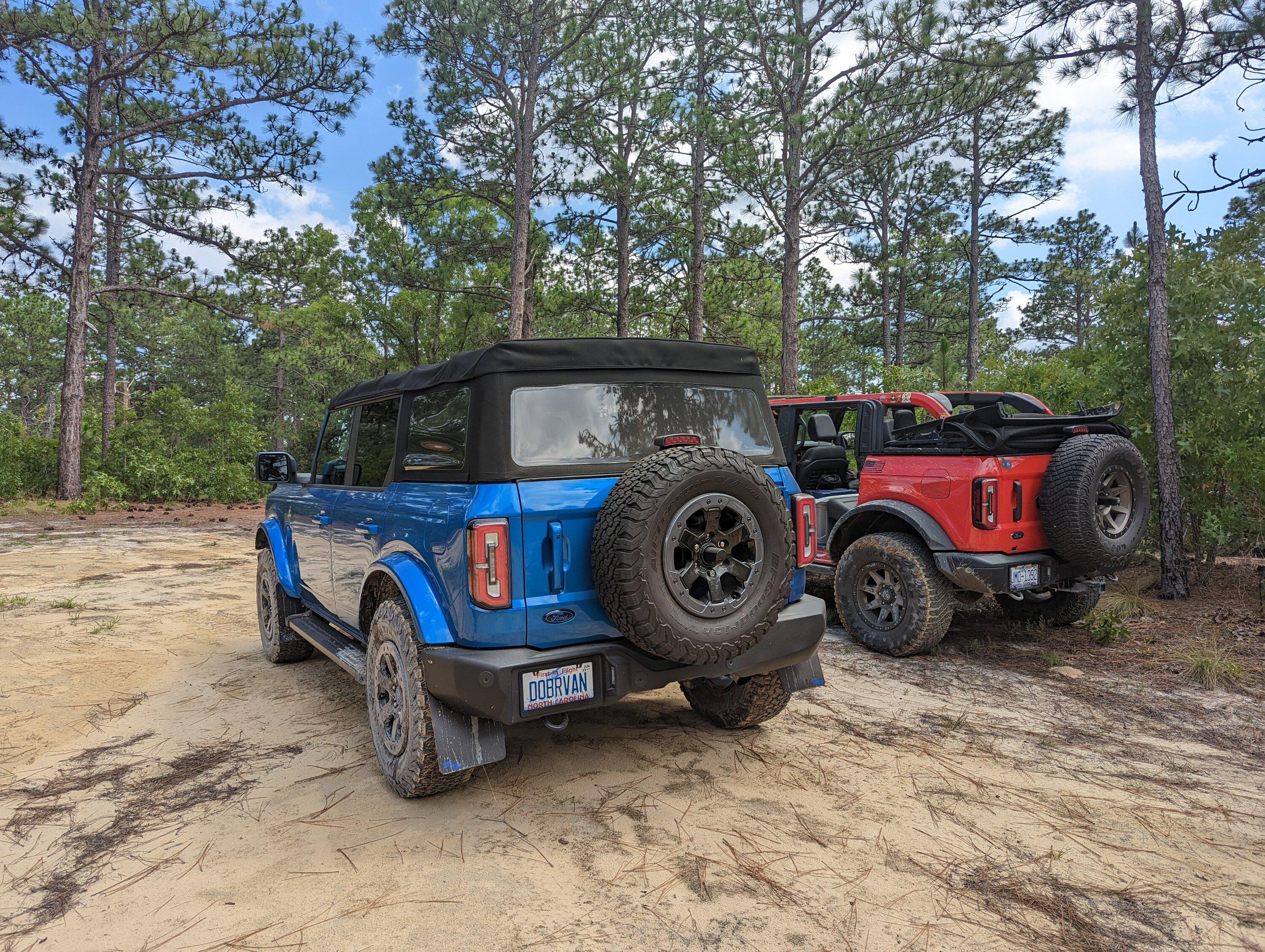

There are tons of posts on this if you search...

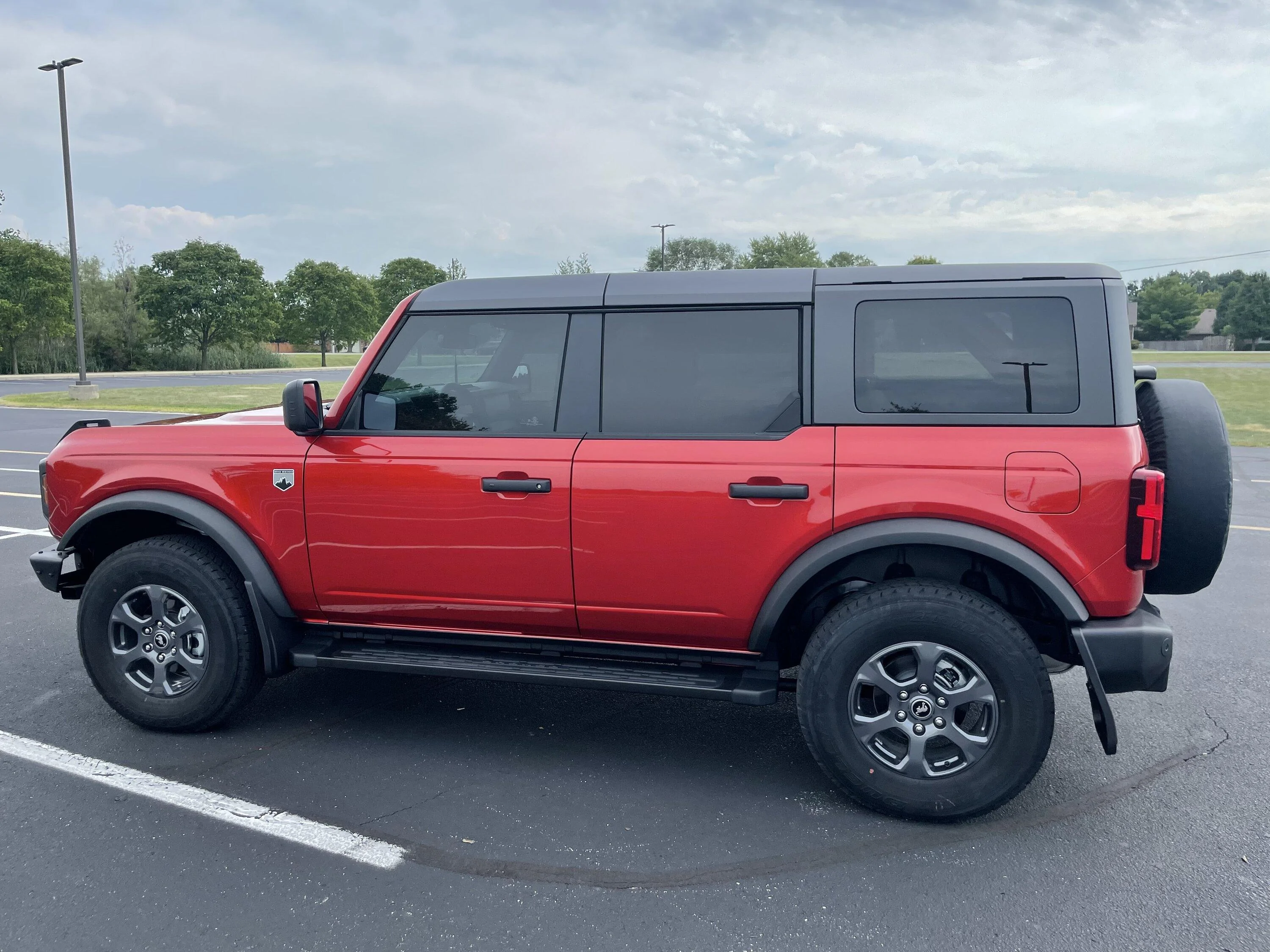

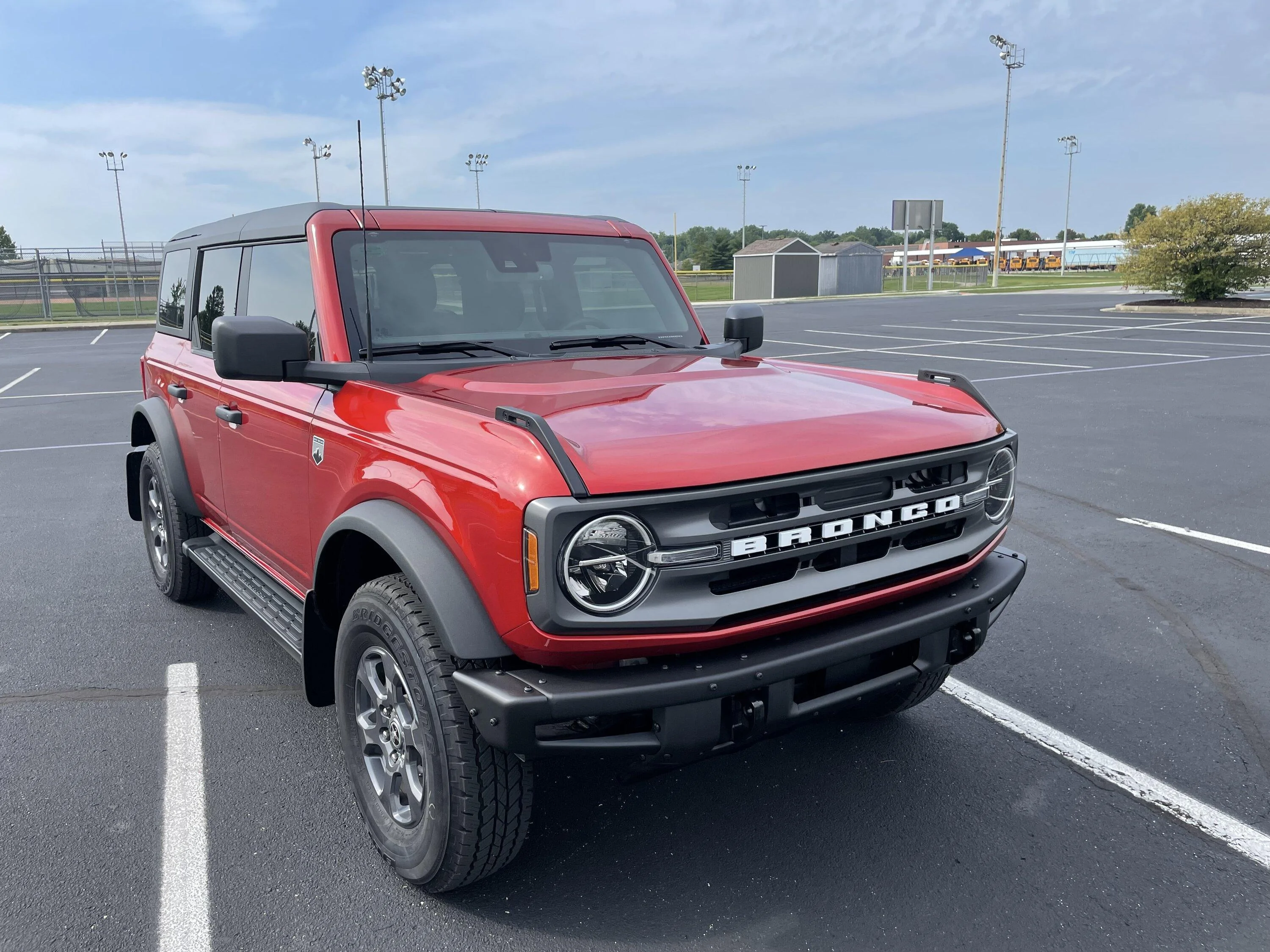

With that said, I always recommend Rokblokz. They have the best method for securing to the vehicle without ANY modification or janky screws.

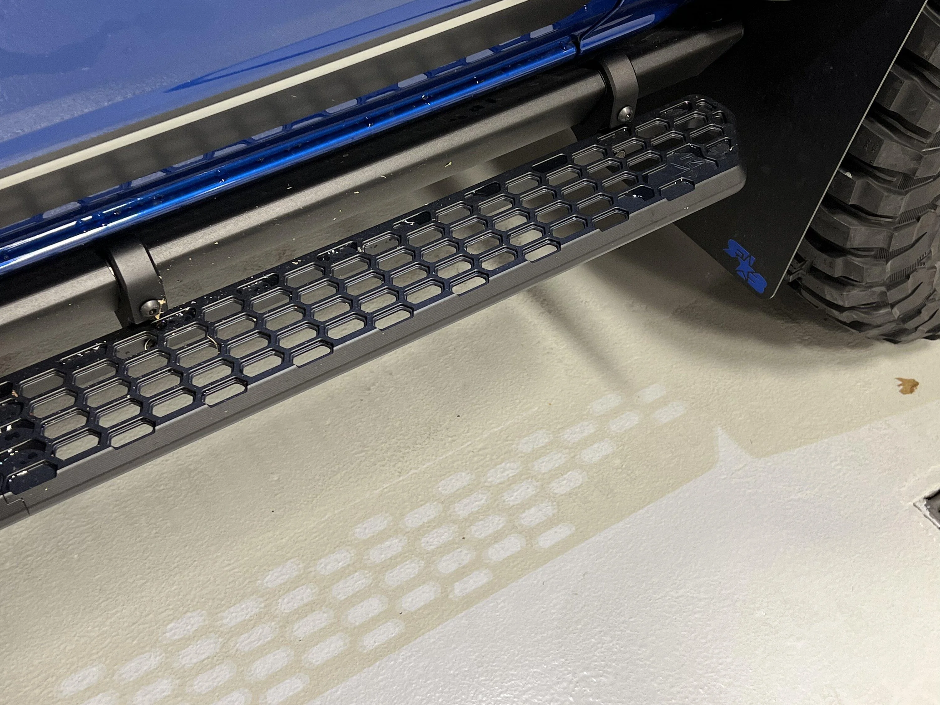

Archetype Racing Magnums & Rokbloks
