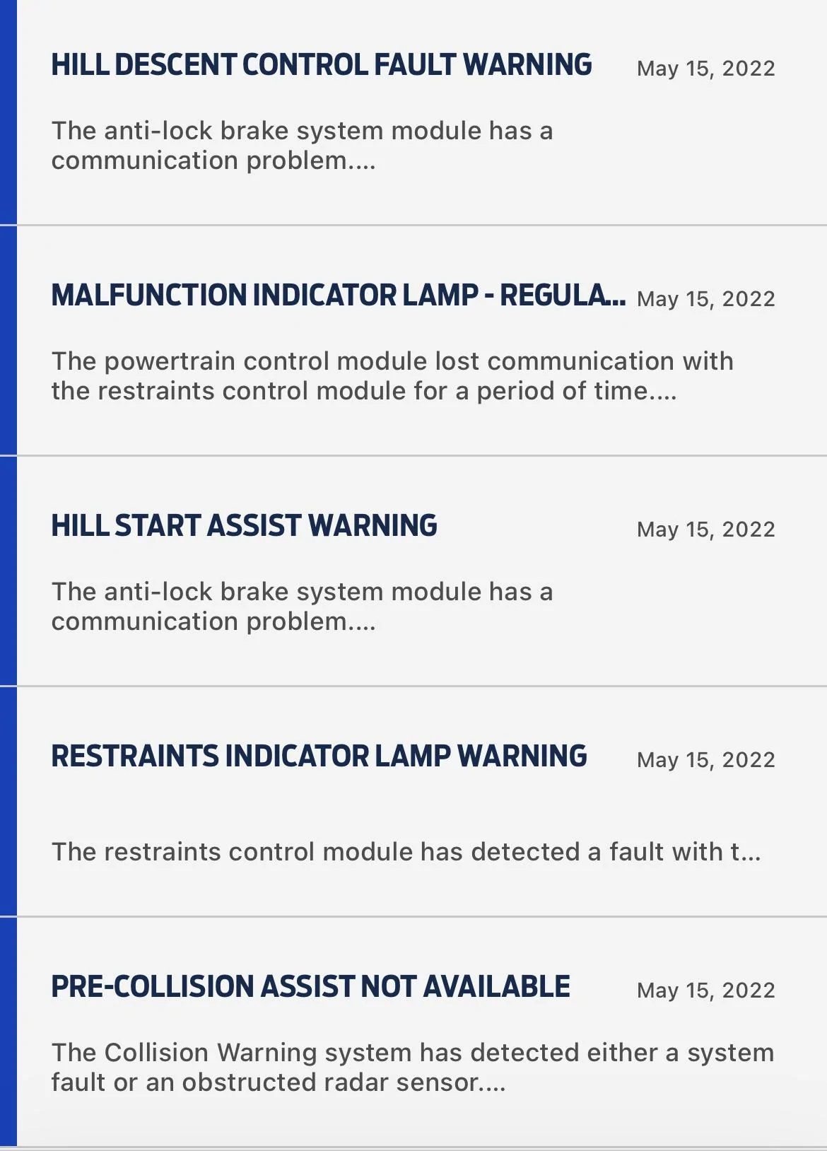

What’s up everyone? Anyone else out there having PCM issues? About a month ago I received an alert telling me the battery was going to sleep mode. I went out and took the bronco for a drive to try and recharge the battery. Here’s the crazy part; once I got home the bronco wouldn’t shut off. It’s a manual transmission so (thankfully) I was able to stall it, but once I put it in neutral, it automatically turned back on. Anytime I restarted all I get are alerts. System stays on, so it continued to drain the battery. It’s been to the dealer and now I’m waiting for a new PCM for reprogramming. Anyone else out there with similar issues?

***Update***
Merle needed a new PCM. Yes a vehicle with less that 4300 miles had a faulty PCM (kinda like a new laptop with missing programs). Honestly the Ford support on here and the warranty process was awesome, but the dealership dropped the ball. Having a vehicle for 4 weeks (and mis-communicating multiple times) makes me nervous that service departments everywhere are going to struggle moving forward.
