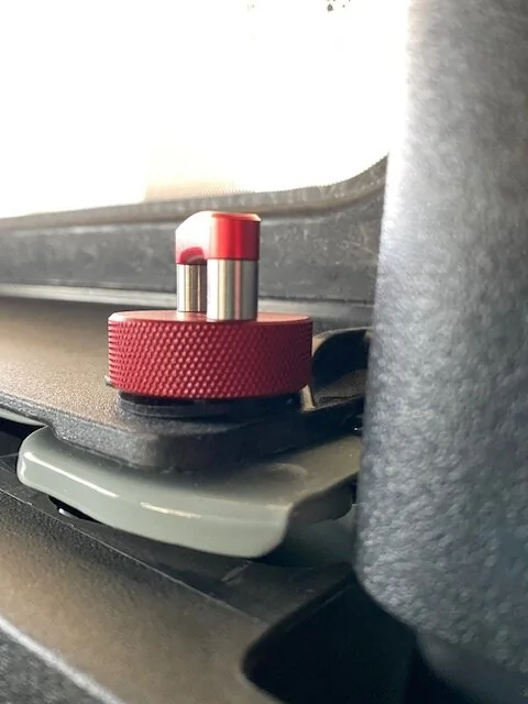

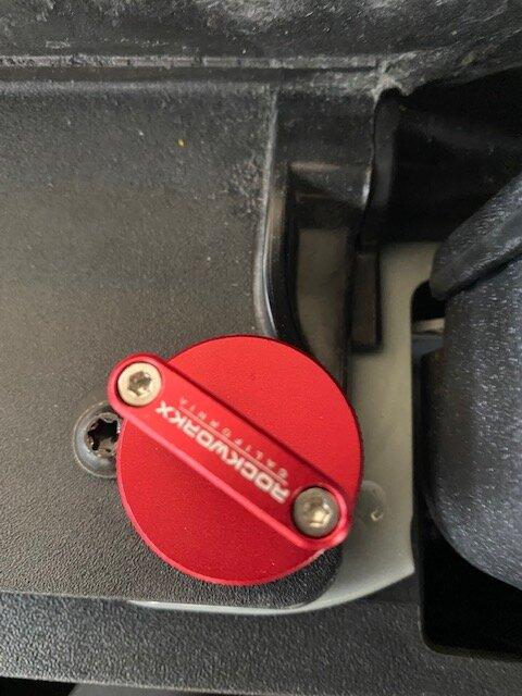

I received a set of these the other day. Impressed with the quality but there is a fitment issue with the 4th mounting hole, closest to the seats (4 door). Part of the hardtop molding interferes with the knurled flange, preventing the bolt from sitting flush and tight. I have a 2nd gen hardtop and can't tell if it is different from the original - curious if anyone else has encountered the same issue.

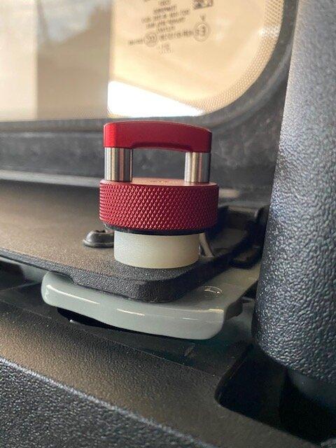

My solution was a nylon spacer that raises the fastener enough to clear the molding.
Ford Bronco Rockworkx hard top bolts installed. Removable by hand IMG_7064
Thanks for sharing the pics! This is only happening in one location, correct? I think the spacer is a great idea, I think we can add something similar. We will have to track down a Gen to the hard top to test. Thanks again!
Correct. It's only the most forward screws, on both sides.
