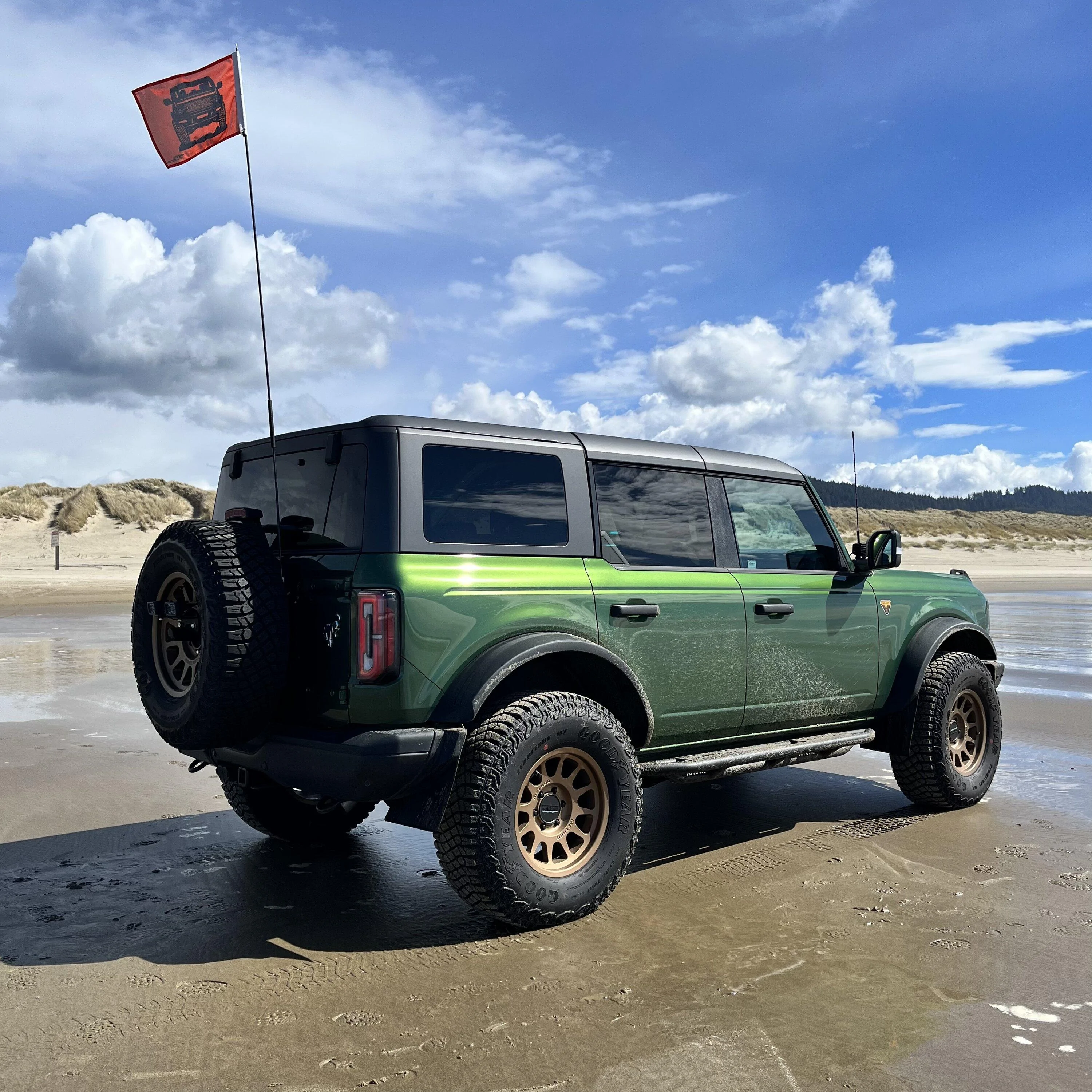

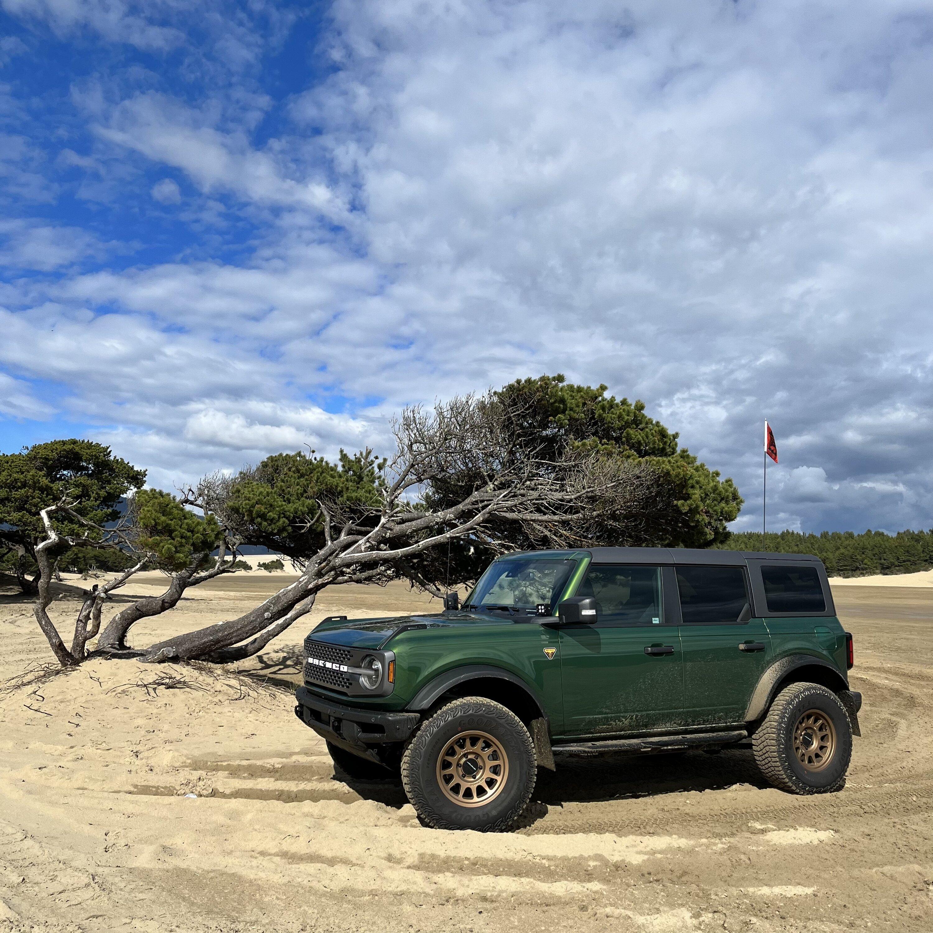

I recently went to Sand Lake, Oregon on the coast. My first time taking the Bronco.
Here's what I took:
Recovery Boards
Fire extinguisher
Flag
(the last two are required in this park)
Here's what I actually used... the flag.
I aired down to about 30psi as I didn't have an air compressor (I've since ordered one).
I didn't explore too far into the soft sand because I was by myself. But everywhere else was fine. At no point did the Bronco ever feel like it was going to get stuck. No matter the drive mode.
I aired back up at a nearby tire center and then washed the rig when I got home. I sprayed extensively underneath. There was a noticeable pile of sand under the Bronco after the bath.
Because at the beach the sand tends to be moist there is very little chance of a Bronco getting stuck. After a few minutes you'll get use to it and start to enjoy being there instead of worrying about getting stuck.

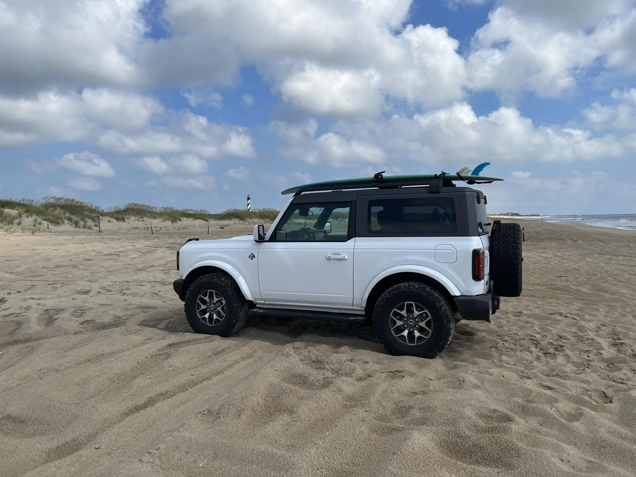

Go ahead and air down, doesn’t hurt and it’s easier on your drivetrain/engine. Turn off the Traction control. I do a good deal of beach driving on the OBX, even in that nasty stuff ( Hatteras Island) the sand mode is overkill. I put it in 4H and use the paddle shifter to find the best gear for the situation. Up on the Northern OBX I can actually run in 2H a lot, which helps because it’s about 15 miles up the beach to our shack in Carova Beach. They only truck that has done better on the beach than this one is my box stock 77, that thing floats
Ford Bronco Sand Driving and Aftercare for beginner 7D1D08D1-05F6-4F88-95E1-1453EF52182A
Rinse off the undercarriage when you’re done. Don’t think that driving through puddle will do it for you. The locals on Hatteras Island have a saying “it’s salt water, dumb ass!”

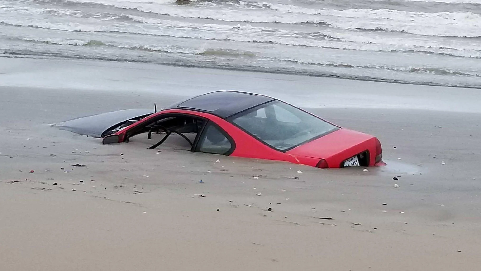

Good call out. I wasn’t ever in any danger as you can tell from the width of the beach.
There was one year on Padre Island the tide brought in a ton of seaweed that piled up at the edge of the surf. High tide would come in and the seaweed would get buried by the sand but leave a squishy cavity underneath. Low tide, the sand would dry up, and it was just as smooth and indistinguishable as everywhere else. It was impossible to see where these pockets were and a lot of locals who had been going up and down the beach to fish for years would sink to the framerails on vehicles that did great in the sand otherwise, and most of them were close enough to be submerged at high tide. It was like playing minesweeper with a truck. Only way to safely traverse the beach was to stay high up by the dunes where the seaweed never got buried. I travelled the entire 70 miles of beach pulling people out that weekend before the park issued a warning about it. I doubt stuff like that happens very often on any beach, but it sucks when it does.
