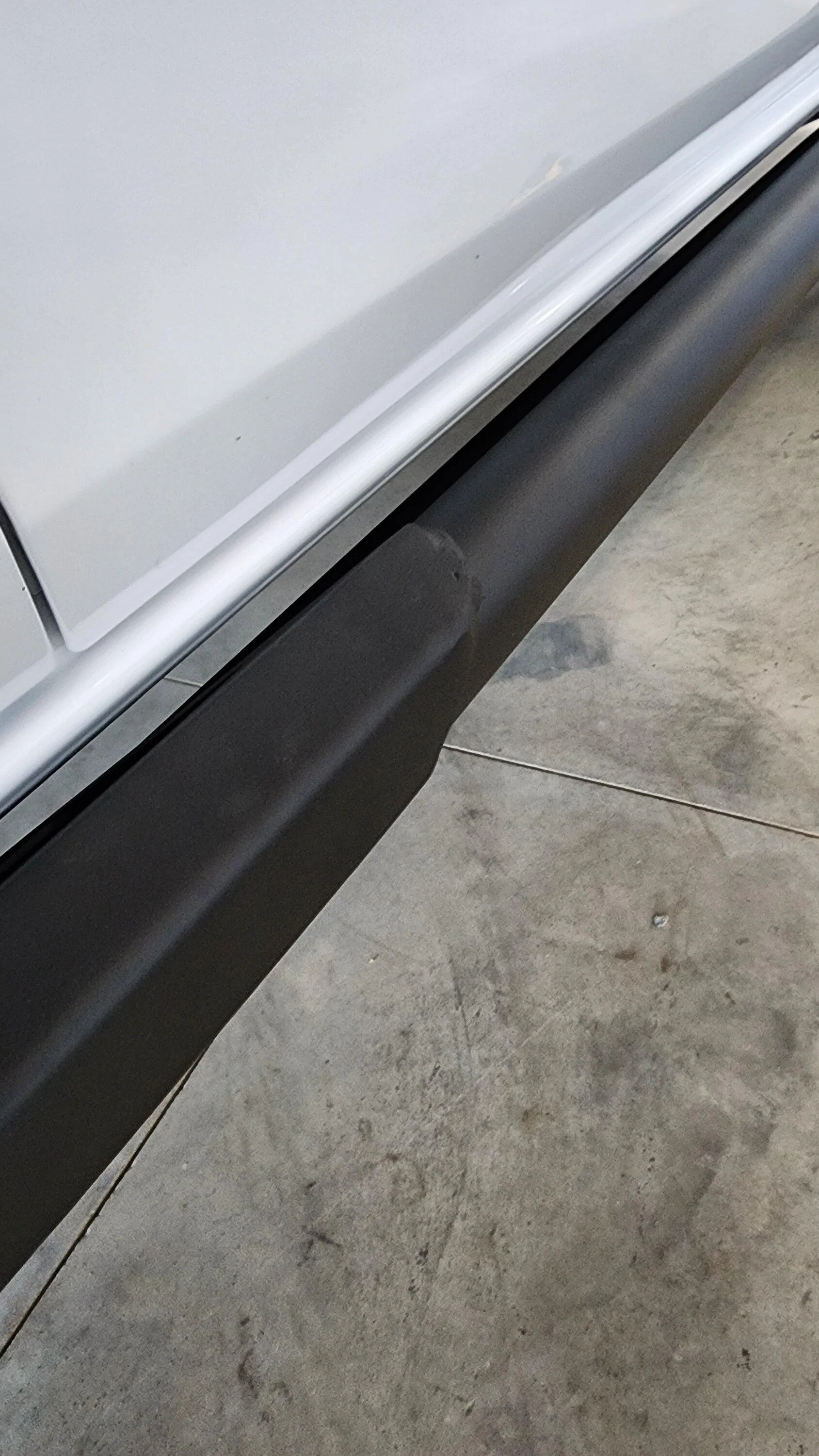

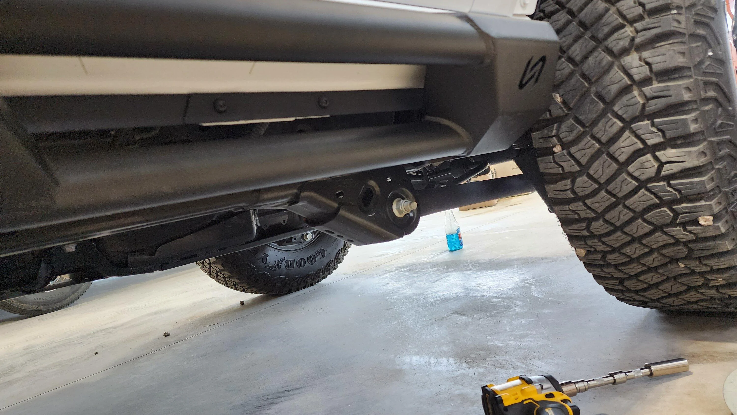

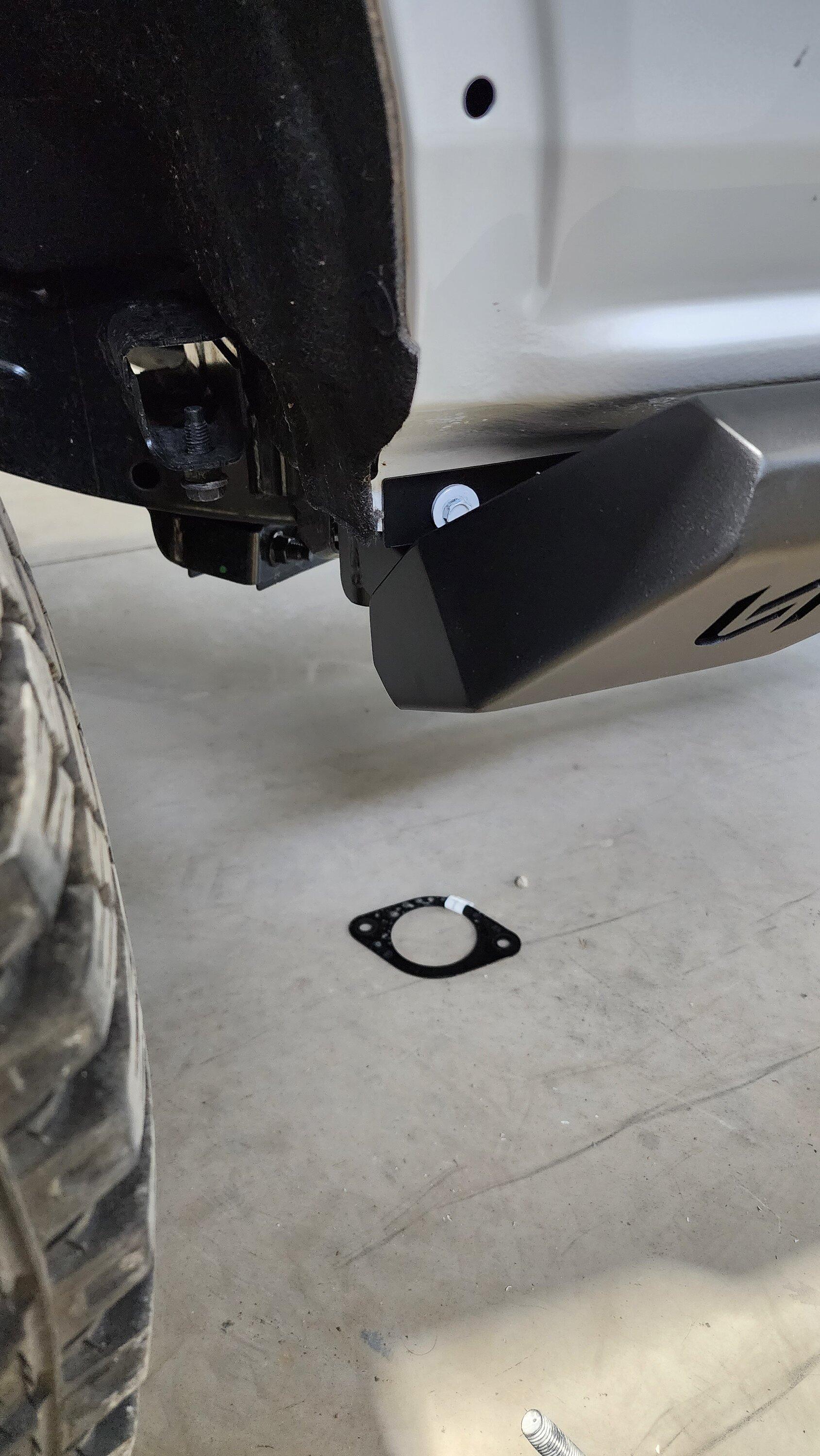

OK Everyone sorry for the delay but I did get them installed today.
Installation was a breeze, maybe took 30 to 40 minutes even with doing a little trimming on the rear fender plastic piece. Each slider weighs about 20 pounds. The metal isn't the thickest so there is a little concern there. They don't stick out very far from the side of the Bronco which is nice and what I wanted. You do lose a little ground clearance compared to my Jeep sliders but they are still above the frame. All in all I am very happy with them and very pleased with Turn's customer service.

Looks great! Thanks for posting your feedback!

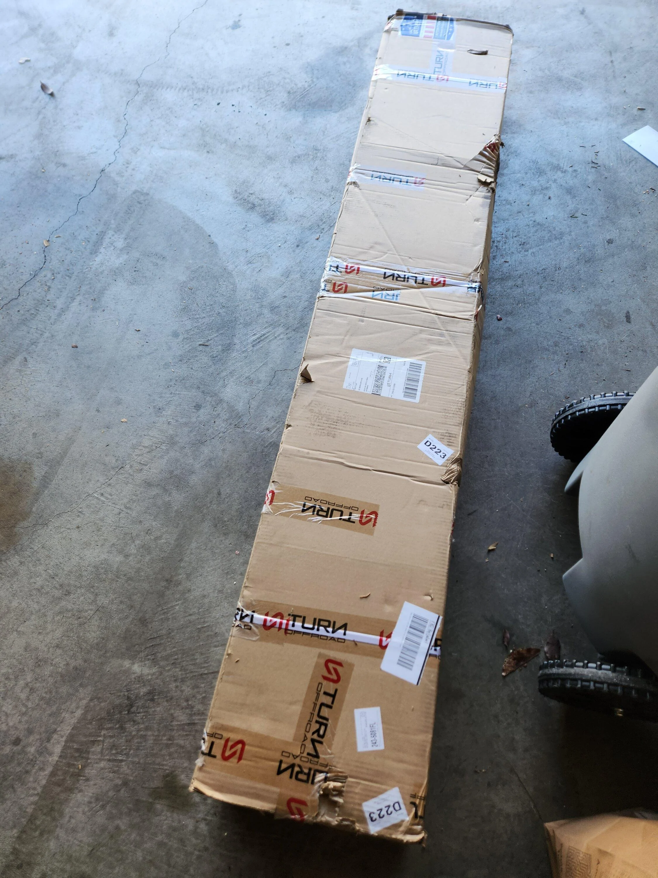

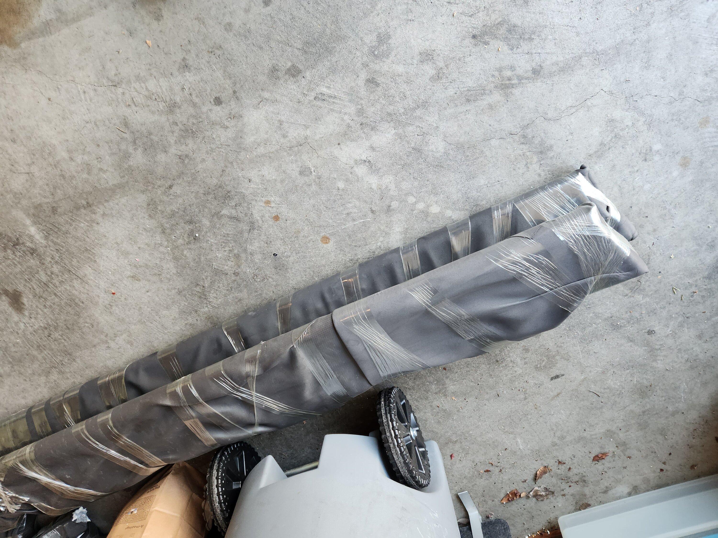

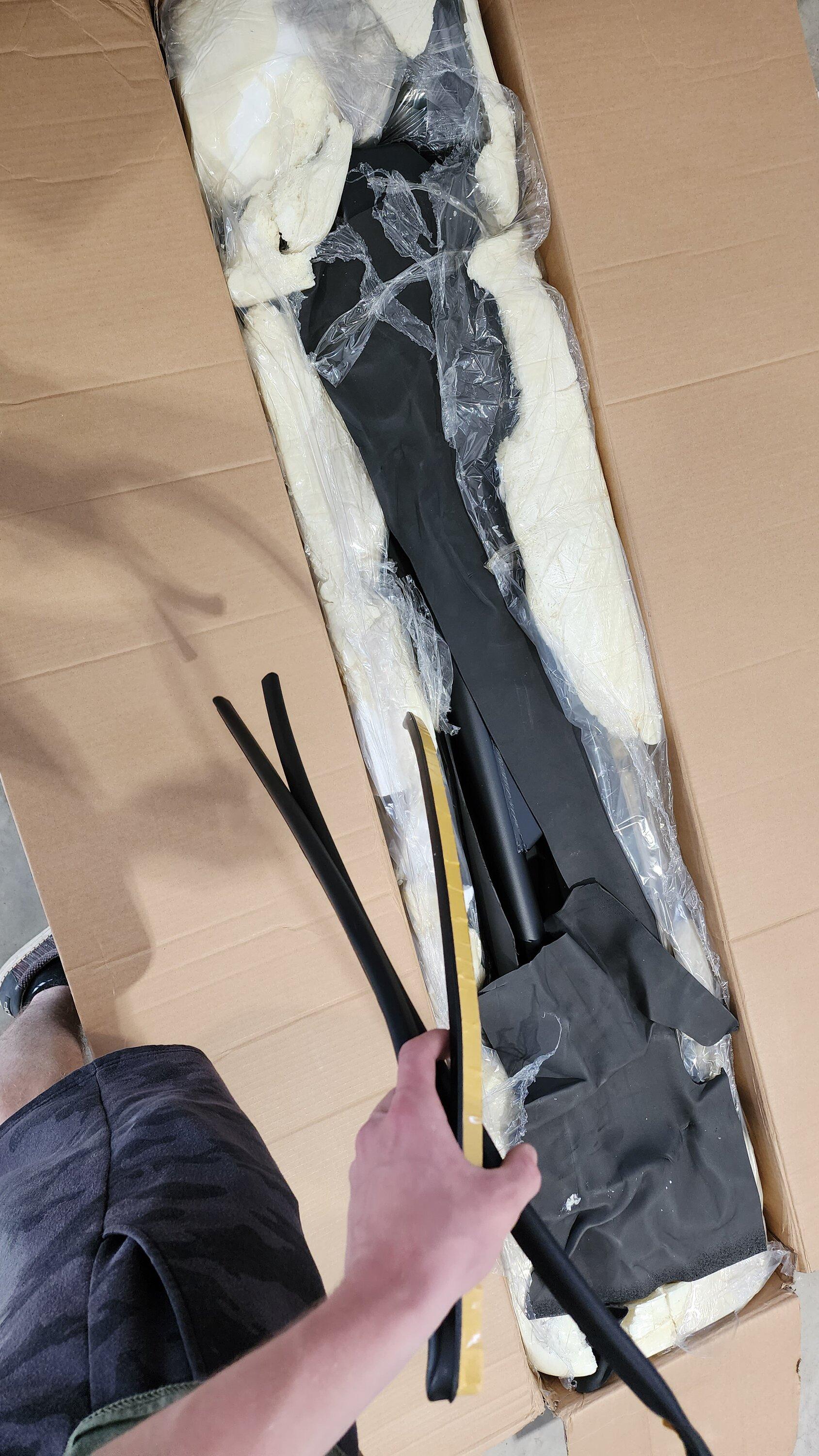

FYI...Long post with photos.
I believe some folks here were looking for feedback/info on the step/slider combo, or as @Turn Offroad calls them, The Stider. Ordered a set for my 4dr Badlands with Sasquatch. Shipping was super quick since Turn is in SoCal and I am in NorCal. Packaging was pretty good, despite what the FedEx gorillas did. Really thick cardboard and contents are wrapped in this spongy, thick padding.
Ford Bronco Turn Off-road sliders - reviews / feedback? 20230802_123256
Ford Bronco Turn Off-road sliders - reviews / feedback? 20230802_123901
After unwrapping, nothing was damaged other than two small scratches to one of the brackets, which a little rustoleum fixed.

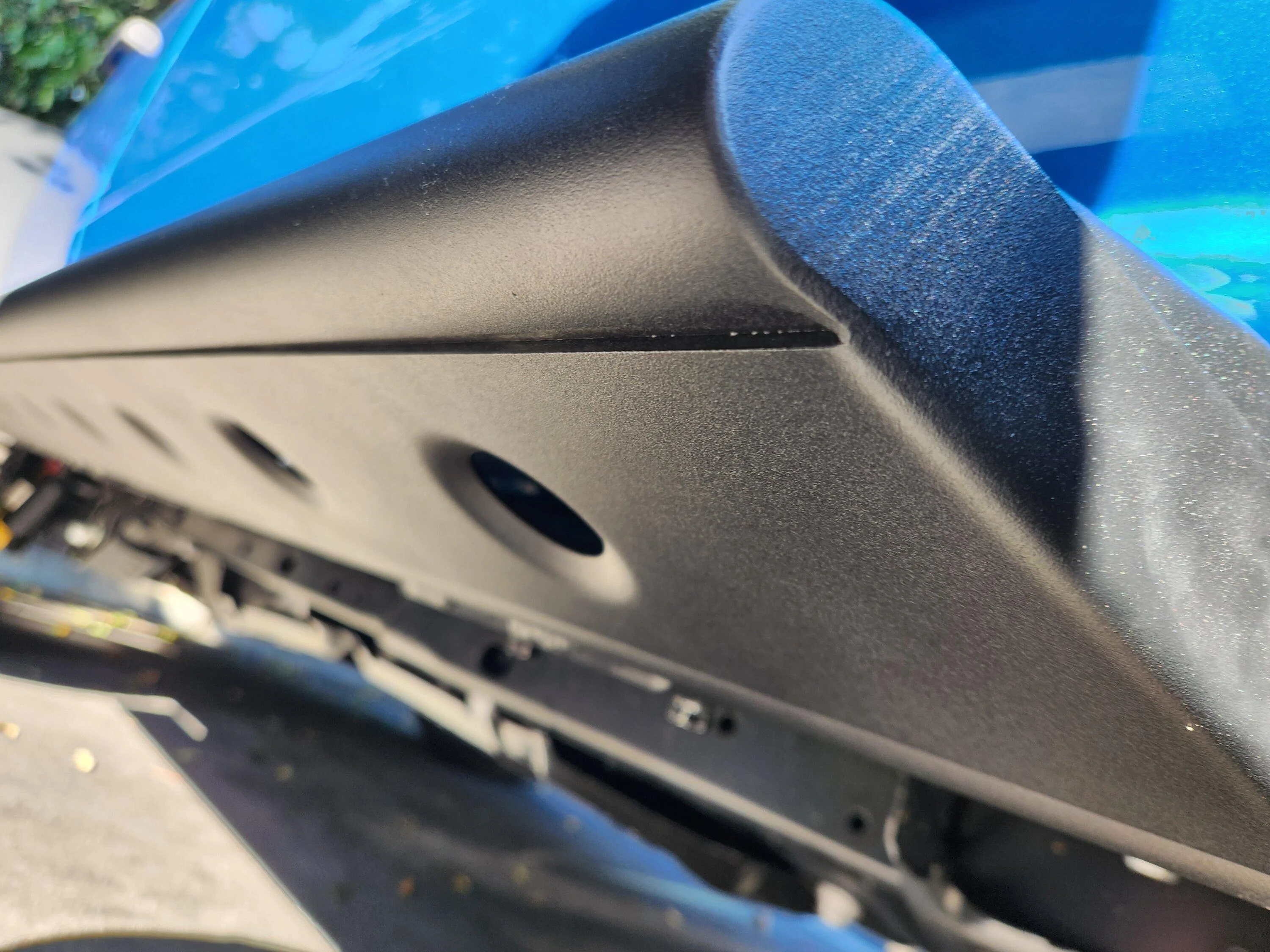

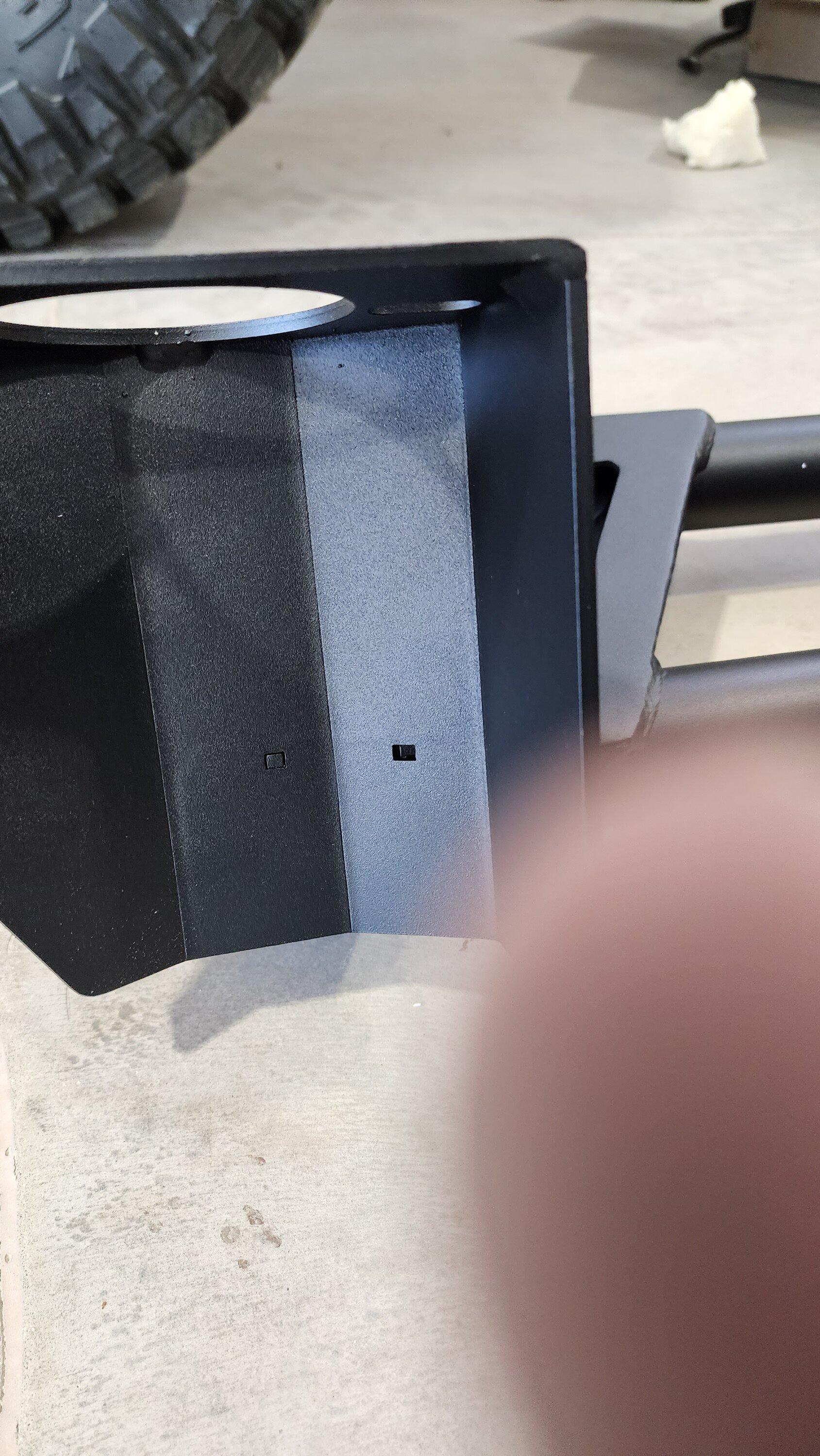

First impressions are that these 'Stiders' are beefy....really thick...built like a tank. I wondered how much heavier they are compared to the OEM rock sliders that come with a Badlands. Answer: a lot heavier! OEM slider is ~26.5 pounds each. Each of Turn's Stider is ~56lbs (weighed on a bathroom scale).
The brackets are also heavy duty. Double the thickness of the factory brackets. Bottom line is that the 'Stider' and its brackets inspire confidence.

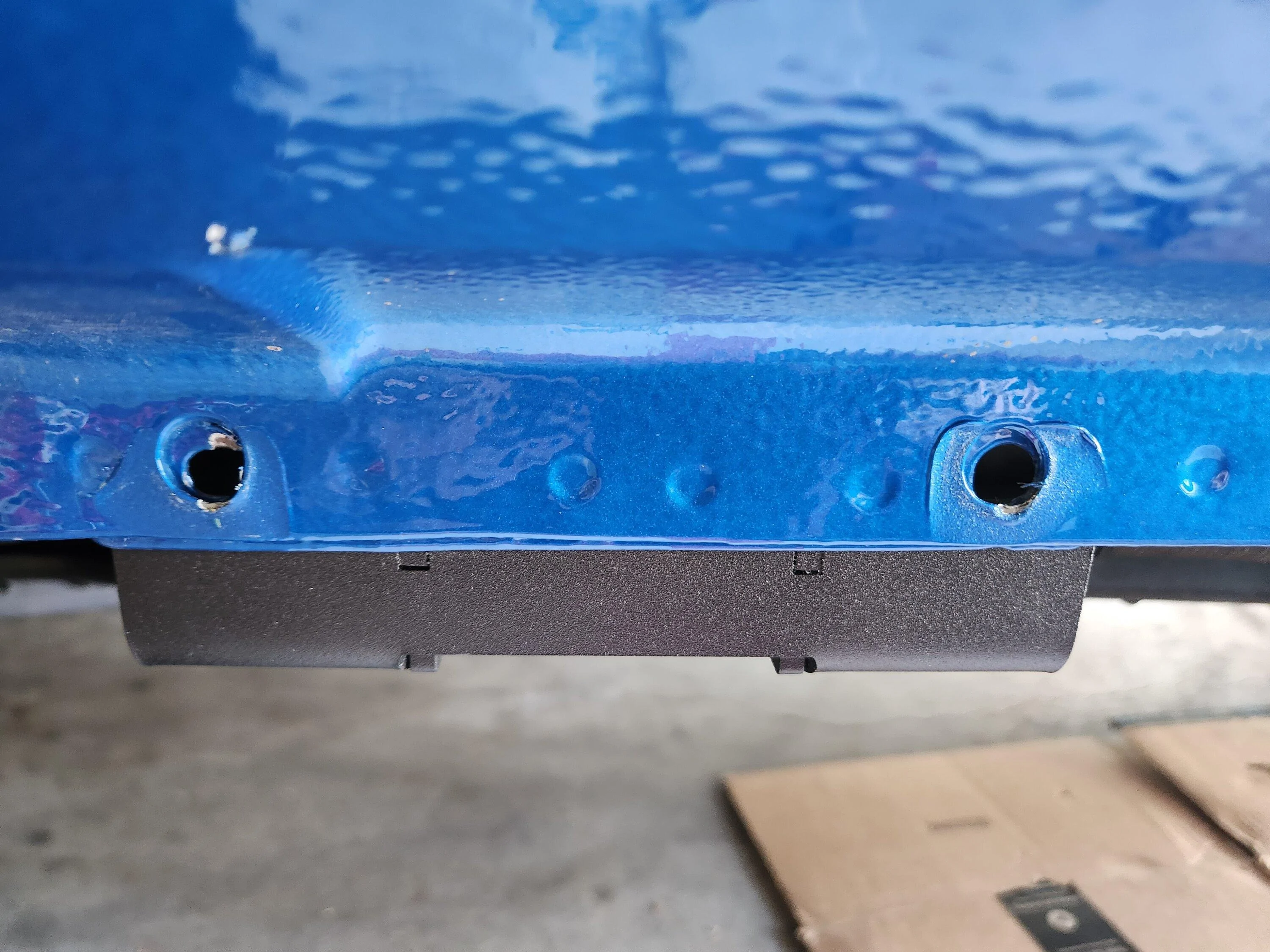

While the box does not come with instructions, once you lay out the contents and take a look, it is really super obvious where things go. One area that might take a little trial and error is the bracket mounting. One of the brackets is uniquely shaped and only goes in one spot. The other two are very, very similar looking but when installed only fit and align with the pinch weld mounting holes.
Ford Bronco Turn Off-road sliders - reviews / feedback? 20230804_145421
BTW. That paint flaking near the pinch weld holes is a sign of soft paint. Look at the impressions the old slider left in the paint. Seems like FoMoCo needs to adjust the curing lamps. Anyway, this area is 100% covered by the Stider, once installed.
During the installation, I noticed things did not line up. Reason was that the top step plate was not assembled to the right Stider base....the left plate was on the right Stider and vice-versa. @Turn Offroad please contact your manufacturer and have them add a QA step when putting these together.
Anyway, the step plate can be removed and re-attached, so only thing lost is time. Again, easy to do but if you have sausage fingers, it might take some time, as some of the backing nuts are in a tight spot.

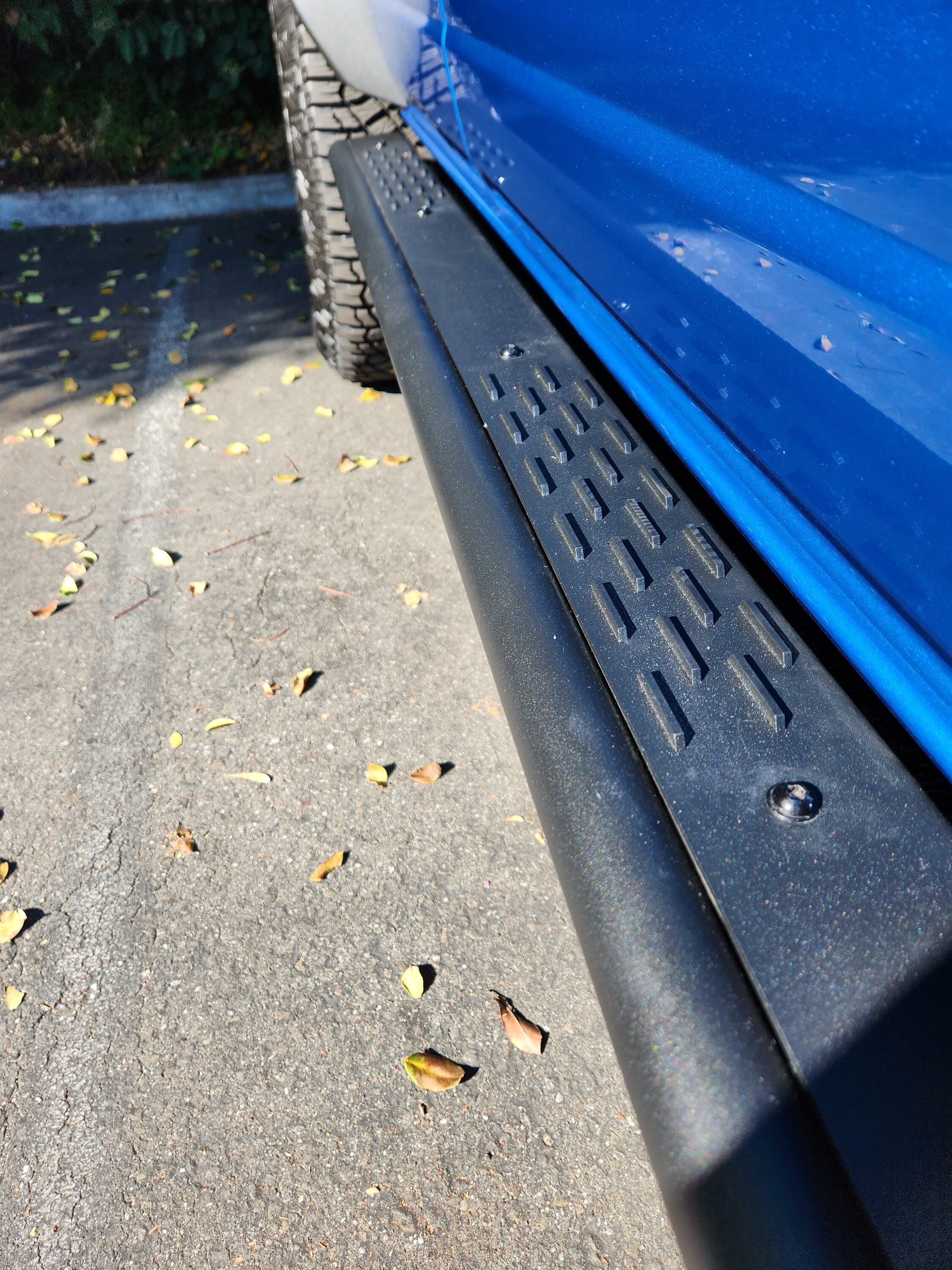

Installing the brackets is easy. The Stider's are heavy and will go on easier if you have two people doing or use jack stands to support the weight. They are, after all, heavy and beefy.

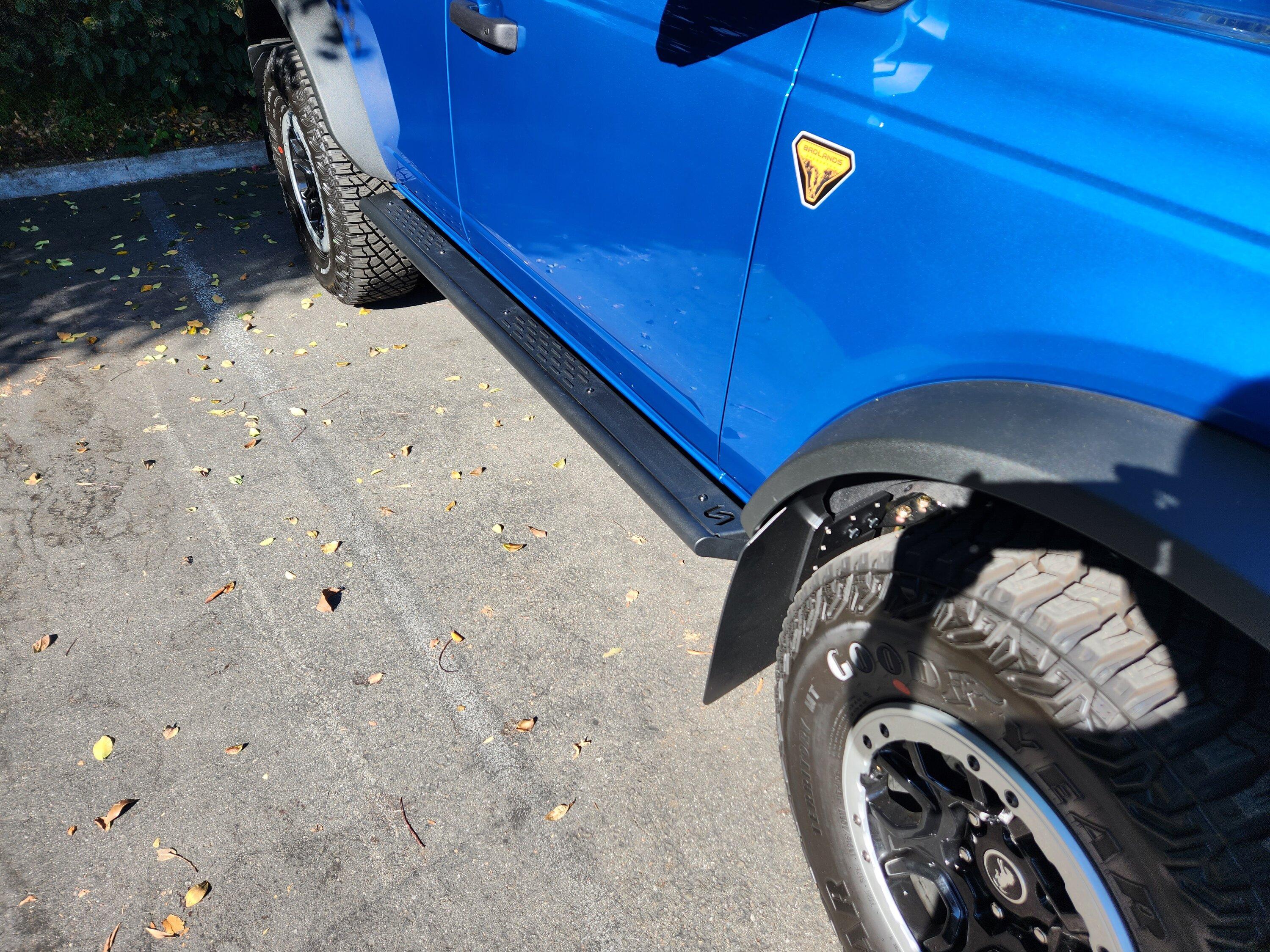

Once installed, they look nice. They stick out enough and should protect from door dings. They also offer a nice foothold for those folks who are vertically challenged, like my wife who found these perfect. Lastly, they will provide some protection from rocks flung by the tires.
Ford Bronco Turn Off-road sliders - reviews / feedback? 20230804_171333
Ford Bronco Turn Off-road sliders - reviews / feedback? 20230804_171313
Ford Bronco Turn Off-road sliders - reviews / feedback? 20230804_171342
Ford Bronco Turn Off-road sliders - reviews / feedback? 20230804_171352
All in all, happy with these Stiders. Prior to installing them, my OEM sliders provided roughly 17.25 inches of clearance from my garage floor to the slider bracket. After installing the Stider, I measure around 16.75in of clearance, so only lost about half inch, so not bad.
Also, the video mentions the need to remove that plastic molding piece. I think that piece is only used on non-Sasquatch vehicles, as mine did not have it. Lastly, these do not interfere at all with my Rokblokz XL flaps, so between the two of those, I should be fine driving the crappy highways up here in the Bay Area.

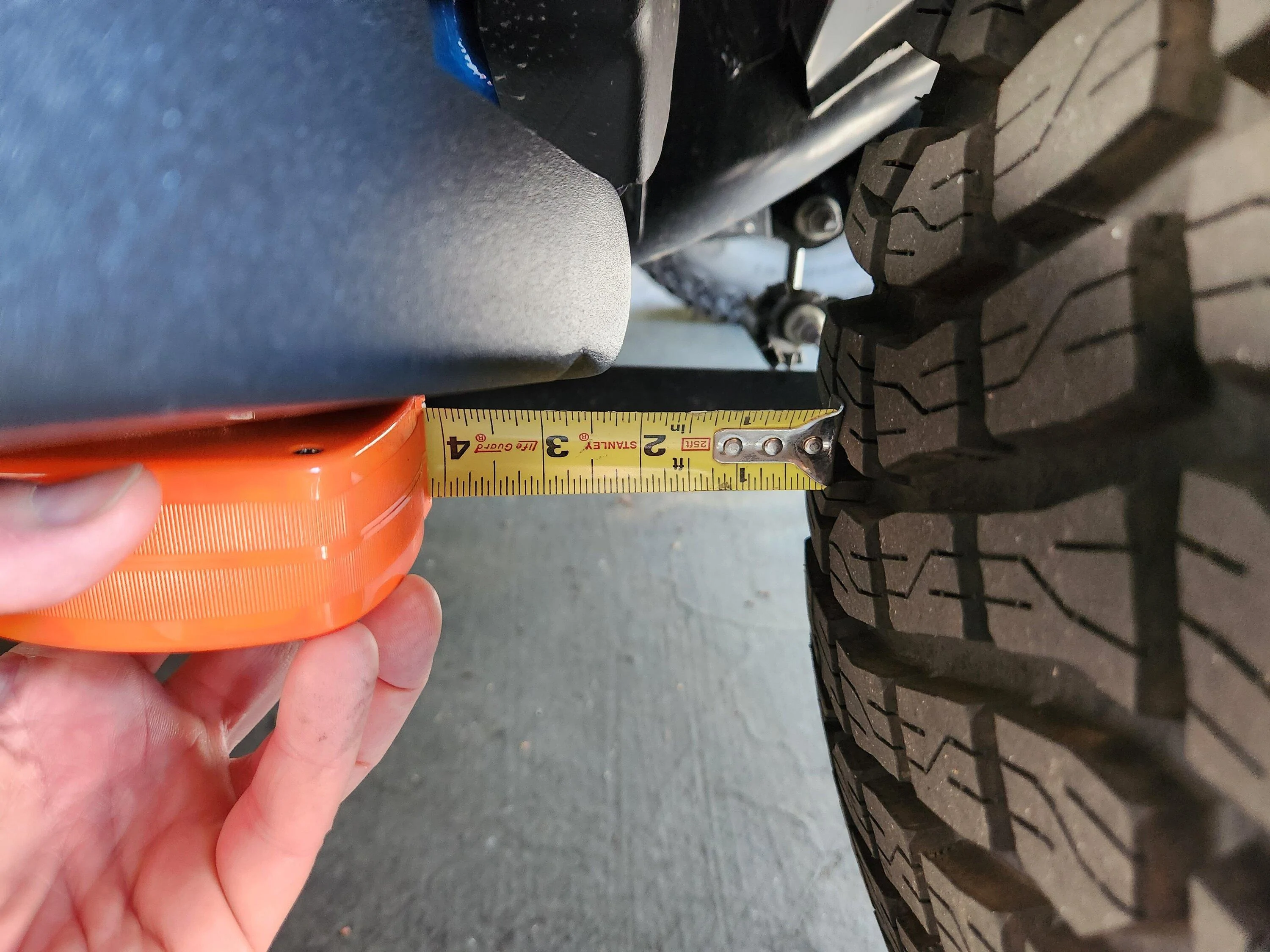

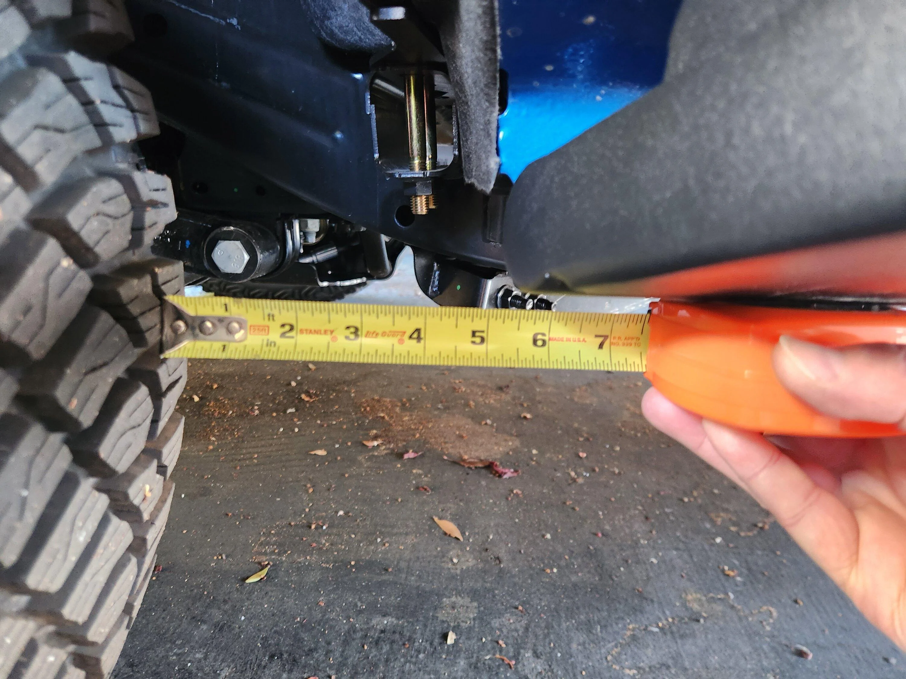

@dvogel can you get a few pictures of the front of the slider showing how much clearance? Like a nice side shot? I want to see if there is enough clearance for 37s?
[/QH
Here you go. Hope this helps.
With flap installed:
Ford Bronco Turn Off-road sliders - reviews / feedback? 20230806_151909
Removed the flap and measured to the leading corner of The Stider (~5in):
Ford Bronco Turn Off-road sliders - reviews / feedback? 20230806_151544
The rear is closer:
Ford Bronco Turn Off-road sliders - reviews / feedback? 20230806_151654
