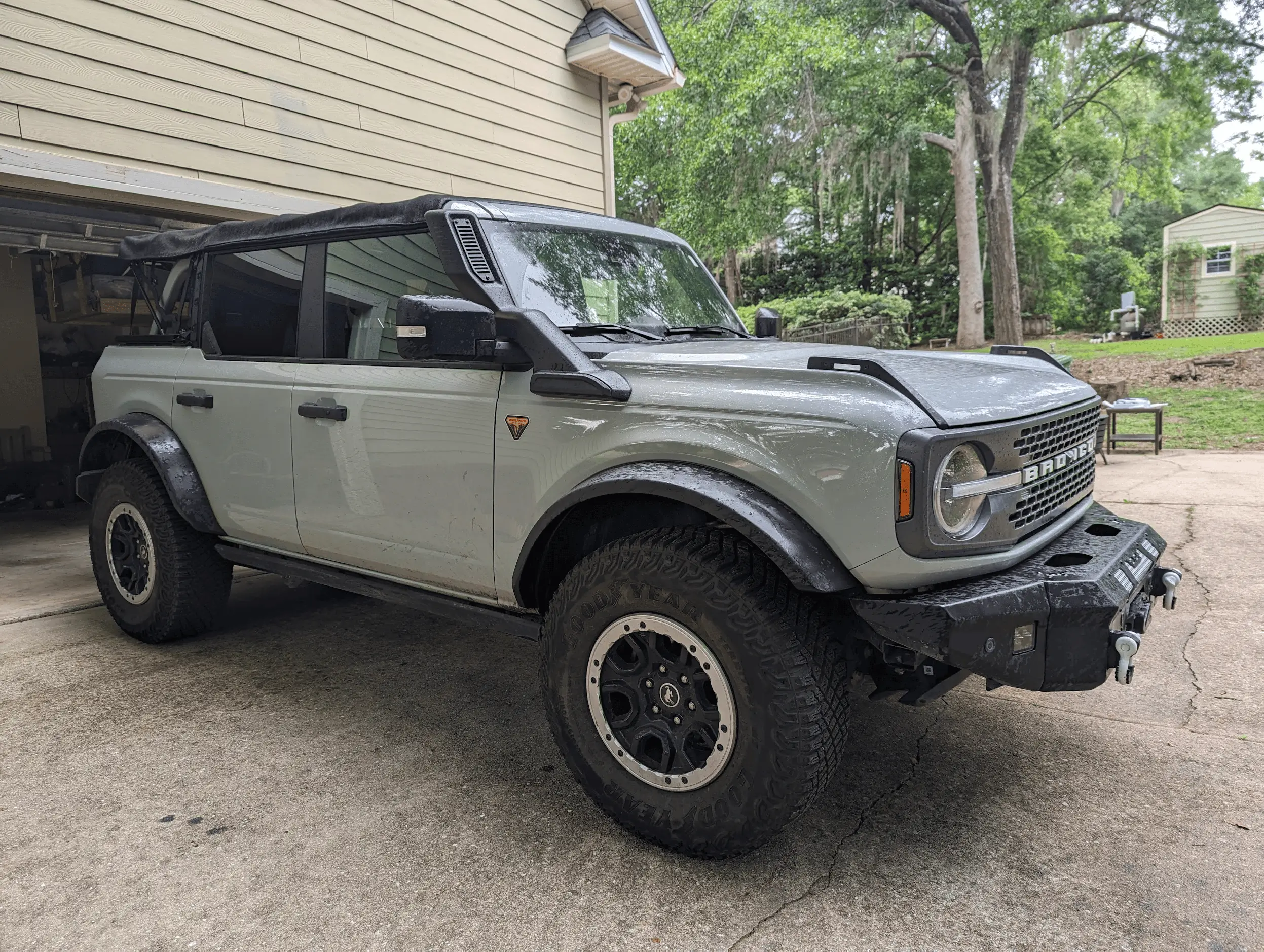

Got the snorkel installed on my Badlands today and then immediately had my first ever Everglades sighting. Wild coincidence. In any case, I wanted to pop in here and say thank you so much for y'all's help and encouragement. 😄

Awesome! Lookin All-Pro! Any issues? Is your water bottle zip-tied in?

@friethmiller Well I am wondering about the seal between that cover piece and the snorkel body that is against the fender there. That little cover piece just snaps on there and doesn't seem to seal well on its own. I'm tempted to use some black RTV silicone to help close it. What's that like on yours?
Annnnd the water bottle is just sitting in a chair in my garage for now. LOL. The shop just removed it and left it for me to deal with, which.... I was surprised by but also didn't care. I can have that as my own project to figure out, since it is low impact. I'll buy a squeegee for now.

Looks great, Paul. Well done...
